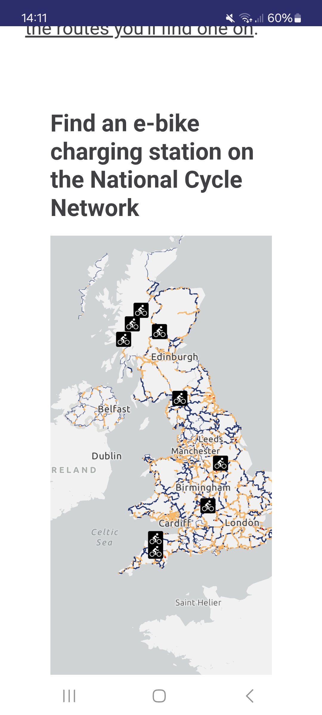

Looking at Sustrans Ebike charging map of UK . Long cycle between them. Going to Skye September yet again, can't charge where I'm staying at forbidden. Just thinking we're not moving forward or if we are it's not advertised
