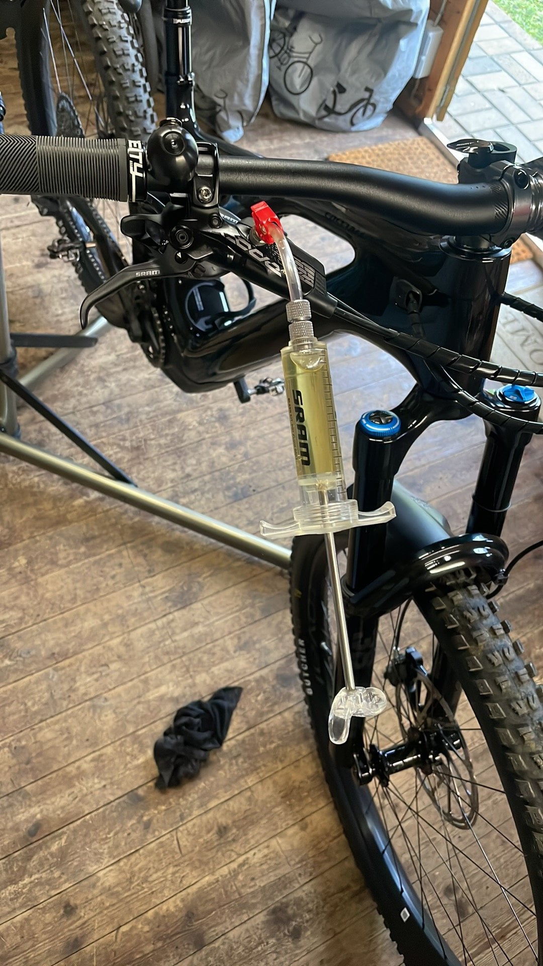

You also have air and too much fluid in the lever syringe. The fluid should be soild from the syringe through to the flex tube.

the picture is after my first try to bleed it. And did the last step in the procedure where you push and pull on the siringe to get the last air out of the system i have tried 2 more times after this but it does not get better…

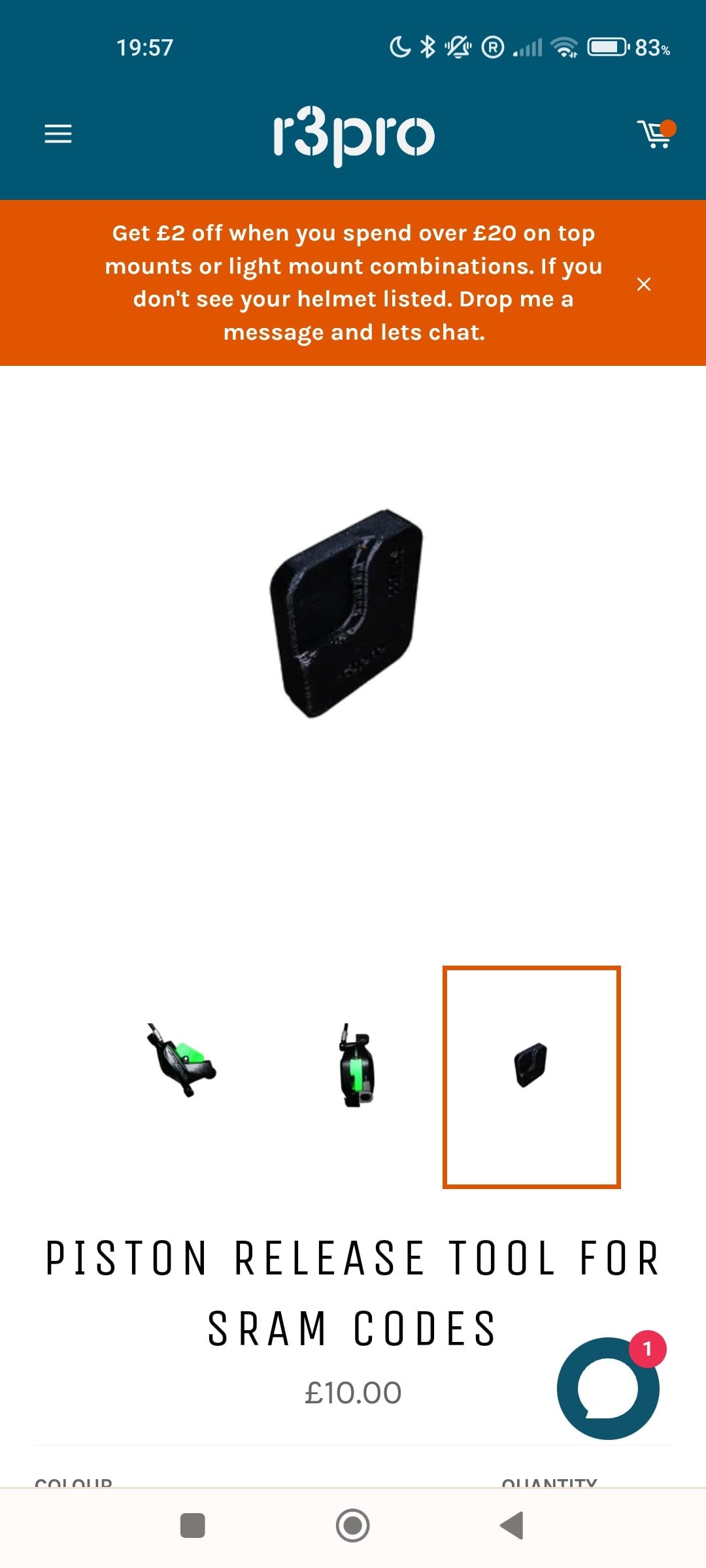

I use one of these tools to bleed and clean my pistons , you can pump out 1 piston at a time, works really well for a 3D printed bit of plastic 🤟
...same...been using one for a couple of years now so cleaning and lubing the pistons on the rear calliper is part of my routine everytime I do a mini service.
