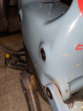

I then noticed, after re-torquing, the left side rear bolt looks like it's sunk way too far into the frame:
I wonder is the carbon compressing, causing the bolts to be loose, causing the creak sound? I also found the inner spacer was missing on my chain guide :mad: I can't say for sure if the LBS forgot it or I did, but it means the aluminum part of the chain guide was smashed against the frame... EDIT: my bad, there's no spacer on the carbon frame, only aluminum (see here). So it appears this bolt might be sinking in as well, it made some pretty terrible noises when torquing.
Can anyone compare their left rear bolt to mine? Maybe it's missing a spacer or something? Thanks.

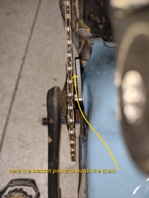

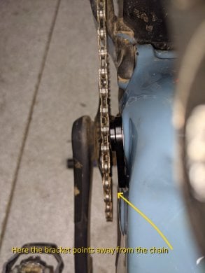

Something else I noticed while trying to get the chain guide lined up. The bolt seems to be going in at an angle?

Follow-up:
Took the bike to LBS, who contacted Specialized. They said they had a tolerance issue with some of the new motor mounts, and that we should check there. Turns out the left rear mount was no good, causing the bolt to sink in. That's been resolved with new mounts.
I compared the chain guide bolt to a new bike in the shop, and the new bike appears to have a similar angle. I think mine might still be angled more than normal, but hard to say for sure. Either way it's definitely not square with the chainring when new.
?things are back to normal. I still need to figure out what I want to do about the chain guide; I may just put a 34t on so I can run it in its normal position (I have a 36t currently), or I may just leave it off altogether...
