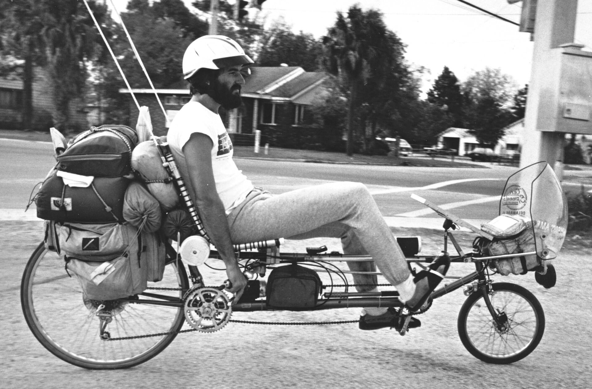

YES! Hopefully they will release a recumbent version with fairing & drop-bars- gotta get those KOMs!
