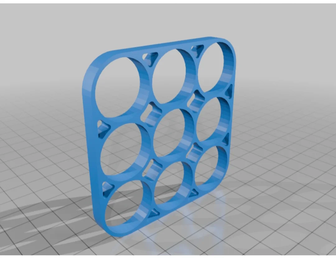

Hi. Did you build the battery in a 3D-printed enclosure or use a different approach? Can you share some photos and instructions?
There is no 3D print for the battery.
I used 3x1 2170 cell holders formed in 3x3 factor. All sandwiched in between 3mm fiberglass,top and bottom. And for the mount I used 5x25mm aluminium bar with floating threaded inserts. Aluminium bar was offseted to make a room for brake and shift cables on the left side of the battery.
Thanks
