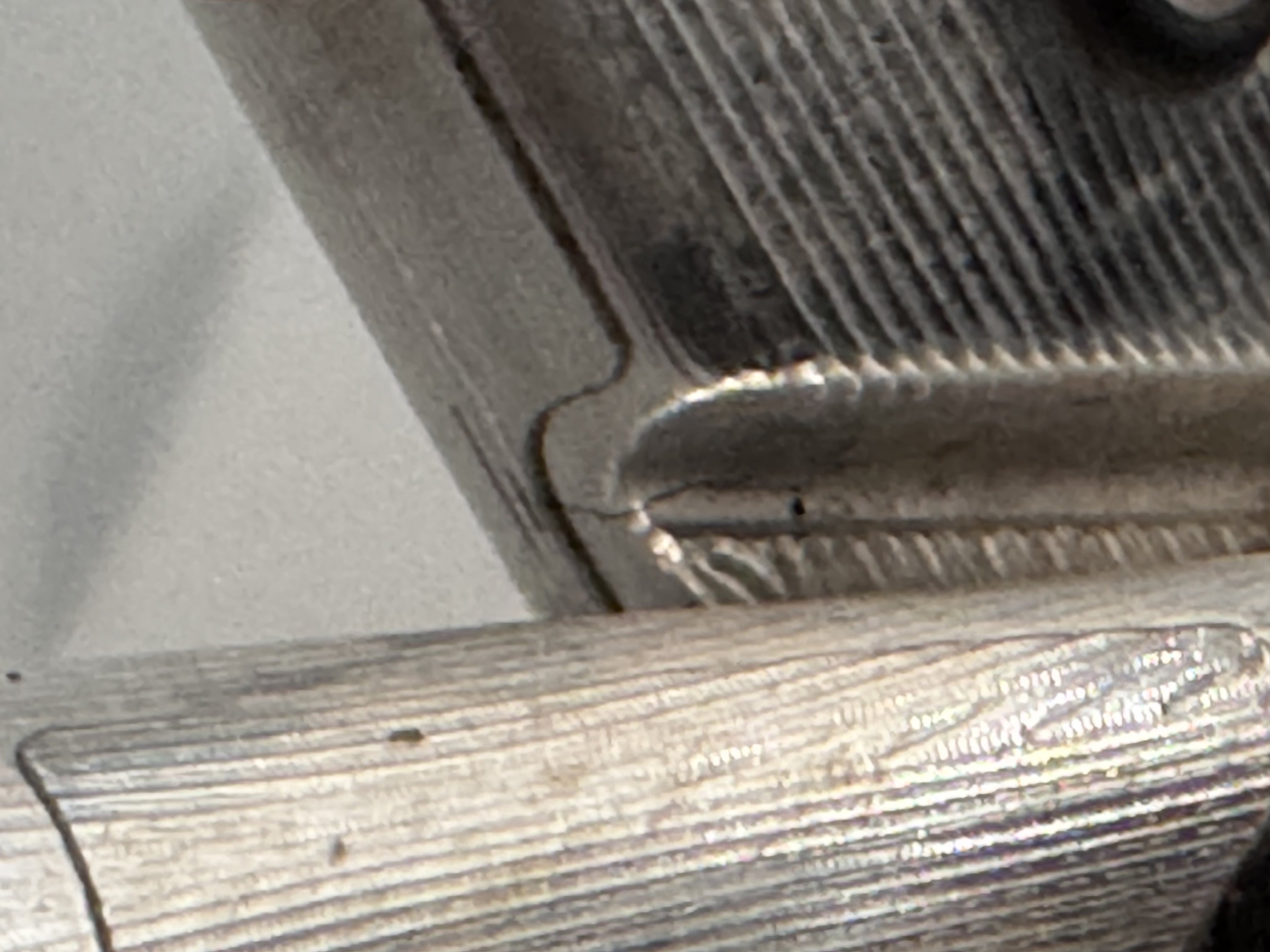

Mine has started to crack now.. god damnit..
I love the bike and have sent a mail through poles website thats back up and running. Hope they can sort me out and that they are back in business..
I dont dare to look. I went all out on this so really hope they can work out a solution with me somehow to keep me riding. I’m dependent on this bike to stay sane!

I found out recently mine was cracked, so I drilled the crack and repaired it with JB Weld, inside and out. Hopefully it’ll hold out until the new swingarms are available.

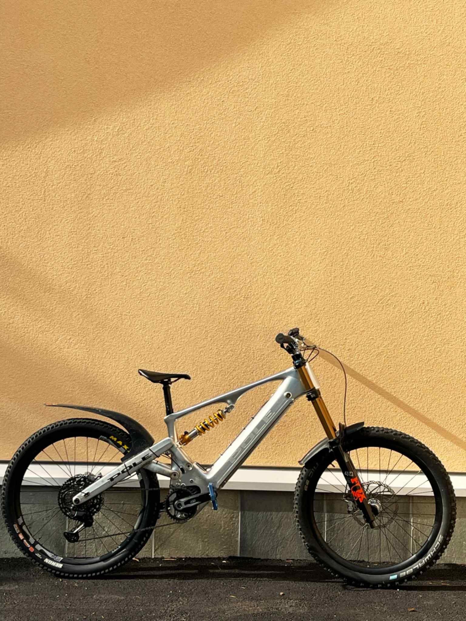

Still riding my Voima on original swingarms, and it is really, really a great bike. I use it with Öhlins TTX22M.2 250x75mm, and Fox 40 and 2.6 x 27.5 tires on carbon wheels with Shimano Linkglide 11 speed mechanical, 36t and 11-50t, 220mm Oneup V3 dropper and Hope Tech 4 V4 brakes.
