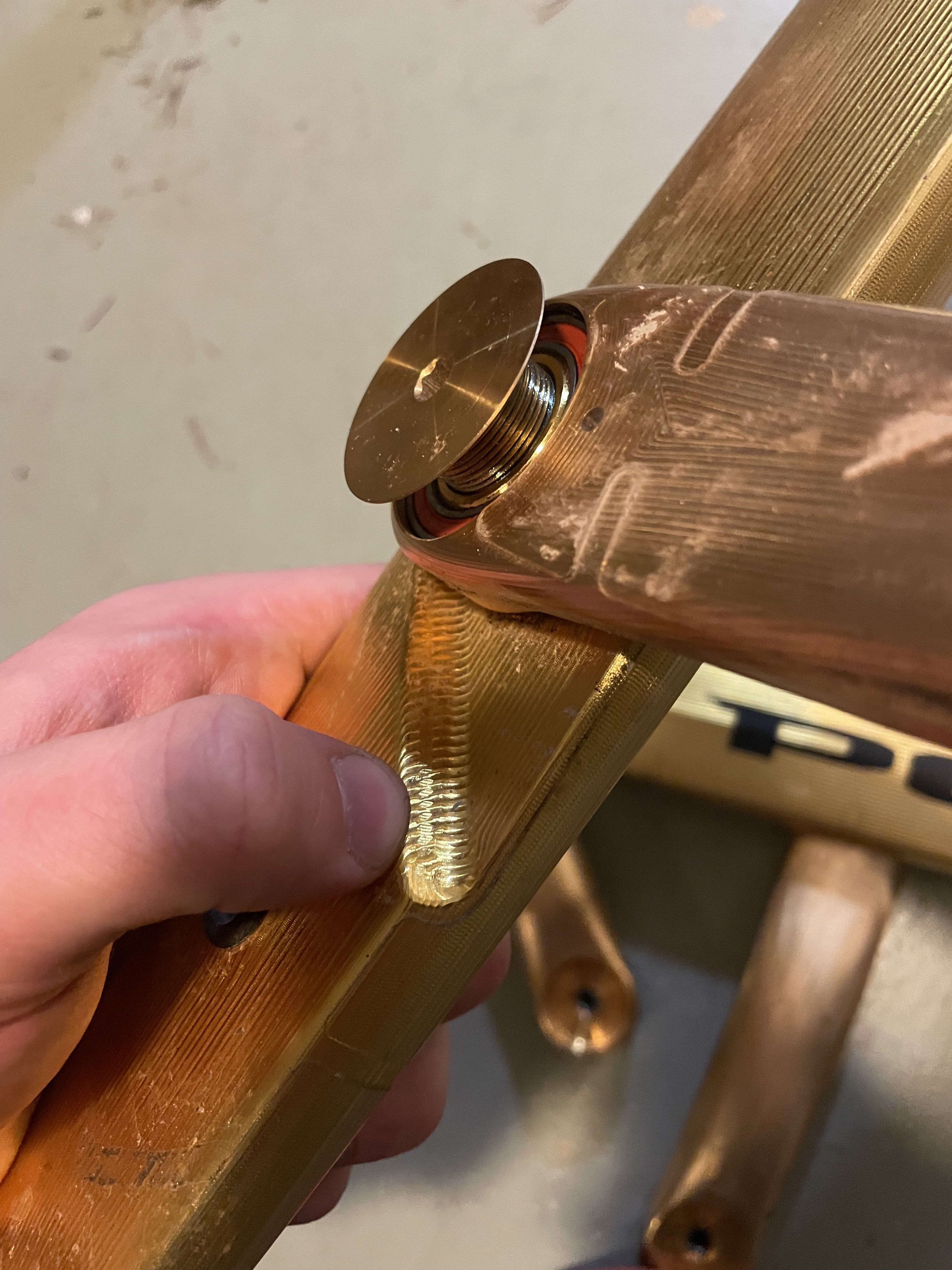

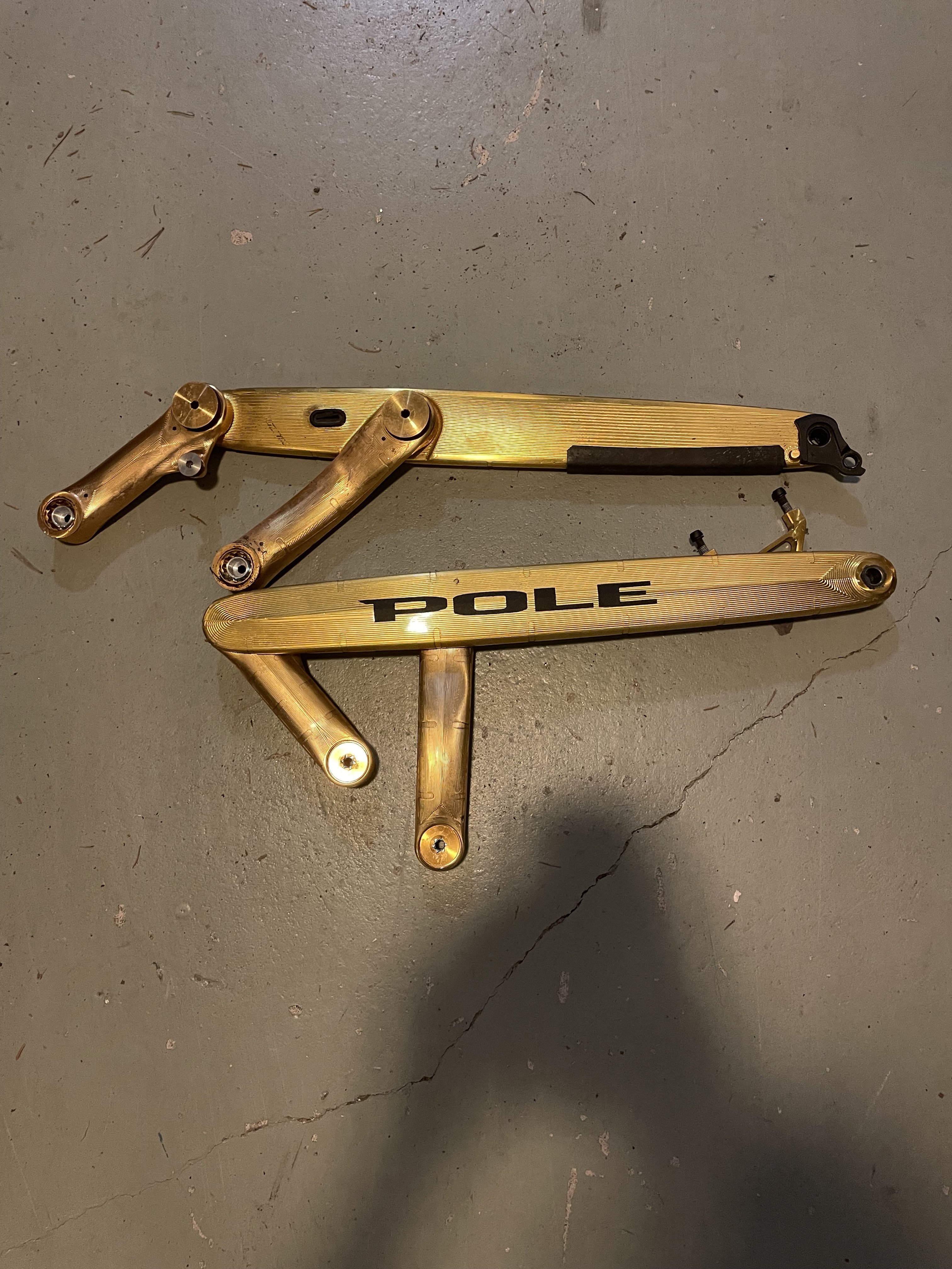

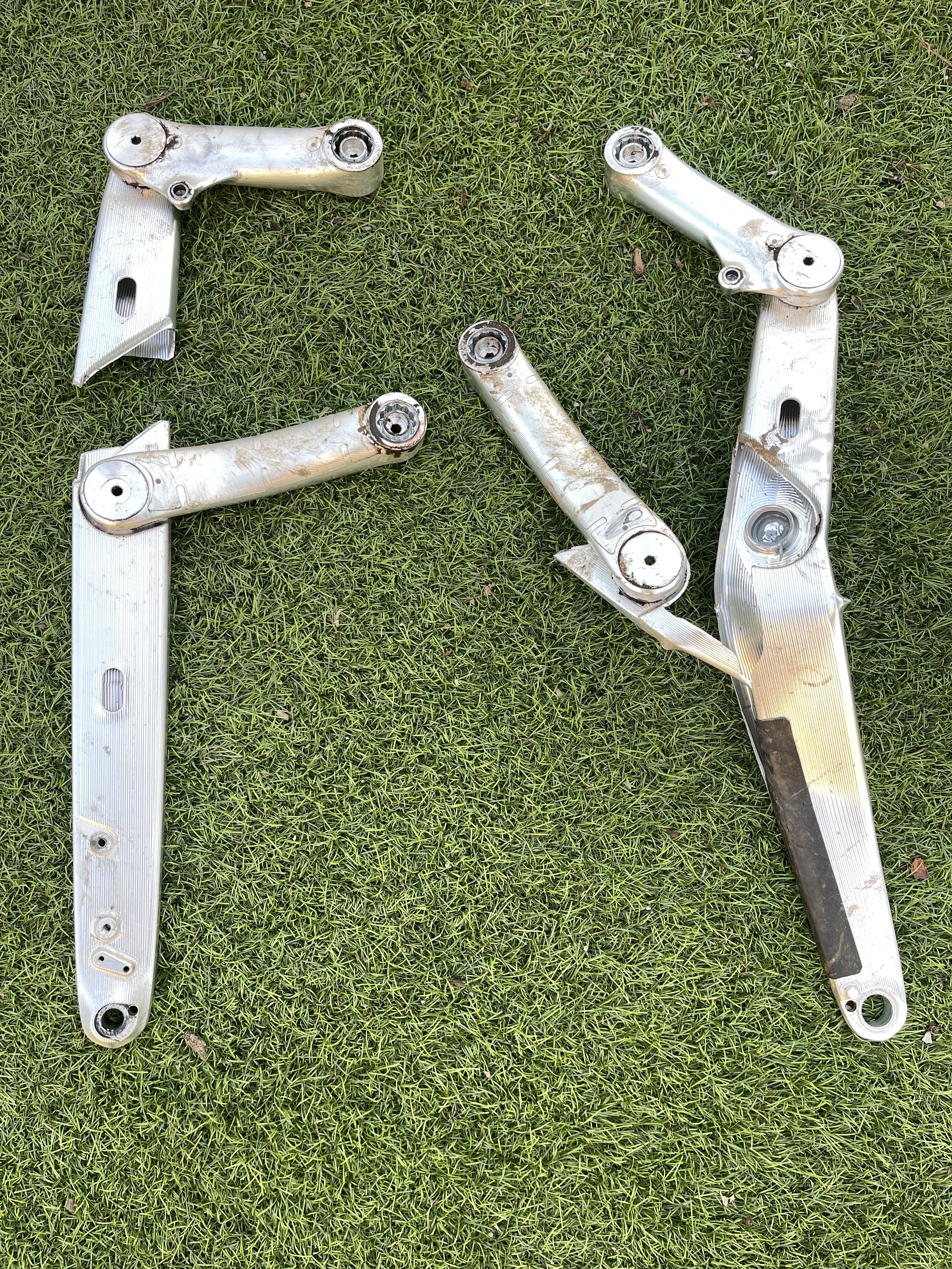

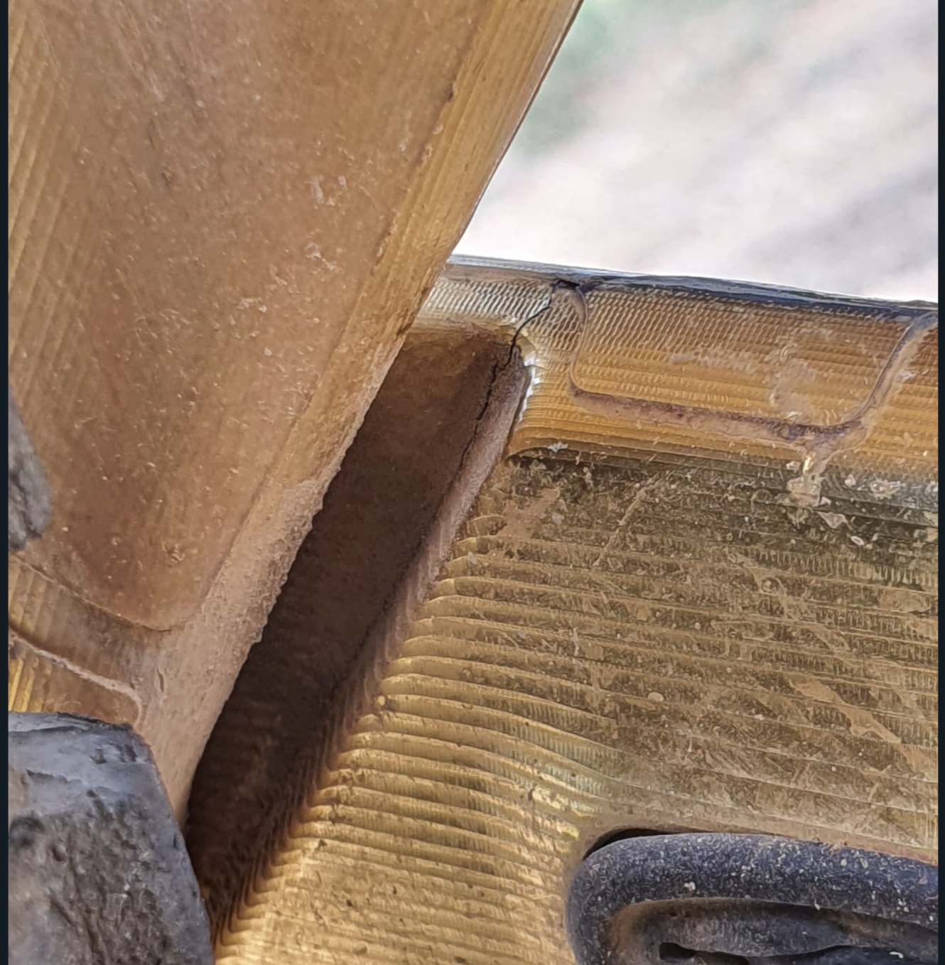

Pole Voima swing arm CRACKED
Both swingarms on my 2nd gen Voima crumpled landing a small jump but clearly there must have been cracks growing for a while. The rips in the failed swingarms started exactly where the problem spot is where the lower linkage bolts up.
Pole replaced swingarms and linkages just before they went under. Took about 3 months from warranty request to get the redesigned swingarms.
6’4” 235lbs. Guess you could say I’m hard on bikes as this is definitely not my first cracked frame.
Some POV video from our local to give an idea of what kind of riding led to the failure in case that’s helpful:

Oh that's better, I thought the broken bits were the new swingarm.

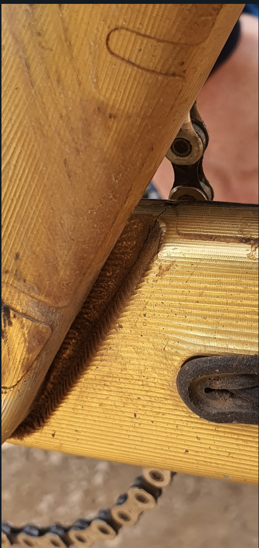

The worst of the omens has come true, the right swim arm of my Pole Voima V1 has cracked.
3980 km of enduro and pure pleasure that have come to an end.
Now what? I have tried to open a ticket to support but when you upload photos and files, upon completion, the website goes blank and I do not receive any confirmation email.
I am totally saddened, it is not even 2 years old and it is without a doubt the best bike I have had in my 25 years of riding in all forms.

Keep me posted if anyone breaks a left/non-drive side arm as I still have my original. Pole sent me a new set when my broke, but only wanted the broken one back.
Pretty sure that it's the non-drive side on mine that went (can't remember, and at work)- what would you want for your spare (which may crack the next day :-/ )?

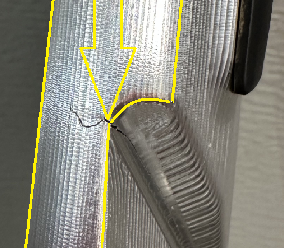

I will be conducting an experiment on my swingarms. It includes sanding down all the surfaces to smooth finish that are prone to cracking due to fatique and or the combination of heavy riding.
There are multiple sources on metallurgy that study the effects of surface finish to fatique strength. The studies would almost always correlate rougher surface finish to worsened fatique strength in alloys (7075 used in pole). Every crevice between the machining lines that are left during roughening with a ball-head mill leave possibilities for fatique microscopic cracking which then starts its journey to form a visible crack in the alloy. Reducing these stress concentration points in this high stress area most likely will reduce the amount of stress concentrations and give a longer fatique life to the alloy. One could argue that removing alloy from the surface would create a smaller section of the profile and thus lead to higher stress. This is not a thing that should be taken into account since the low points between the grooves are already that minimun cross sectional area and removing the high points of the machining marks would make the cross sections even with the low points. When designing the parts in CAD you make a cross section based on the model and the ball-mills end point will follow that profile leaving a minimun of that designed cross sectional area. All the high points are not considered in the CAD models but rather left from the machining process as additional material. More material in this and in many case does not correlate to higher capability to withstand forces but rather make it more vulnerable to cracking.
Enough said. Id like to hear your opinions too before i make anything permanent. Lets argue!
You are 100% correct. Sharp direction changes in a design create stress risers and points of additional load that can lead to failure. Sanding back the machining at the point of failure will not reduce the strength, it will increase it slightly, until you get to a point of starting to remove base material.
However, and its a big however. The stress riser that's killing swing arms is the sharp direction change from thinner width section to the thicker width section. As you can see with this broken swing arm (not mine) the crack propagated from the radius point where minimal machining marks exist.
You cannot sand away this design flaw. I expect the result of sanding to smooth will be negligible. If it is going to fail there with the loads you are apply it will do so whether you sand it or not. Maybe it will give you and extra week before failing or 2 weeks. But ultimately the design flaw remains.
Also consider that as soon as you sand it you will remove any warrantee that may still exist. As we sit right now, there is still a chance that Pole will continue in some form or another, and there is a chance that your warrantee will remain intact. My call is to wait it out until we the outcome of the insolvency is declared. Also as soon as you sand it, you will reduce the value for a potential buy should you decided to sell. Hold out and wait. See what will happen with Pole. Then if there is no warrantee's and if you dont care about resale, the go about removing stress risers.

To begin with, long before you start thinking about your swingarm, you need to get to work on that crack in your garage floor. 😳
I feel for you Pole owners. You're really getting boned 🦴 But I'm not surprised that the company is having problems. Their machined frames caught my eye when they came out. Not because I like them, but because it seemed like a goofy idea. Everyone else is hydroforming or making carbon frames in molds. It's an economical and well established process. But Pole wanted to machine each part in a very expensive machine using a time-consuming process. I couldn't figure that one out, but just assumed that they knew more about production than I do, and wrote it off. In retrospect, we can see it's a bad idea.
But regarding your actual question, I'm not 100% certain. Maybe your idea will help mitigate potential failure. But it will be VERY time consuming. If I was in your position, I'd keep a very close eye on the swingarm. If a minute crack starts to form, I'd reinforce it and weld it up. Maybe reinforcing and welding would be a good proactive measure. I'd do that before grinding it down.
