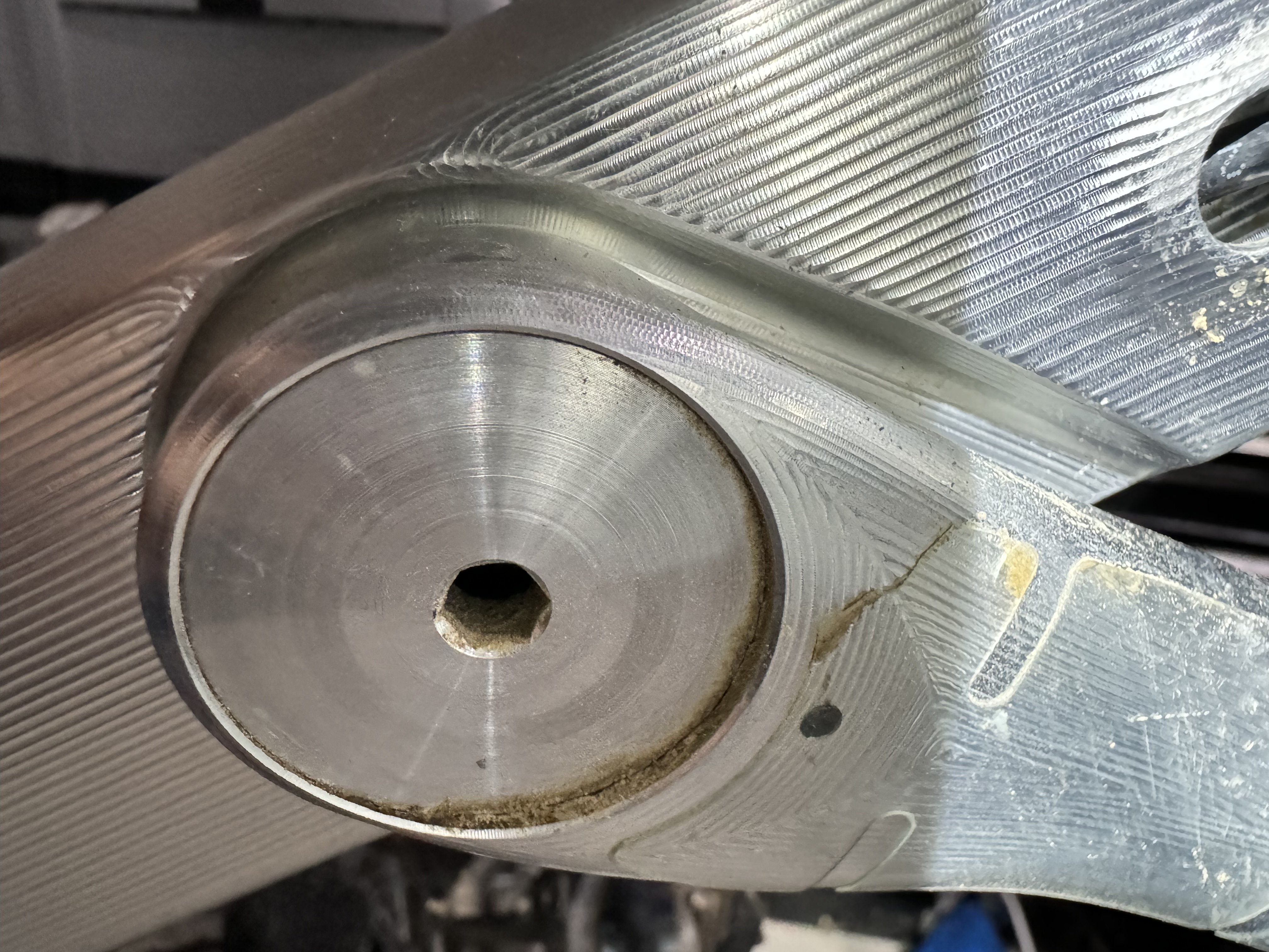

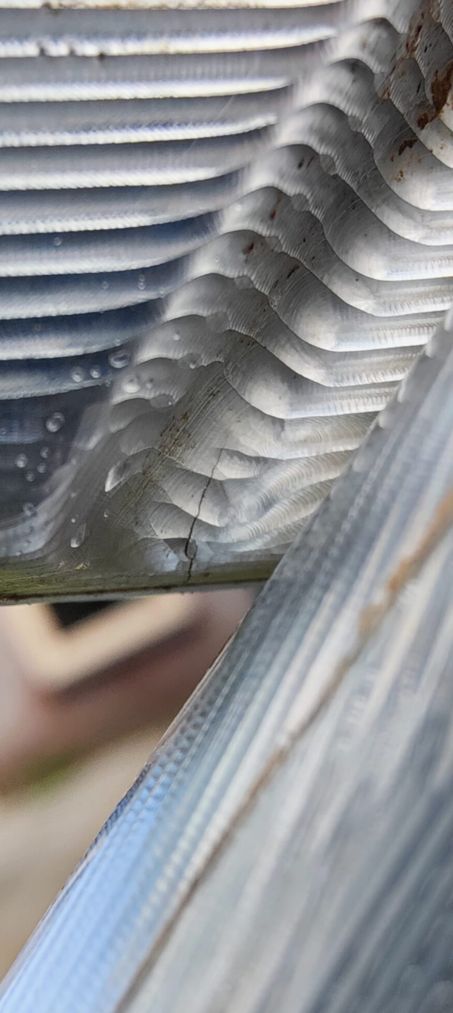

I'm not sure there is a common denominator.
Because even the failures are not consistent.
As far as I can see, there are three different types of failure. Yon have the cracking around the top linkage, which is the failure that's been recognised by Pole, the delamination of the actual join, and this can occur anywhere and a rarity as I had, wearing of the material that touches the bearing surface.
I think it's just pot luck if your bike will be affected.

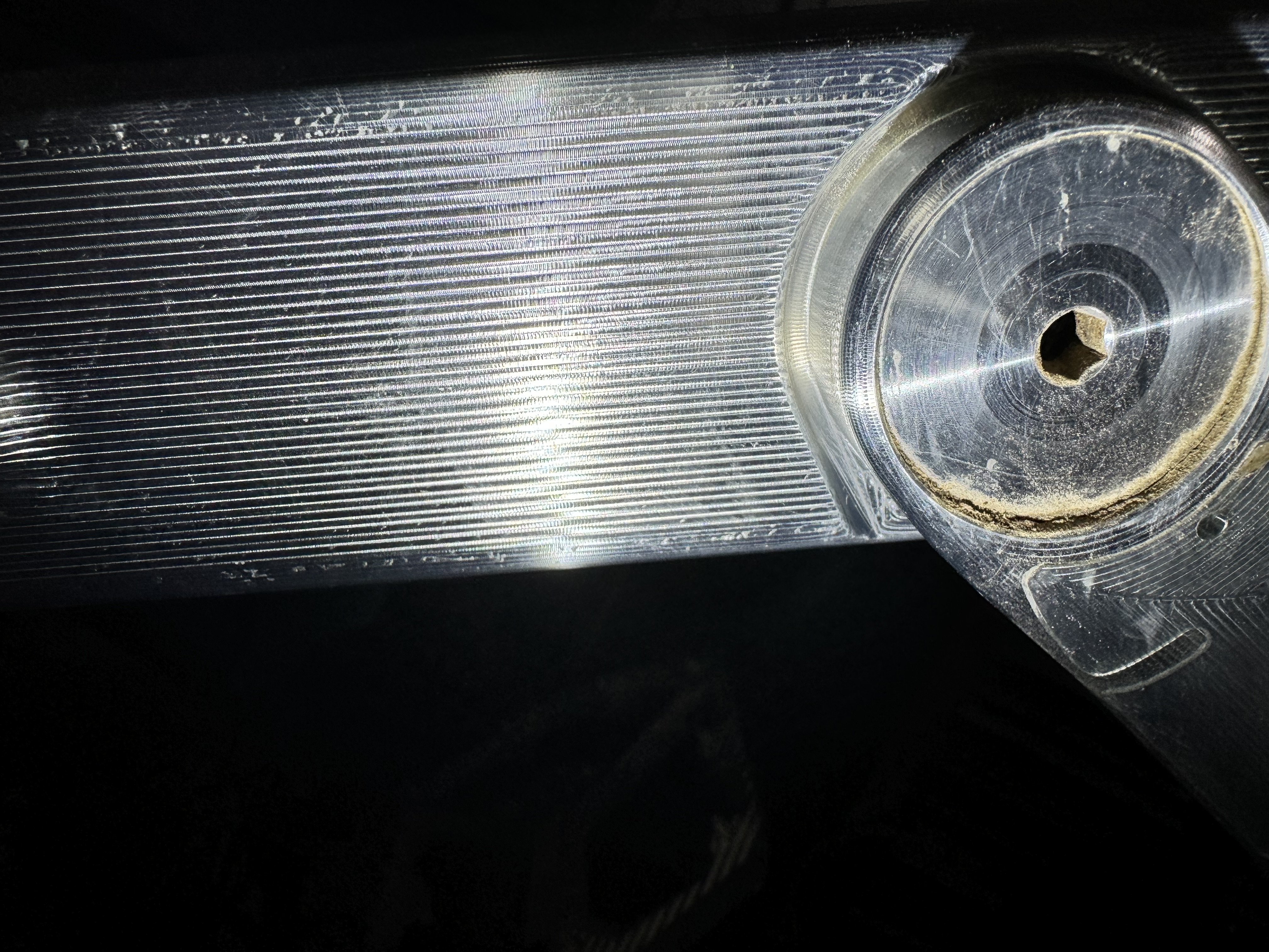

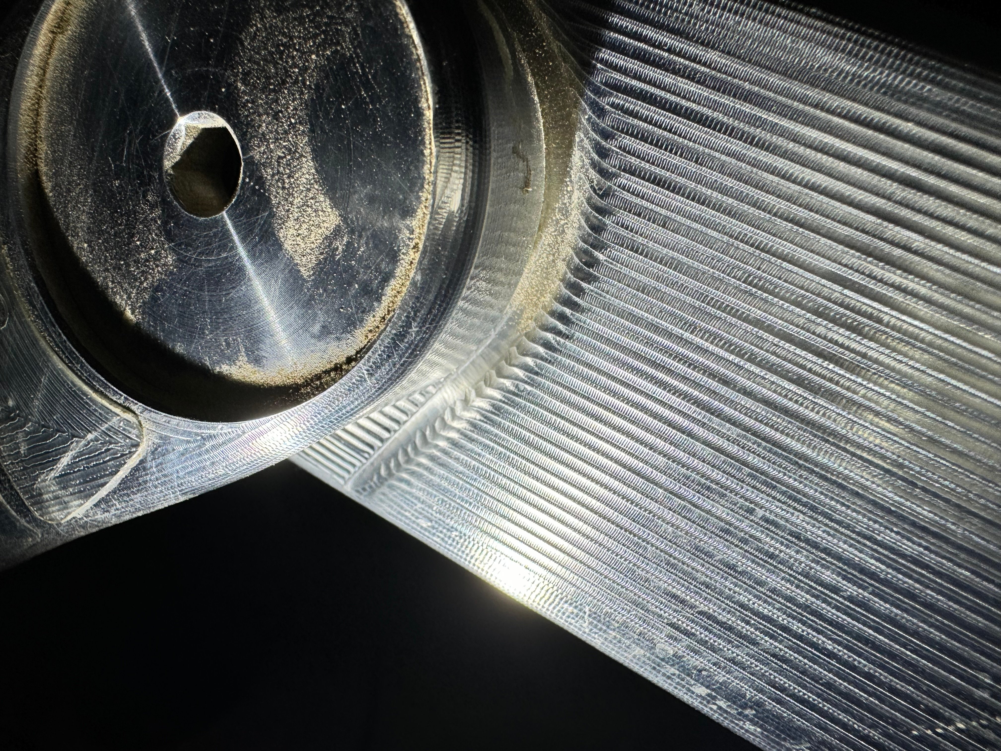

Unfortunately no photos and you wouldn't see it in a photo anyway.
But basically on the drive side only, the two bearing locators on the inside of the main swing arm spar, had worn, which made them baggy on the bearings causing play.
Apparently my case was the only one Pole had seen.
I believe the machining tolerance was a bit to small from new, which gave just enough play to wear.

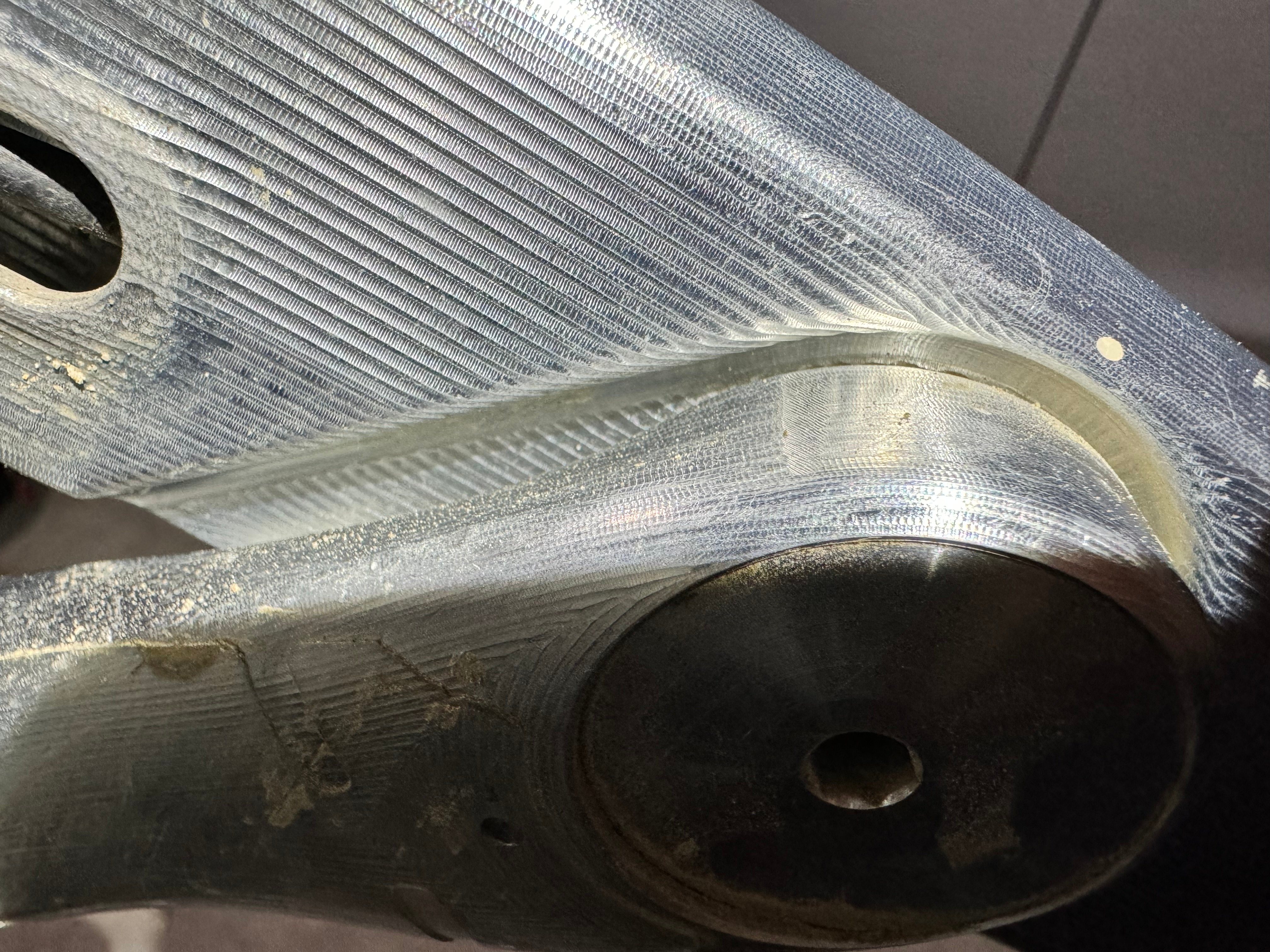

I happen to own @Onetime 1st gen Voima (serial K0002) and it's in perfect condition after about 3000 miles. I just did a detailed swingarm inspection during a tire change. There's nothing suspicious going on, so hopefully this will be the case for most of us, since in reality, the frame will be only good for recycling if Pole is not resurrected.
I don’t think there were any specific bad batches per sey. I have heard that heavier riders who schralped their bikes hard in berms and whipped their bikes sideways off jumps and landed off center or possibly had rear suspension settings that were either too stiff or too soft and had repeated hard bottom out landings off jumps we’re the ones who had braking/cracking issues. Those things put a lot of stress on the rear end so I try not to do them when I ride. I’ve had a first gen Voima without any braking/cracking issues and now I have a second gen Voima that has not had any cracking or braking issues so far🤞🏼. I am however having issues with my motor/battery shutting down during rides, but I’m currently trying to get the battery replaced under warranty through my LBS/Bosch dealer. Hopefully someone will buy Pole and they’ll stay in business so we can buy whatever spares we want or need.

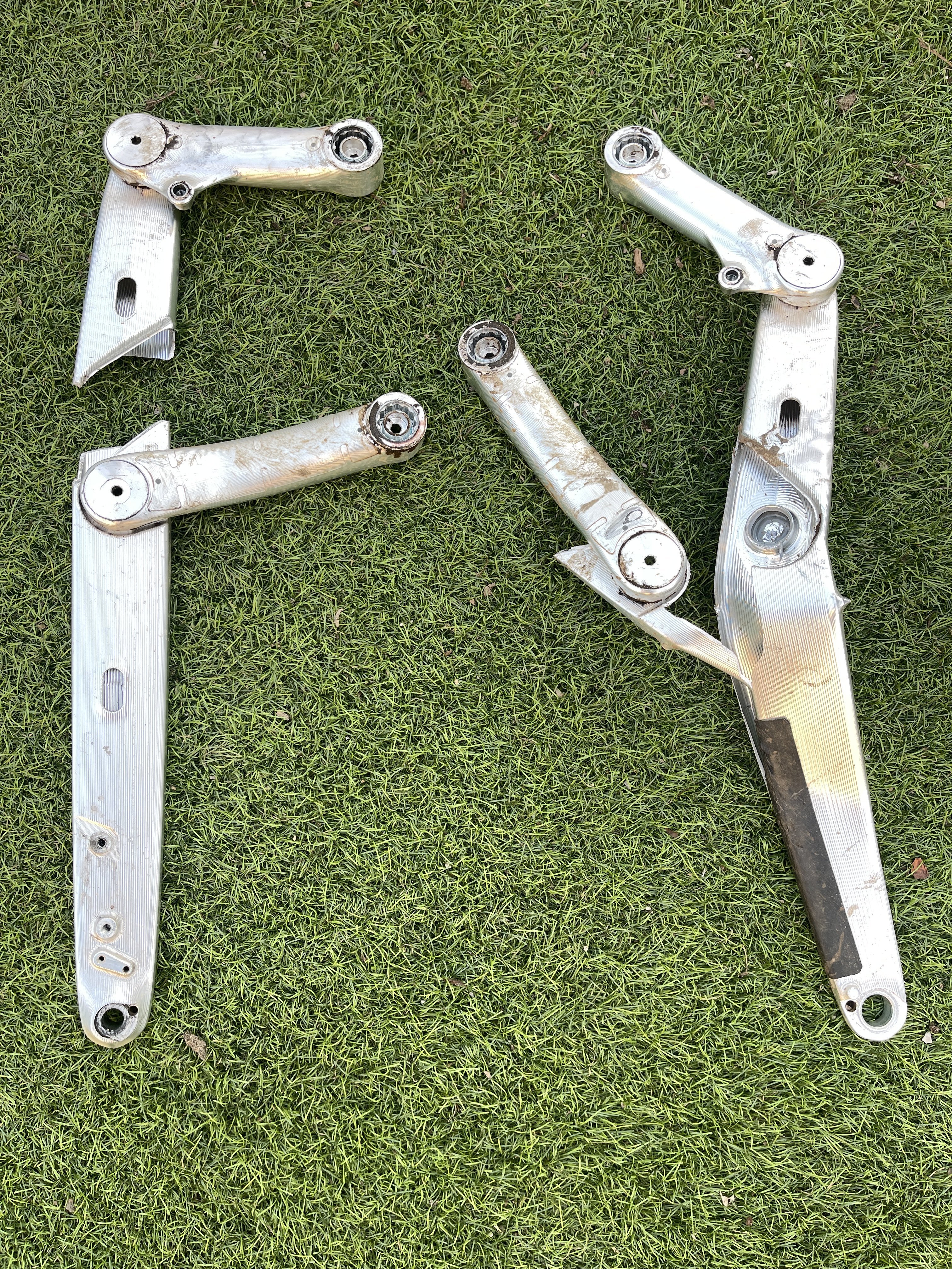

Both swingarms on my 2nd gen Voima crumpled landing a small jump but clearly there must have been cracks growing for a while. The rips in the failed swingarms started exactly where the problem spot is where the lower linkage bolts up.
Pole replaced swingarms and linkages just before they went under. Took about 3 months from warranty request to get the redesigned swingarms.
6’4” 235lbs. Guess you could say I’m hard on bikes as this is definitely not my first cracked frame.
