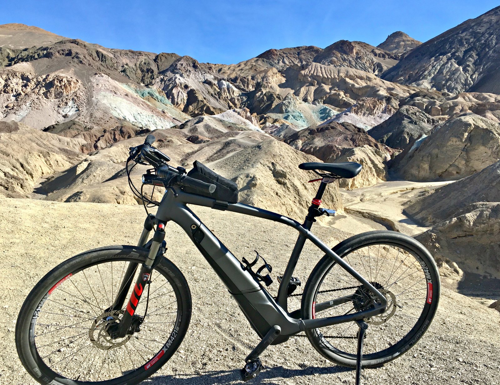

I'd recommend against a hardtail E-bike for any off-road use but the smoothest trails.
I have a 29er hardtail non-E bike (Chisel) that I ride on and off-road and a 29er hardtail E-bike (Vado*) for road use. The Chisel is light weight and great fun on tarmac and on dirt, but the Vado is really only suitable for the smoothest terrain. There's just too much unsprung weight on an hardtail E-bike to work well off-road. The suspension fork takes a bit off front impacts, but the extra 15-20 lb. or so from the battery and motor weight the rear end so much that you can't absorb bumps and shocks with your legs the way you can on a regular bike and any drops would probably cause damage. E-bikes are also generally built a bit stronger than non-E-bikes, so they're less compliant and even less forgiving on rough surfaces.
In contrast, my full suspension E-bike (Levo) performs off-road almost as well as my full squish non-E bike (Stumpy). Mount up some smoother 27.5 tires and they also do fine on the street as hooligan bikes (except for the 20mph cut-off). I've even tried 29er wheels on both bikes but prefer 27.5 for the quicker handling.
* My Vado is modified with a Manitou 100mm fork, 27.5 wheels, 2.3" tires, and a dropper post. I can manage on smooth trails, but it's not an off-road bike by any stretch of the imagination.

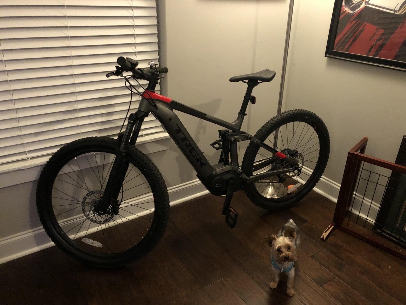

Timmygp
Jul 29, 2018
7
25
Lake Charles la
The powerfly 5 full suspension is being delivered today and it just so happens the bike shop is having a tax free weekend this weekend that I didn’t even know about, so that is going to save me an additional $500. I ride a traditional hard tail mb right now and it’s fine on the trails, I honestly didn’t consider the extra weight of an ebike on the trails - that’s a very good point.
