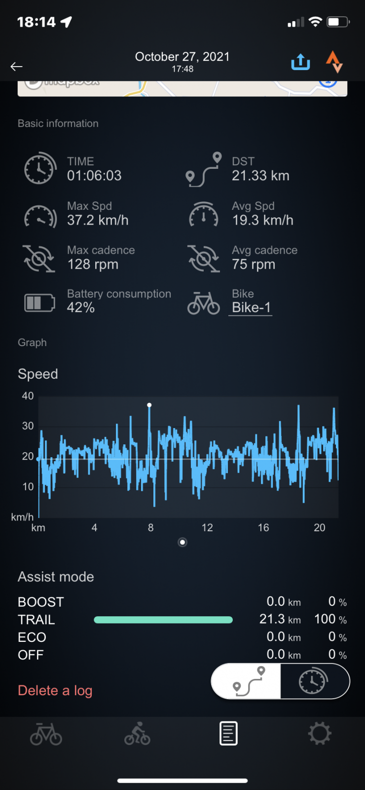

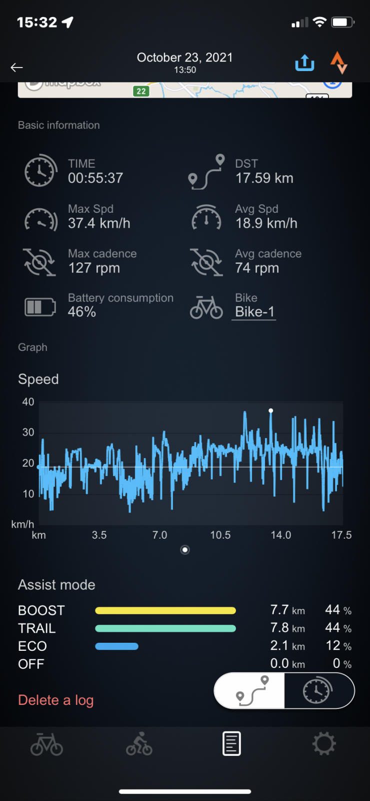

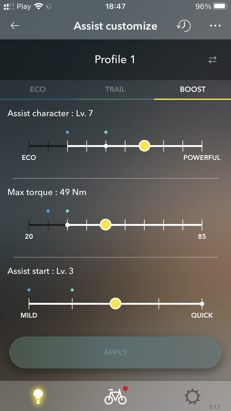

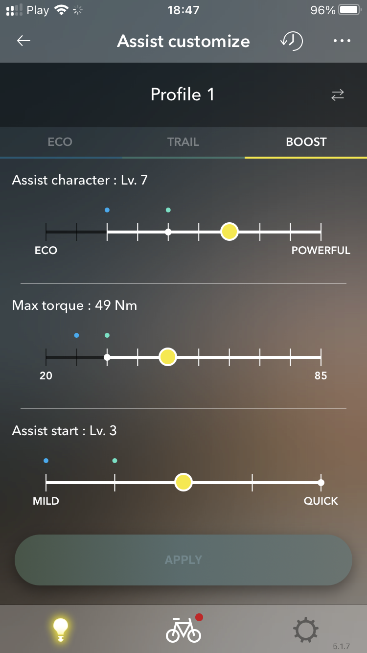

Took my Orbea Rise for a ride today. 20 km in Trail mode. Used 42% battery. I will do a similar ride in Boost mode. The only one I have now is this pic.
That seems highly unusual. What is that pic supposed to show?

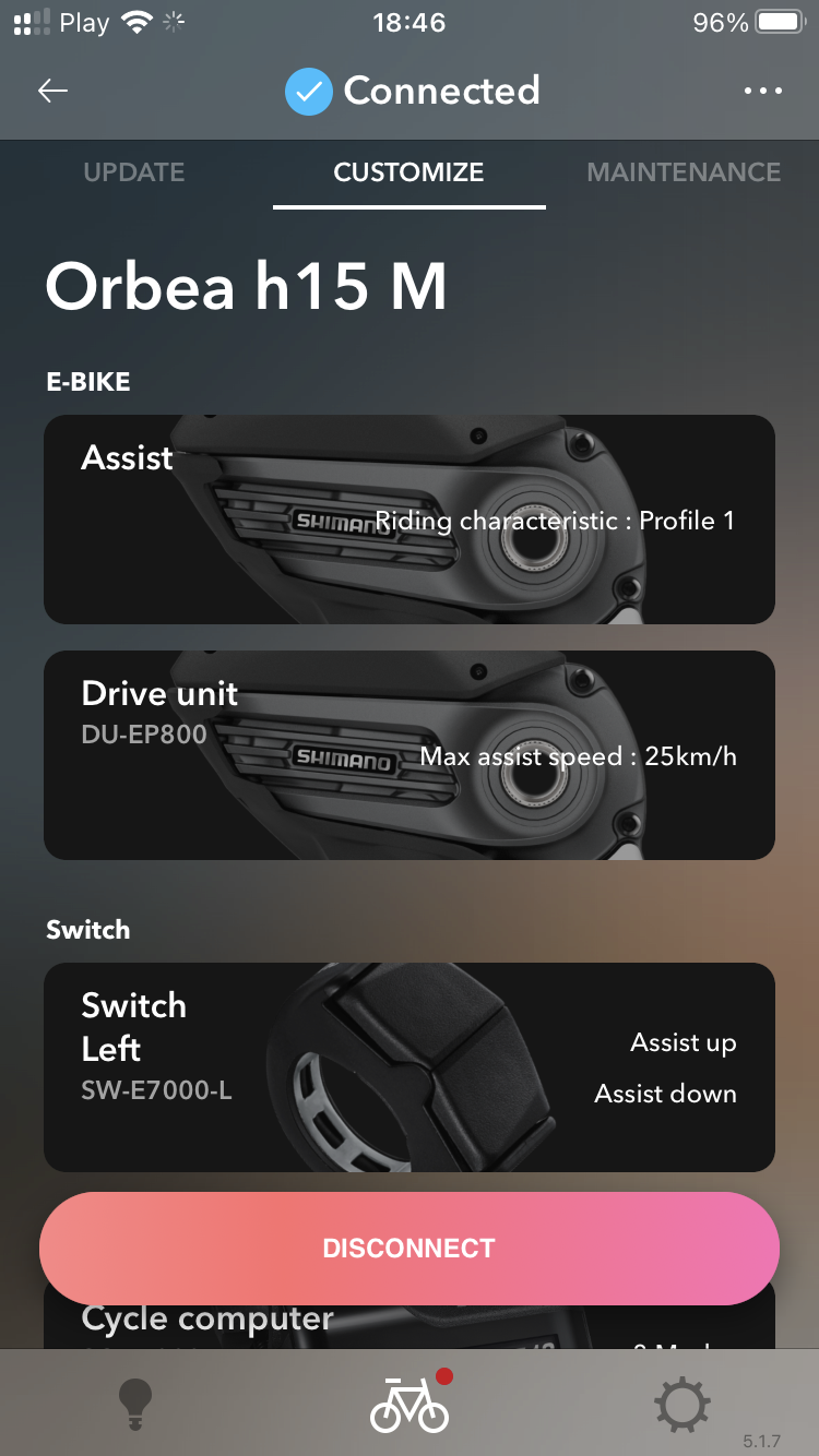

Also my motor displays ep800 in the eTube app. How is this in case of the original software, can you share your screen? The sticker is present on the motor.

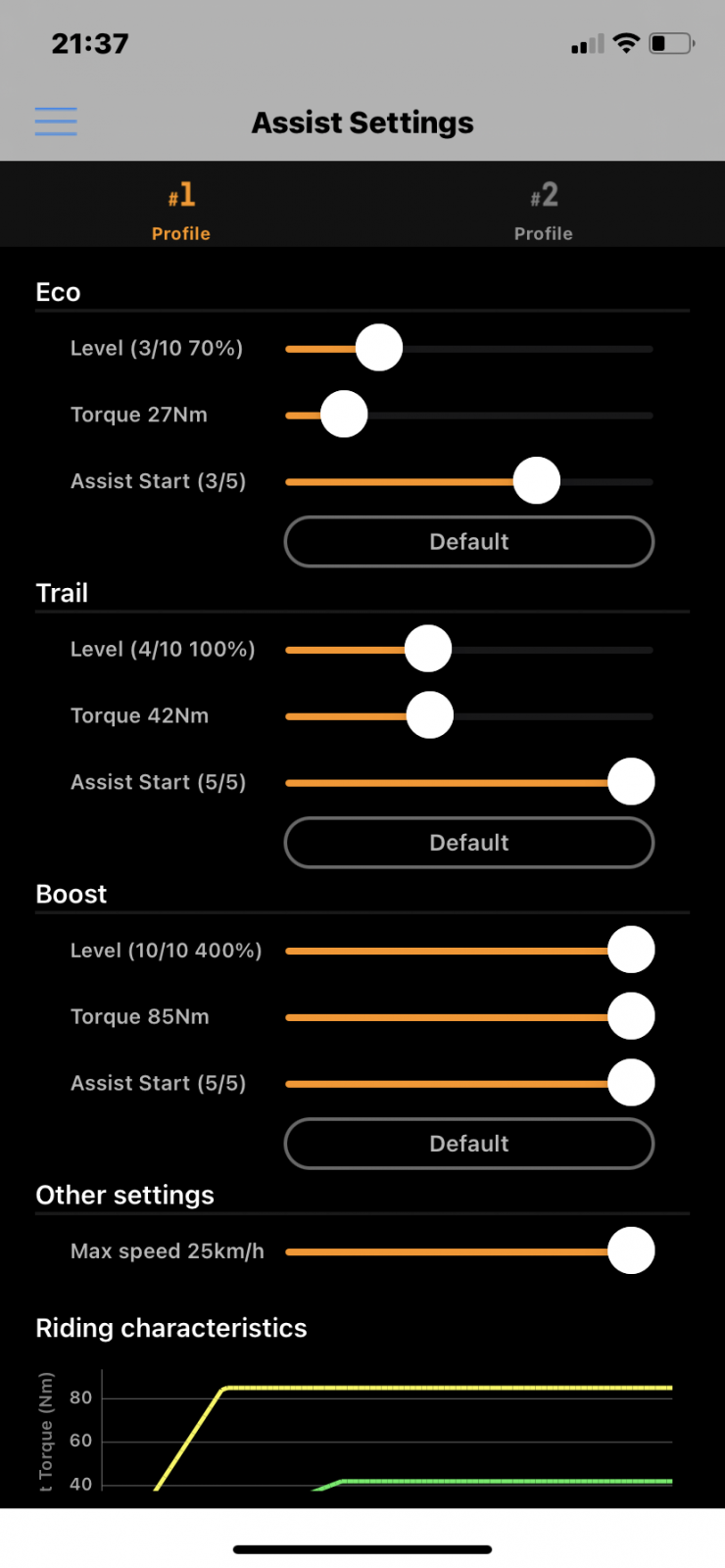

9C3D04C5-BCCD-45E0-A800-8DD96CC940BC.png 23019495-2C40-4FF3-94B0-C8F0A1DB7503.png
Hello, it seems the motor has a bug sometime. Mine display 85nm in etube app, but he is a 60nm. The vendor haven't change it.
He ask at orbea and shimano, and the answer was something like : the bike has the orbea rs firmware, he can't give 85nm, but when programing the motor there is somewhere an area to says at the motor he can't go over 60nm and they forgot to fill it. So the motor is at 60nm max du to the firmware, if you put more in app it won't deliver more.
You can do the test on a ride you do often, do some with 60nm on the app and 85nm on turbo. You won't see any difference. If you put 35nm you will see it.

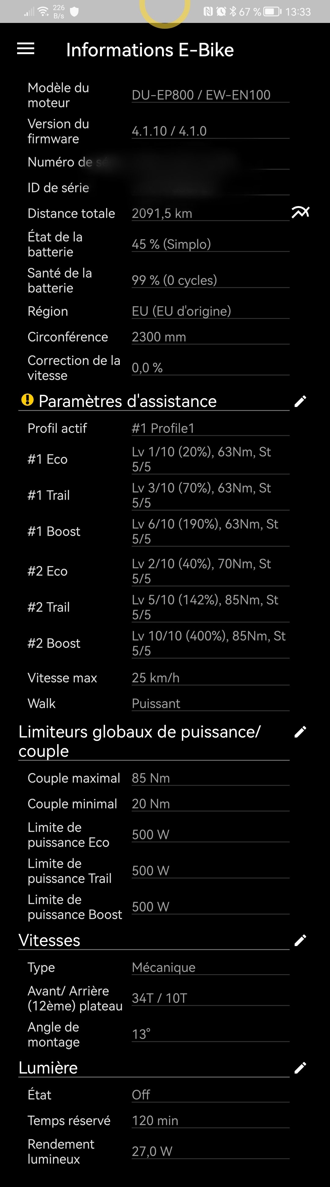

So - can anybody share their E-TUBE screen where it says what motor is in the rise?

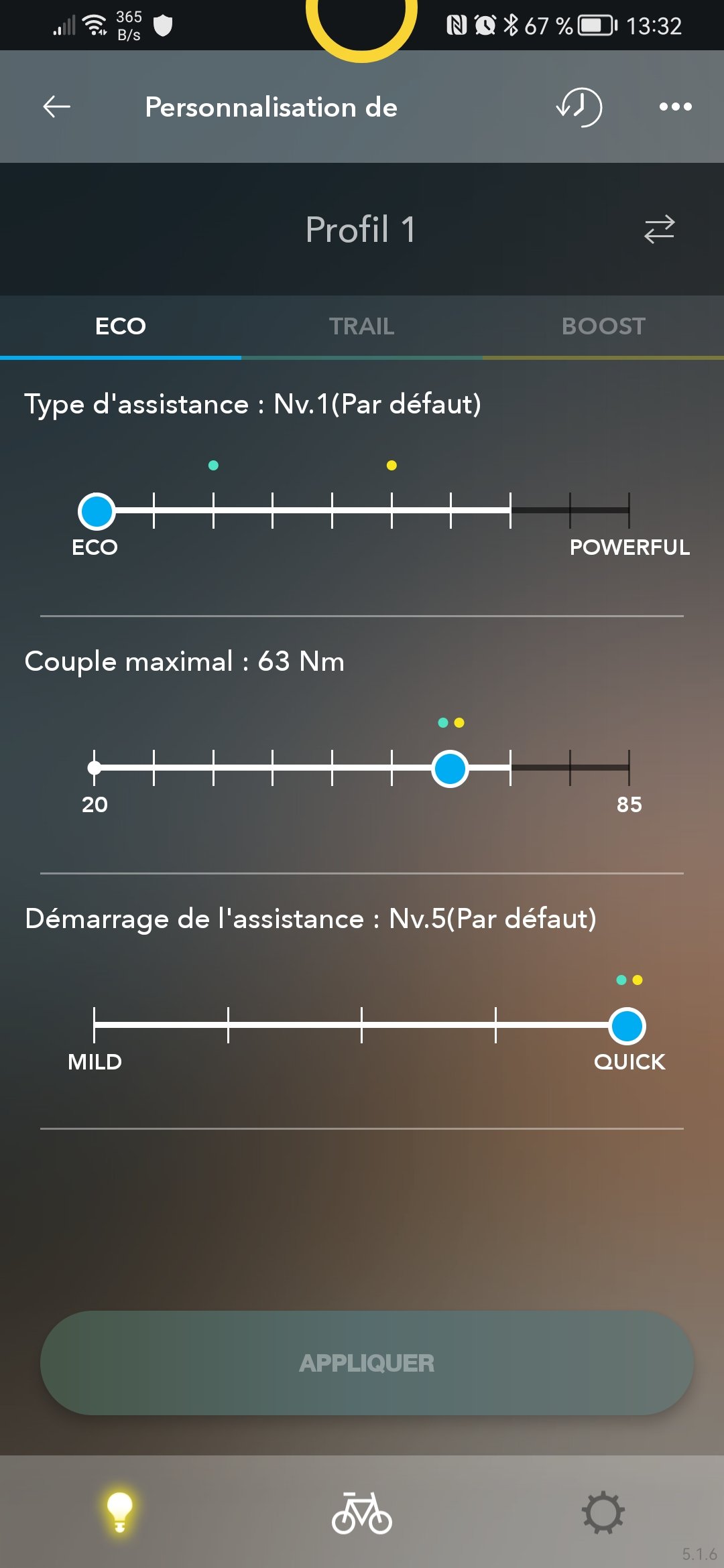

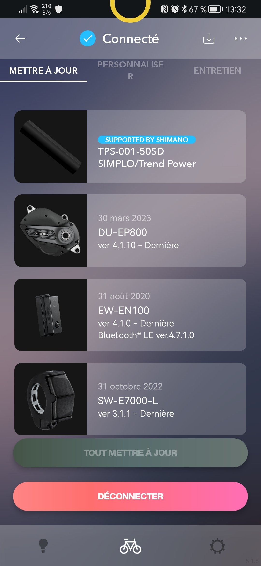

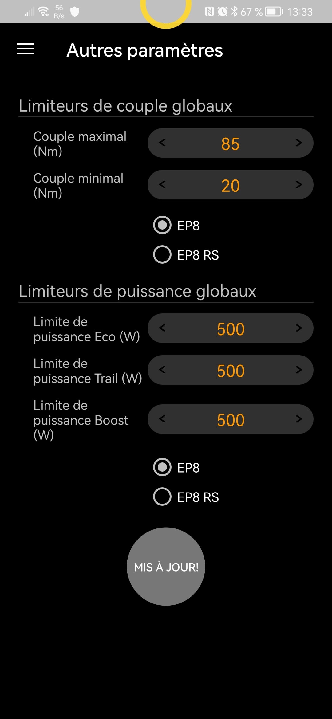

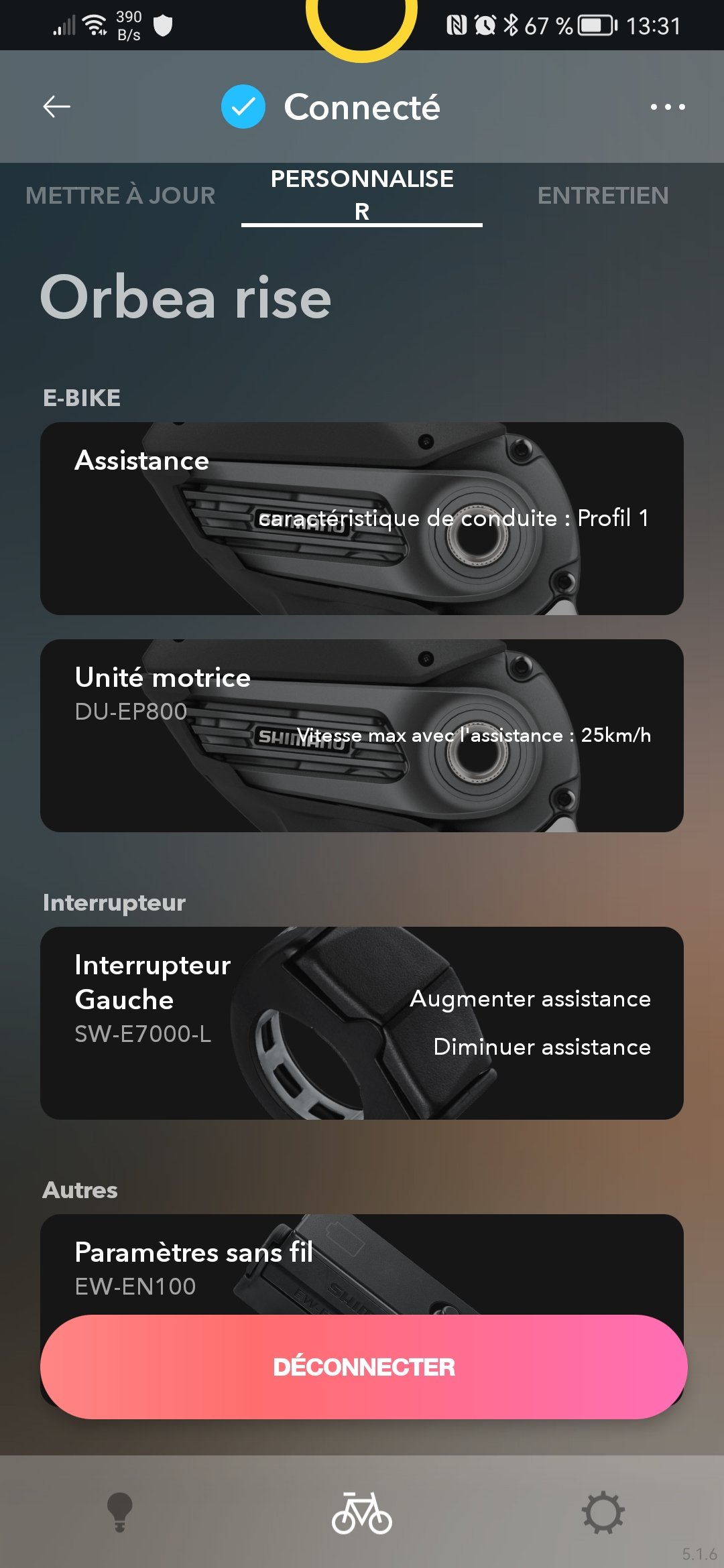

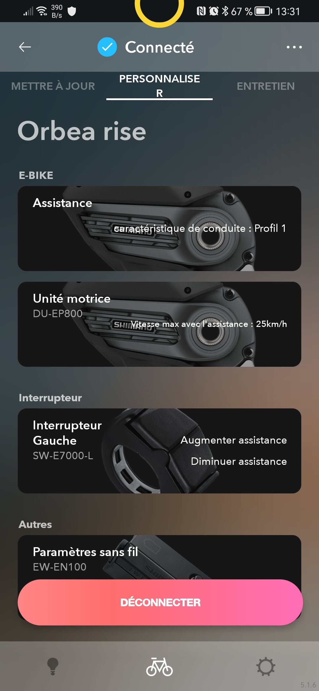

Hi, this is my screenshots
I'v test to select EP8 RS on St Unlocker instead of EP8, in e-tube max torque goes to 60nm
Point Blur_Apr282023_133802.jpg Screenshot_20230428_133359_com.stunlocker.app.su.jpg Screenshot_20230428_133223_com.shimano.etubeprojectmobile.droid.phone.jpg Screenshot_20230428_133214_com.shimano.etubeprojectmobile.droid.phone.jpg Screenshot_20230428_133128_com.shimano.etubeprojectmobile.droid.phone.jpg
so it is not very clear what the motor should be in the ETube app and if switching this to 85Nm does anything to the software like corrupting it maybe...
