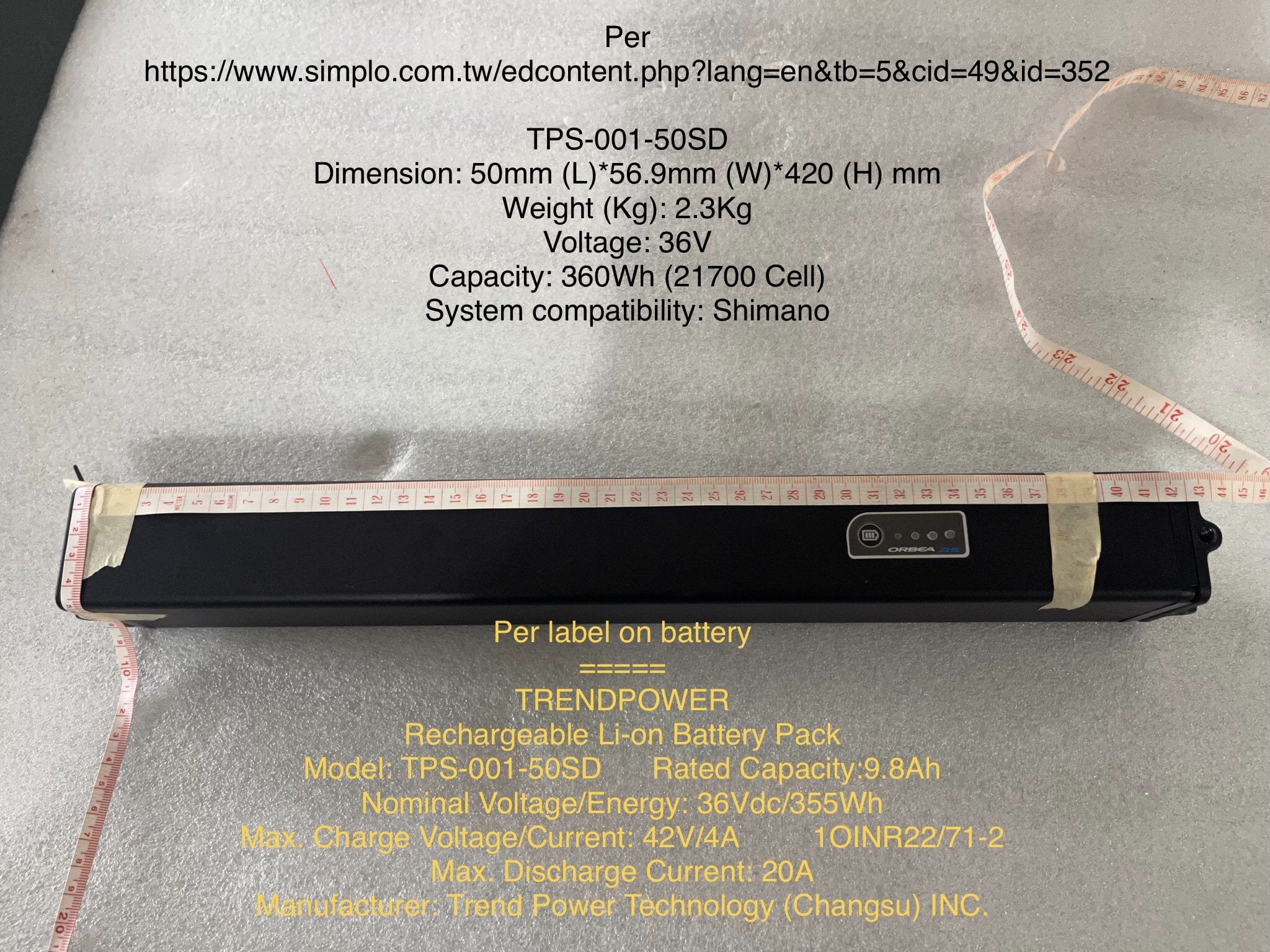

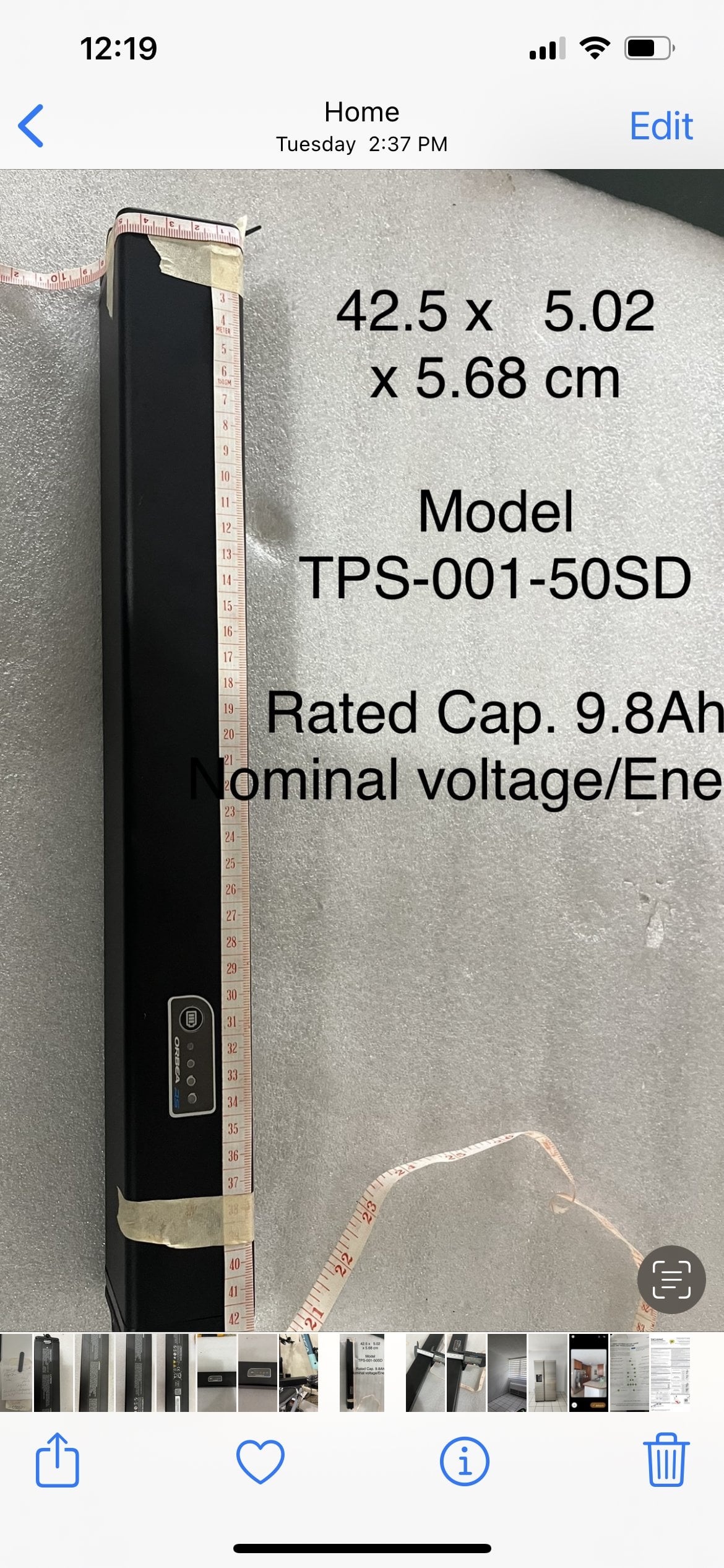

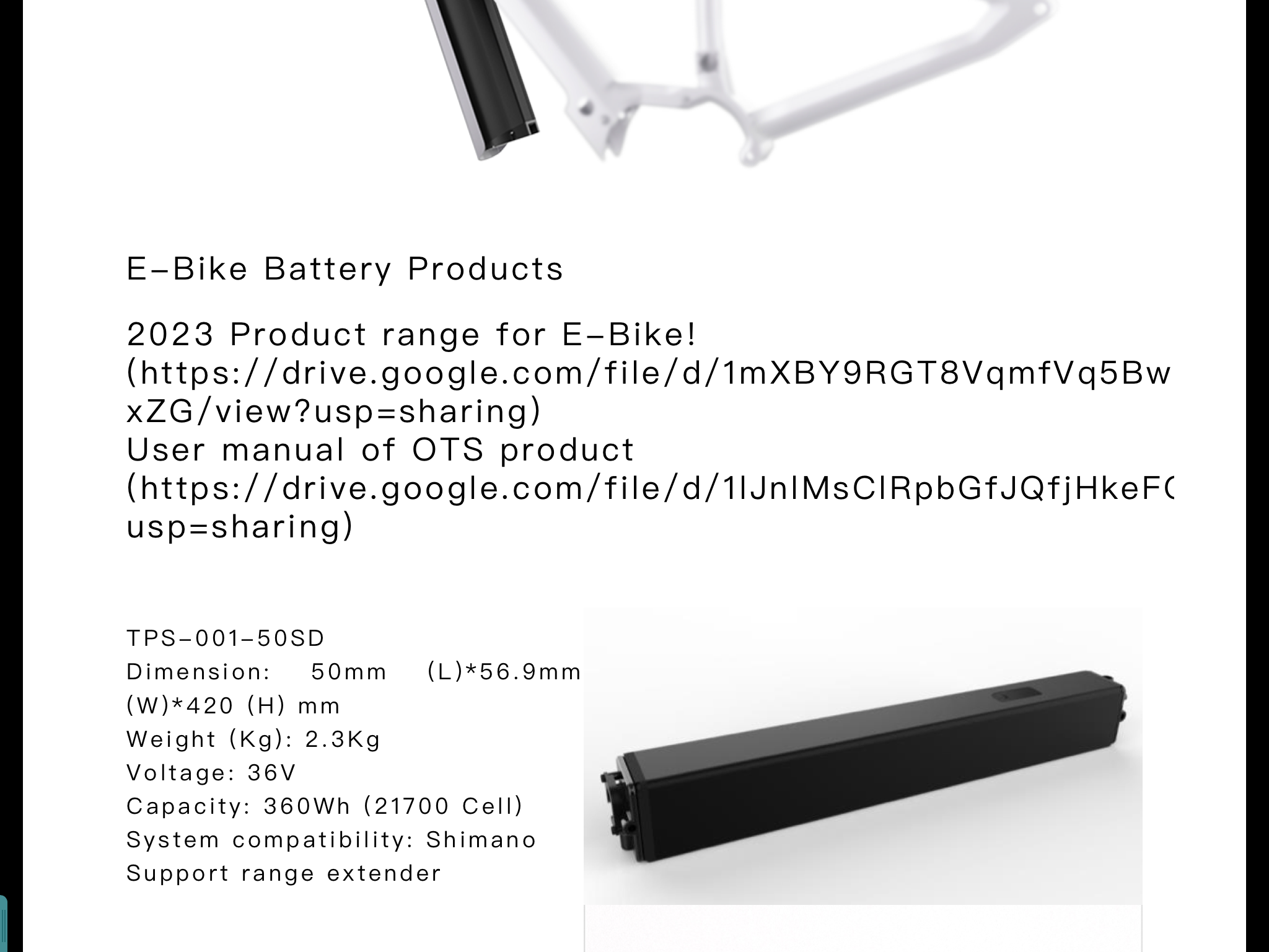

The 360 WH pack is a TPS-001-50SD SIMPLO/Trend Power with 21700 cells LEV High Power
Battery for the M (carbon) Rise models.
