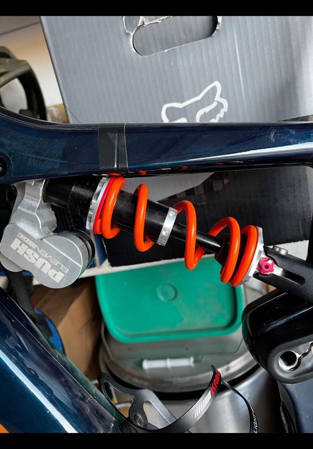

So my friend added an offset bushing at the top along with a FOX SLS coil and the clearance (visually) seems to be better compared to before... see pic attached. Now let's see how it would perform on the trails...
This terrifies me. I just can't see it is worth doing something that you know is already damaging the frame - even if it appears cosmetic, you never know with carbon, and the leverage that a big drop exerts through the shock must be massive - many times bodyweight, especially as it would ally force as a lever. What happens if you go off a big one - might crush the frame a couple more mm there leading to a total failure. You wouldn't stand on your frame with a stone in your shoe and jump up and down until it left a mark. Why would you do this?
Just curious Wild-Fins, what's the spring rate of that SLS coil and which year is it? All the new 2021 and 2022 SLS coils contains more coils for the given stroke it's compatible with.
