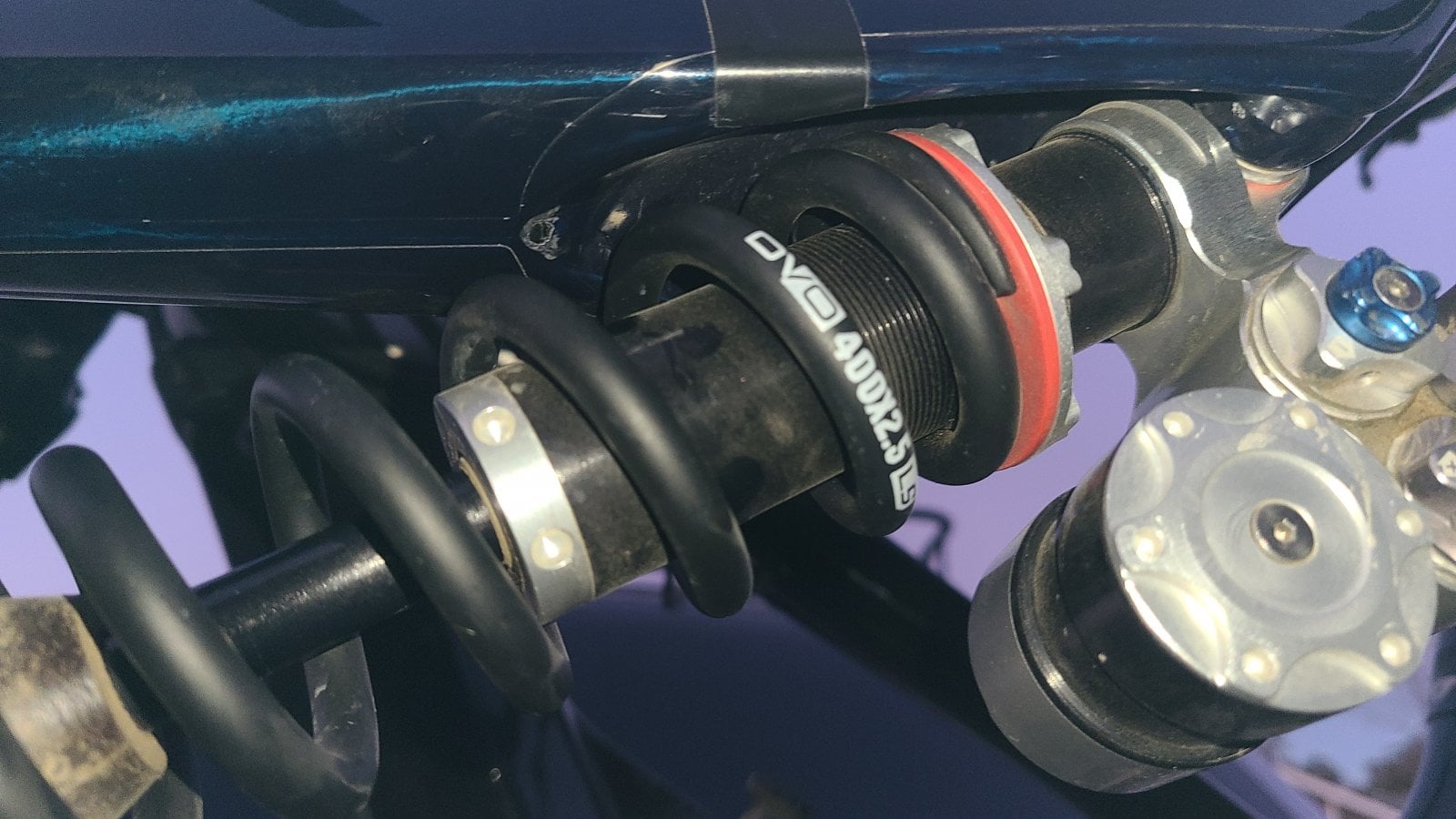

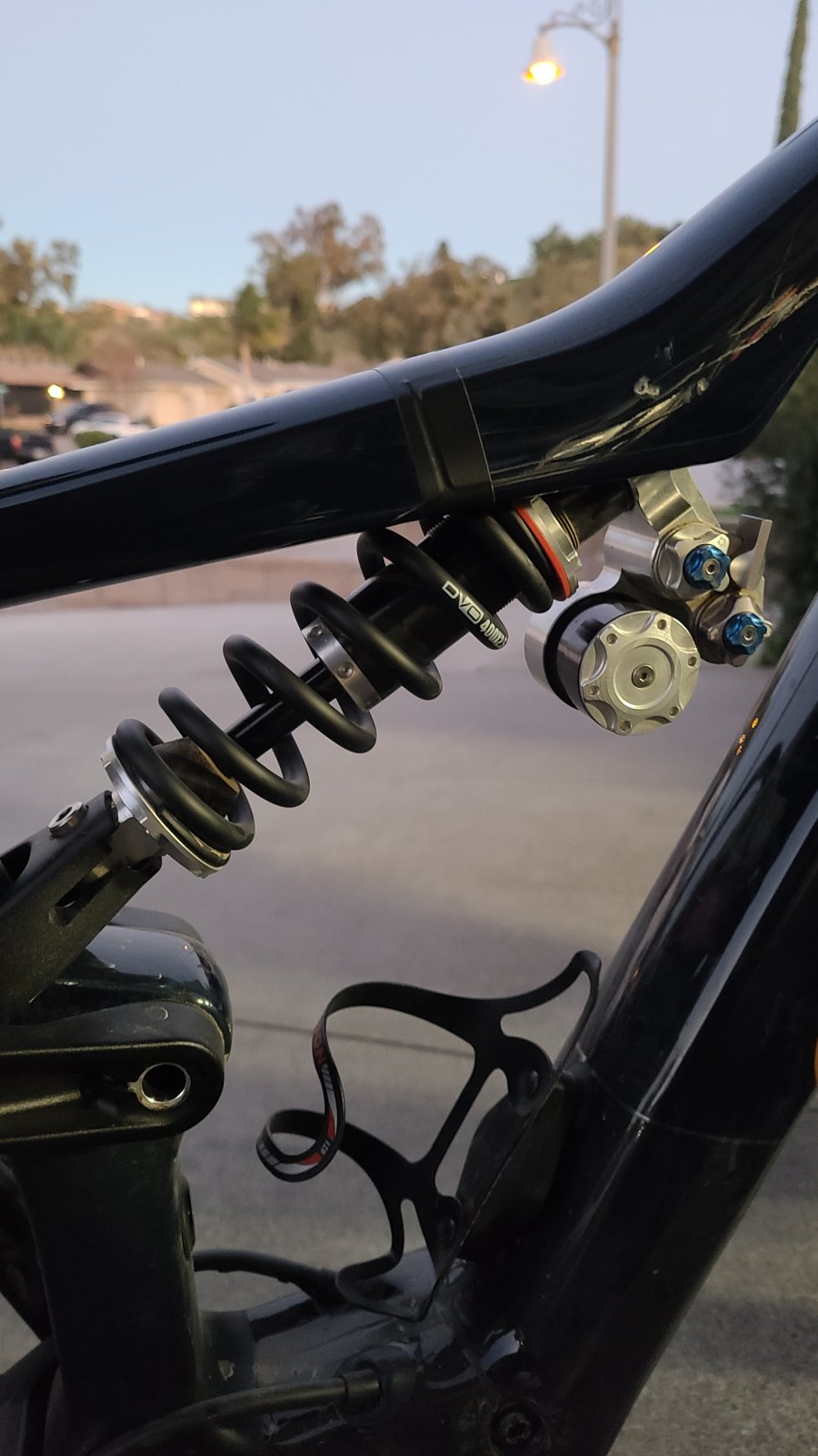

Here’s my tips.
fit a 9.5 x 2.5 shock. 216 x 63mm. Ohlins coil no issues. Spring rate will actually be a bit less due to increased stroke.
fit one offset bush in rear position otherwise the rear links touch and you also need to compress the shock to fit. So that 1-2mm really helps.
I fitted a 160mm Lyrik. Same axle to crown as the fox 36 150mm. So I wouldn’t say is a must but more balanced travel wise.
I also fitted a 34T chainring. This increases clearance and should pedal better. Ratio is fine with 51T rear.
Be careful. E13 34T ring touches the chain guide bolts. I’m sure that’s why someone’s chainring failed. Remove the washers under the guide for thinner ones. I spaced the upper guide instead.

BB is same as stock as the shock is longer. About 340mm. But yep the higher speed is reduced. No issue where I ride, steep hot and humid. if I lived somewhere flat and cooler I would keep 29er.

Have been riding mine mulleted with standard shock & forks at 160mm BB low but been ok. Put the longer shock on with offset bushing but not had a chance to ride yet!

With the 216x63 shock & one offset bushing, the rear is with a NN 2.6 tyre

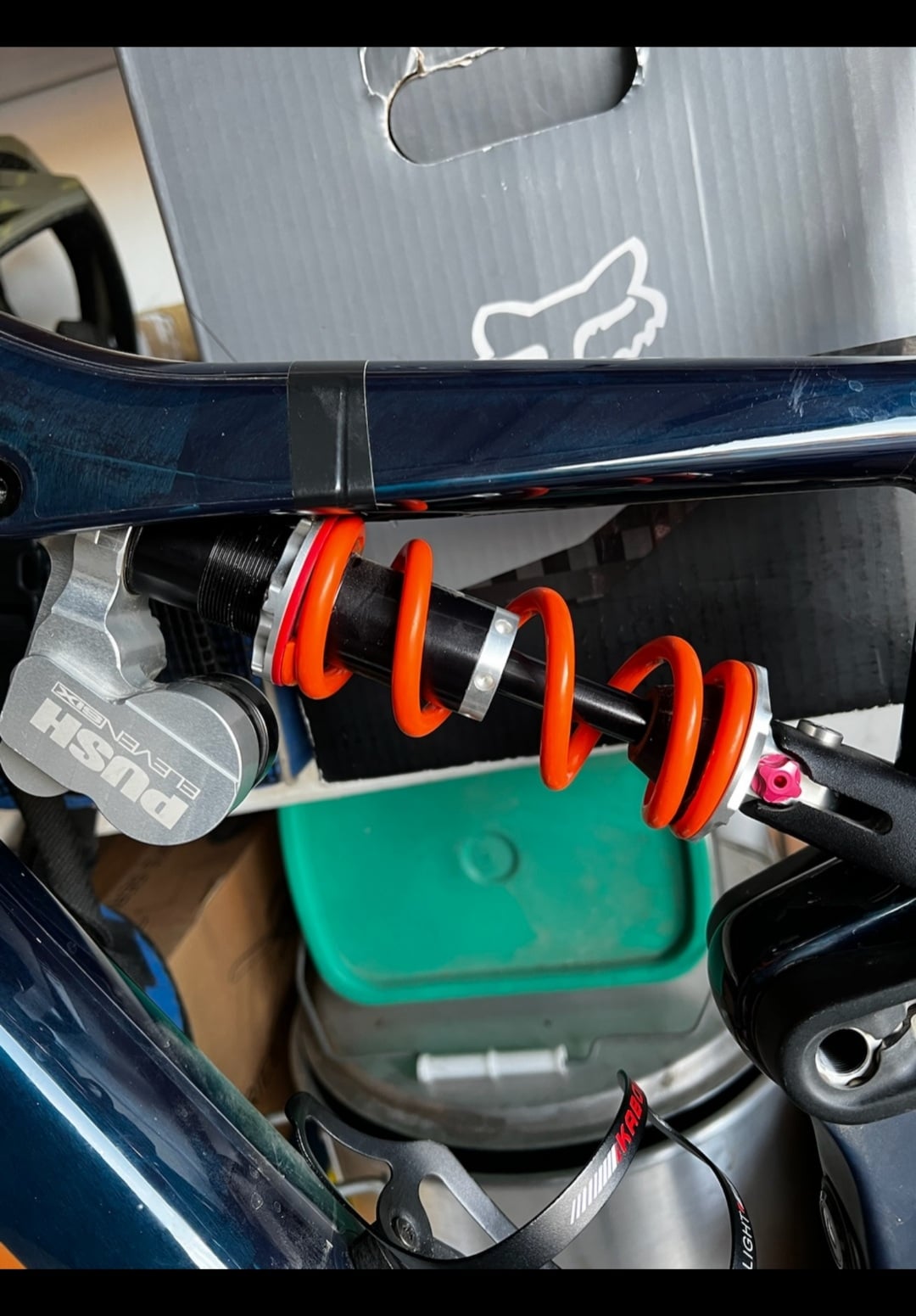

My friend converted his M10 Medium to mullet setup based on users feedback on this forum for a couple weeks now.
Front Fork Fox 36 160mm / Rear Shock Push Coil 160mm = 216x63mm (8.5x2.5) with one offset bushing (tail).
In the past couple rides, he started to hear some weird friction noise below the frame when going over some bumps and so did I when I took the bike for a ride. So we looked closer and found that the rear shock coil has come into contact with the frame and has left some marks under the top tube. We are a bit concerned as wondering if it would cause any damage to the carbon frame.
Anybody has experienced with this issue and how would you resolve it?
Front Fork Fox 36 160mm / Rear Shock Plush Coil 160mm = 216x63mm (8.5x2.5) with one offset bushing (tail).
You should have check with Push before bolting it on because when I inquired Push specifically told me that the 11/6 is not compatible with medium Rise. Agree with previous post, remove the Push shock. If you want to go coil, Storia and Ohlins have no coil rubbing issues on my medium Rise.

So my friend added an offset bushing at the top along with a FOX SLS coil and the clearance (visually) seems to be better compared to before... see pic attached. Now let's see how it would perform on the trails...
