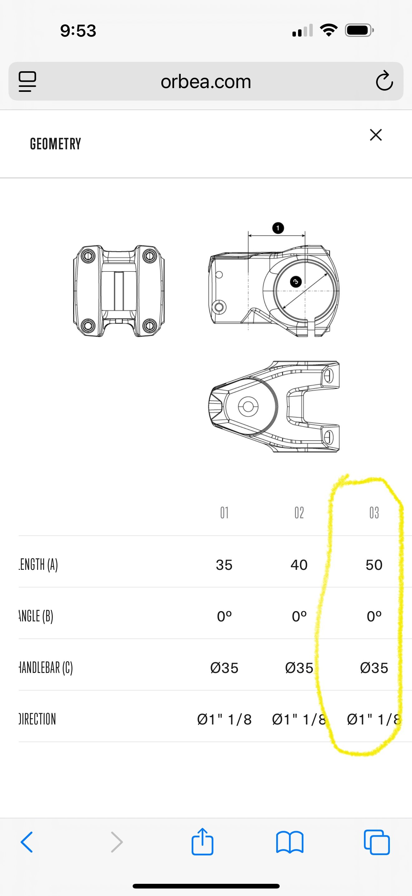

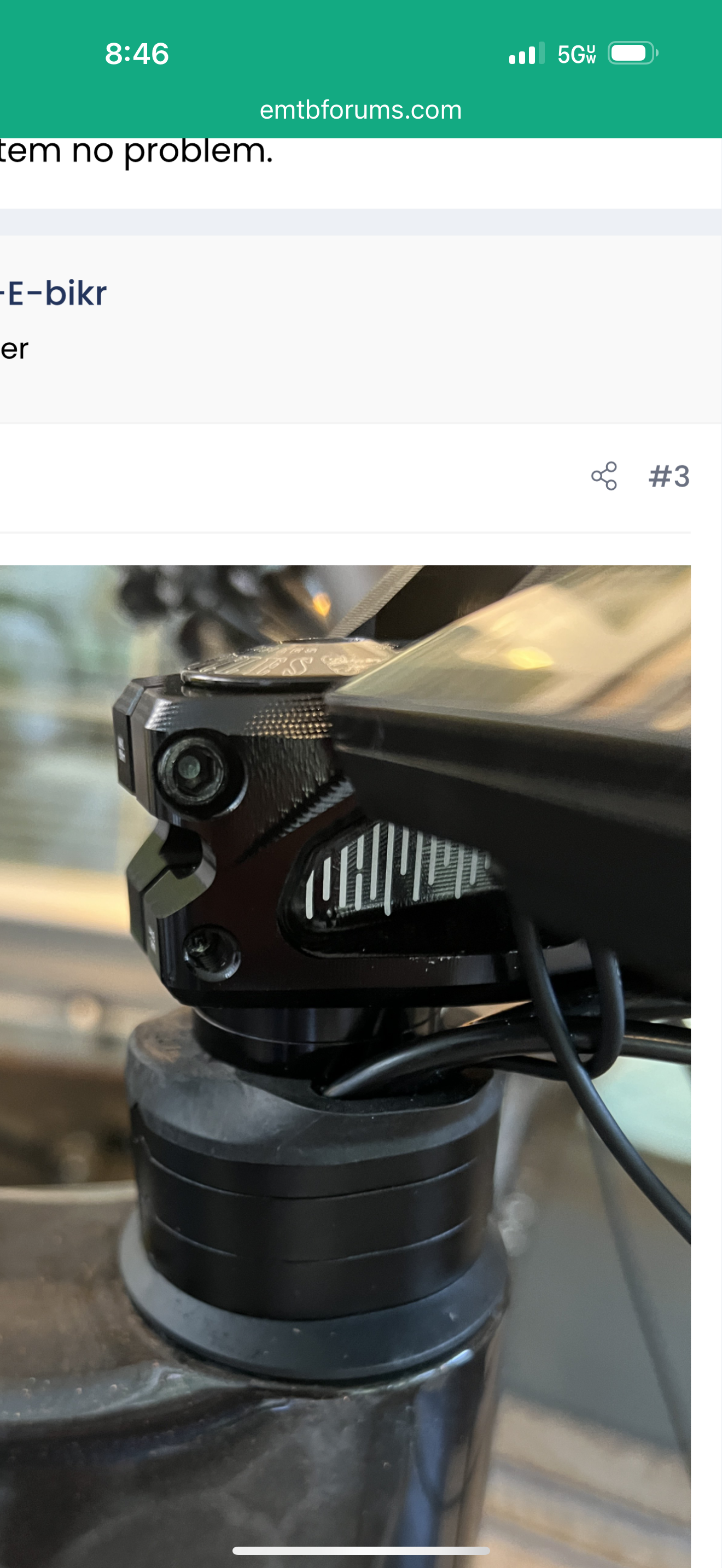

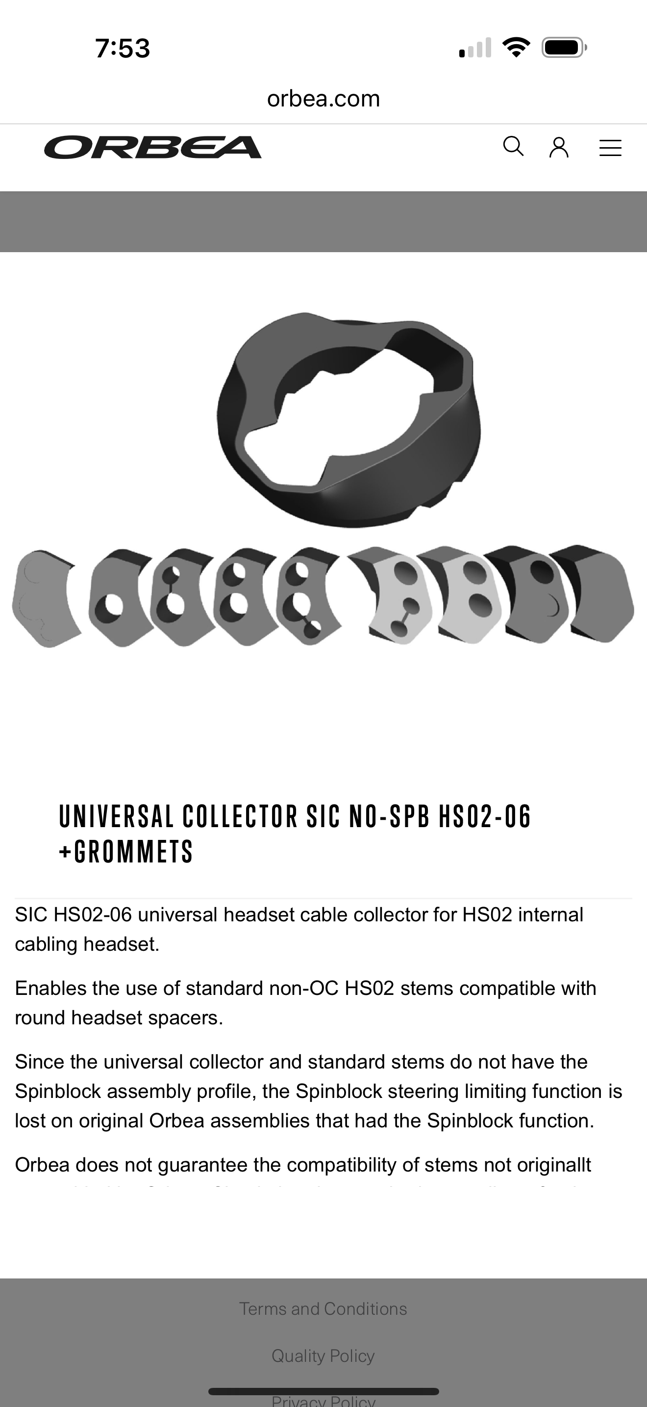

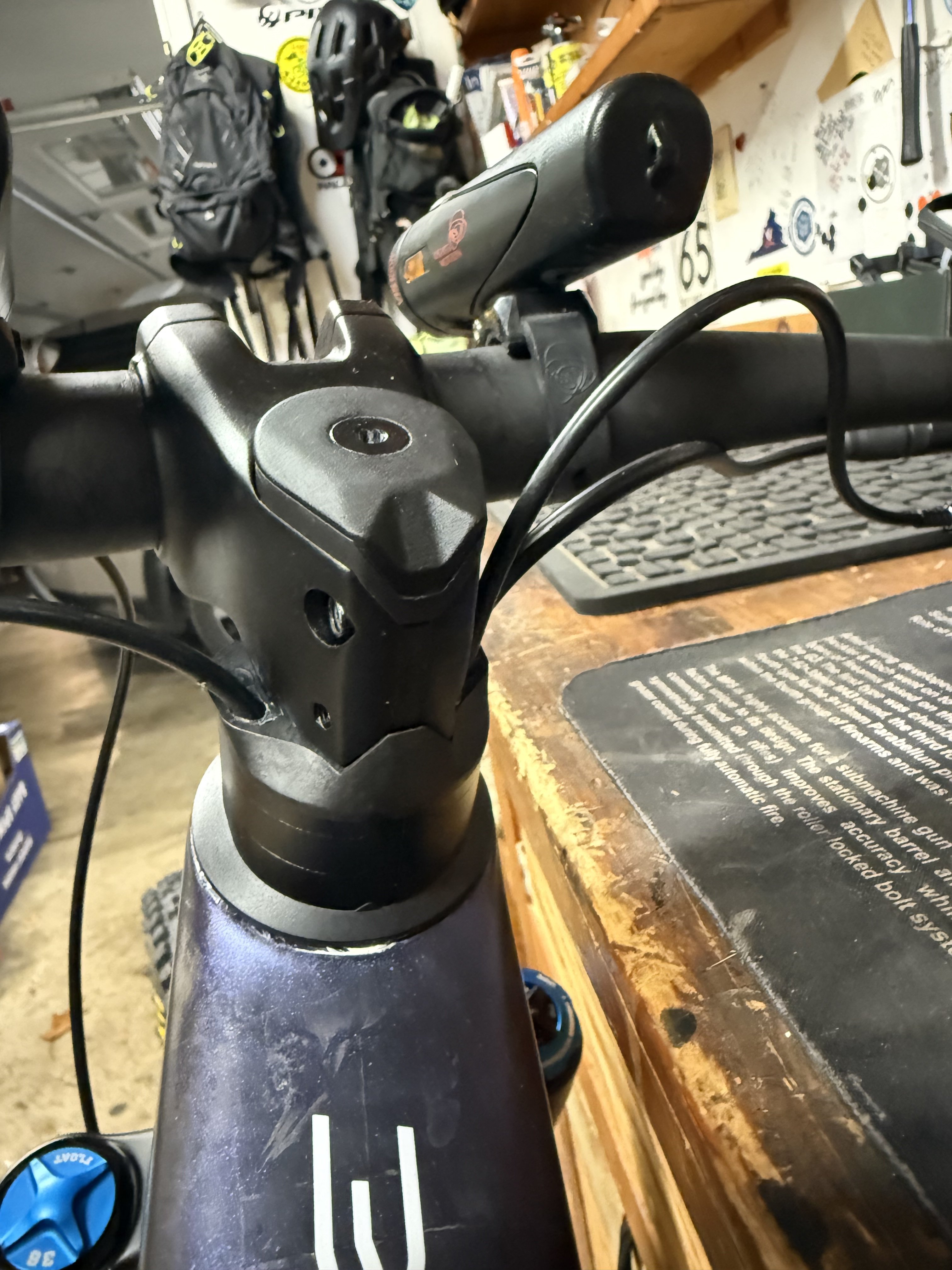

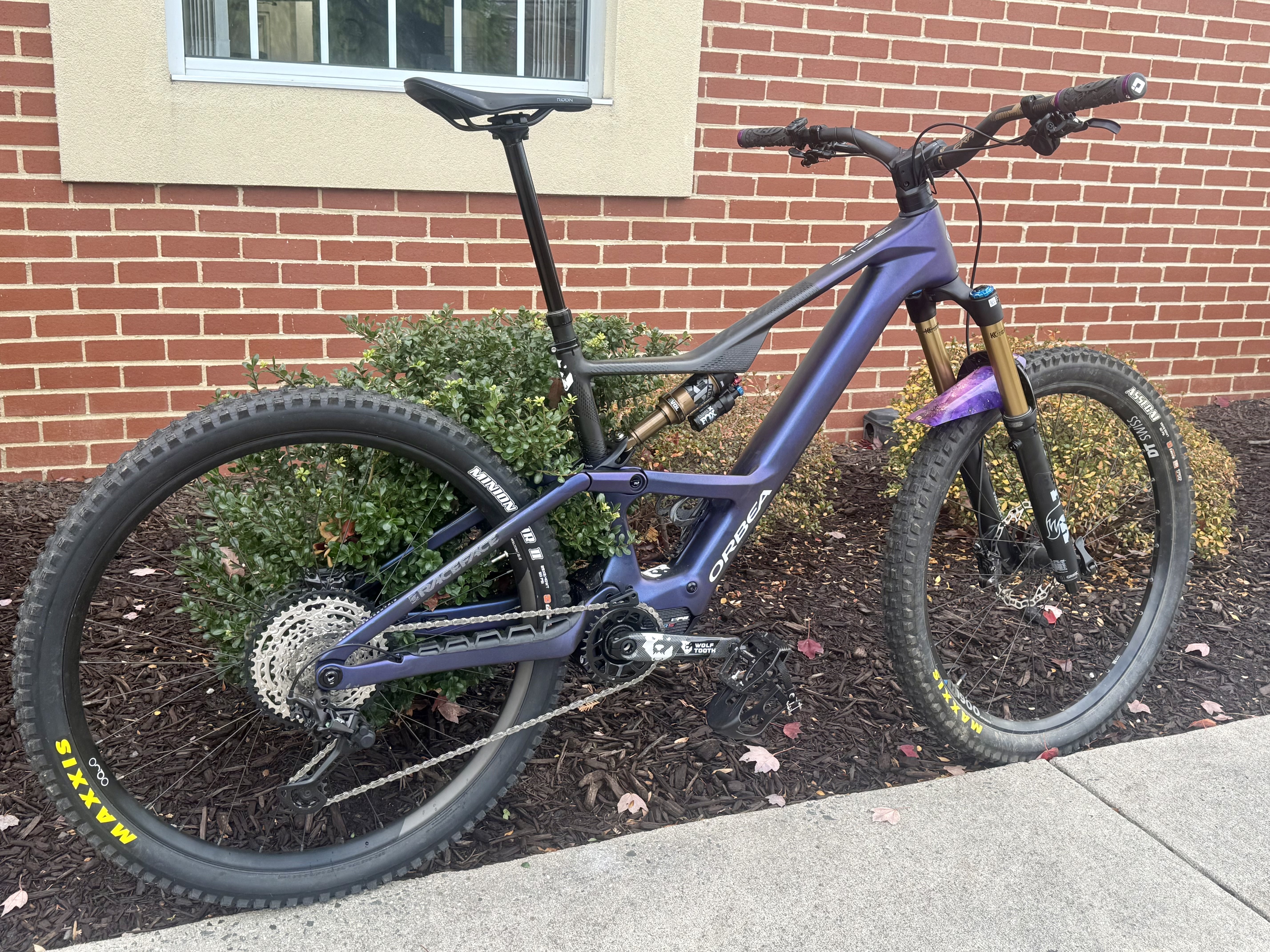

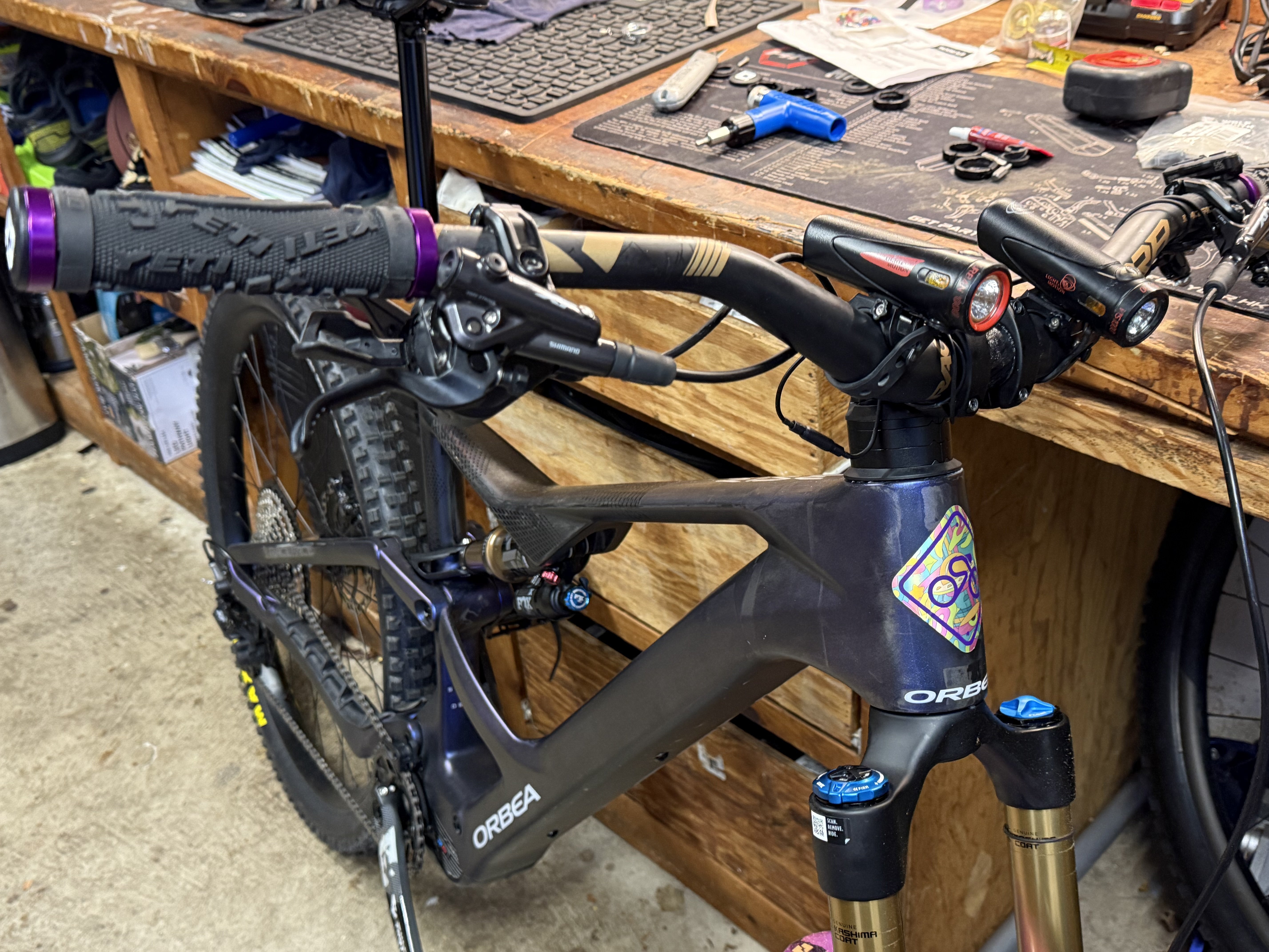

I am 6 foot three with a 34 inch inseam and I’m riding a Rise M10 in extra large. Also using the 50mm stem standard from Orbea, but I upgraded to a 55 mm rise ERA carbon handlebar from Race Face. You will not find higher than 55 mm carbon rise in a 35 mm clamp. Deity and Thomson are a good source for 31.8 mm bars and stems respectively,if you switch stems. Don’t forget the universal collector from Orbea if you change the stem due to the headset cable routing. Enve also makes good handlebars with a high rise. There are more options if you’re willing to go aluminum bar.
