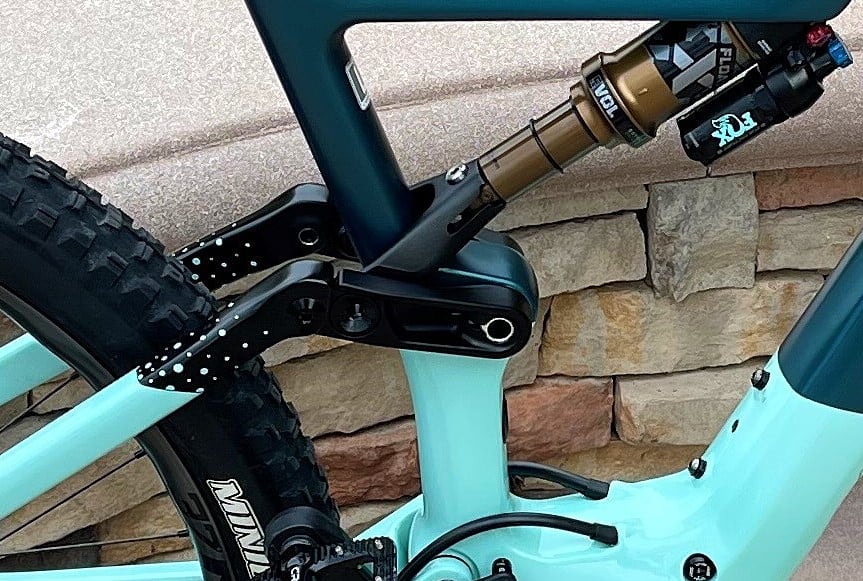

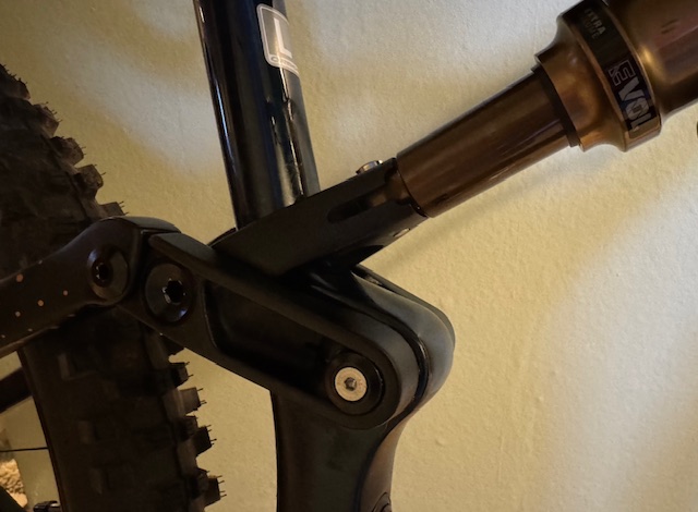

The 2020 thru 2022 Orbea Rise has two issues with the rear pivot linkage design. They are as follows:
1) Under hard use, the linkage arms will slip on the upper pivot axle and open up.
Note: Obea specifies a precise upper pivot linkage arm gap between the linkage arm and upper axle. Instructions can be found in the Orbea Rise Blue Book. A special linkage arm gap tool comes in the bike kit that Orbea provides when the bike is purchased. The tool is used to set the linkage arm gap.
2) The upper and lower pivot axles are not sealed. With use, exposure to dust, water, frequent bike washings, etc., the lubrication on the axles dries up/washes away. The pivot bearings themselves need to also be serviced, i.e. cleaned and new grease added.
If the linkage arm gap is not maintained or the axles are not lubricated, then an extremely annoying creaking will develop. The noise will sound similar to a creaking seapost or saddle. It will start off as a slight creak and eventually become unbearable. When the linkage arm slips, it will introduce play in the rear triangle assembly. The play can usually be felt when you rail the bike hard into or out of a corner. The bike will give off the sensation like the rear triangle is trying to wrap around you and not track straight.
If using the 2022 thru 2022, Rise under gentle trail conditions, there should not be any issues with linkage arm slippage. If the bike is exposed to a lot of water and or dust, then creaking will eventually occur and a pivot service will need to be performed. The 2023 and newer Orbea Rise has a modified linkage arm and I believe this fixed the slipping issue.
I wrote several technical articles on servicing the upper and lower pivot axles on the 2020 thru 2022 Rise model. At the time I wrote the articles, Orbea recommended the use of a retaining compond on the axle and linkage arm splines. The retaining compound will help prevent the linkage arms from slipping. However, if the retaining compound is applied too thickly, it will make removing the linkage arms for a future bearing service very difficult. If you do use the retaining compound, use it very sparingly, i.e. one drop.
I now recommend the use of Cascade Components, Orbea Rise Pre-Load kit for 2020-2022 models and no longer recommend the use of a retaining compound.

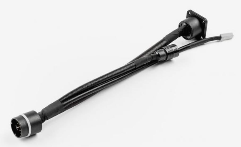

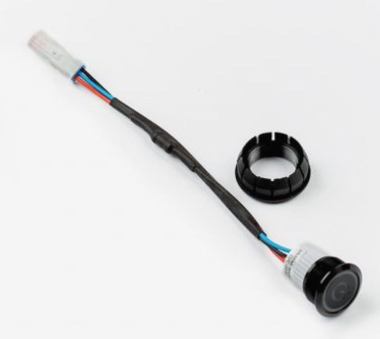

Orbea Rise - Power Switch Wiring Harness

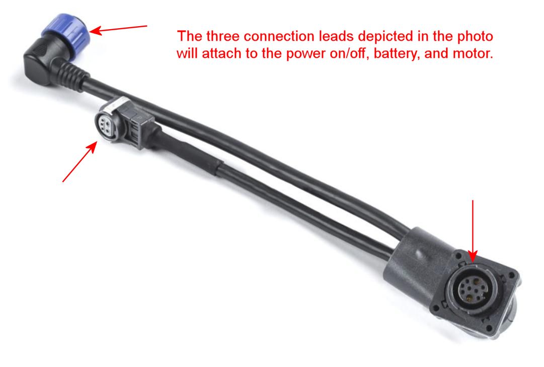

Main power supply harness to the battery and motor harness

I like to ride technical, rocky trails. At about 16 months of ownership, all of the pounding on the bike began to cause wiring issues. One moment the bike was good, the next it wasn't. When I removed the motor, I noticed some of the wiring had chaffed through the outer wiring loom cover and into the wires.
I ultimately ended up replacing both the main harness and the power switch harness and my connection issues with the battery went away. At the end of this message, I've included pictures of the two wiring harnesses that I replaced. The pictures were obtained from Orbea's parts website.
Thanks again. I am in two minds about replacing the main power supply harness to the battery and motor harness. I discovered yesterday that there is definitely a fault with the power switch wiring harness which I'm replacing. When I popped the switch out and held the wires behind it it would switch on but not when it was back in place. With the switch replacement being a two minute job it makes sense to do this first.
I fitted the new power button + cable this morning and now it's consistently switching on.
On your advice I've decided to replace the main power harness as well as the power switch harness. I ordered it today and plan to fit this at the same time as replacing the pivot bearings even although the bearings are still quite good . It makes sense to have these jobs done before the Spring .

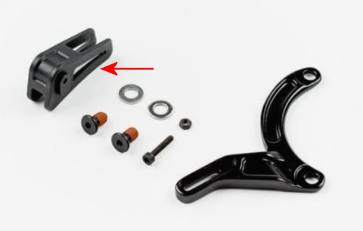

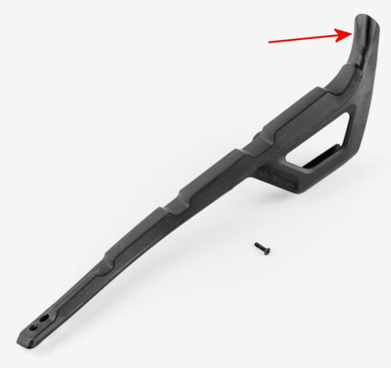

When you have a moment, check the rubber chain stay guard. Pay particular attention to the guard itself at the front, near the chain ring. I found that with enough miles, the chain will start to rub a hole through the rubber guard. If left unchecked, the chain will begin to eat into the chain stay.
If you tend to use the cassette's low gear (Big cog) frequently, the chain will rub on the inner arm on the chain guide. I found that eventually the inner guide arm will become paper thin and no longer support keeping the chain on the chain ring.
I mention the above with the thought that If you are placing an order for the main harness and the other parts are showing signs of wear, you may want to order them along with the main harness and save yourself future shipping charges and a wait for parts.

Bill,

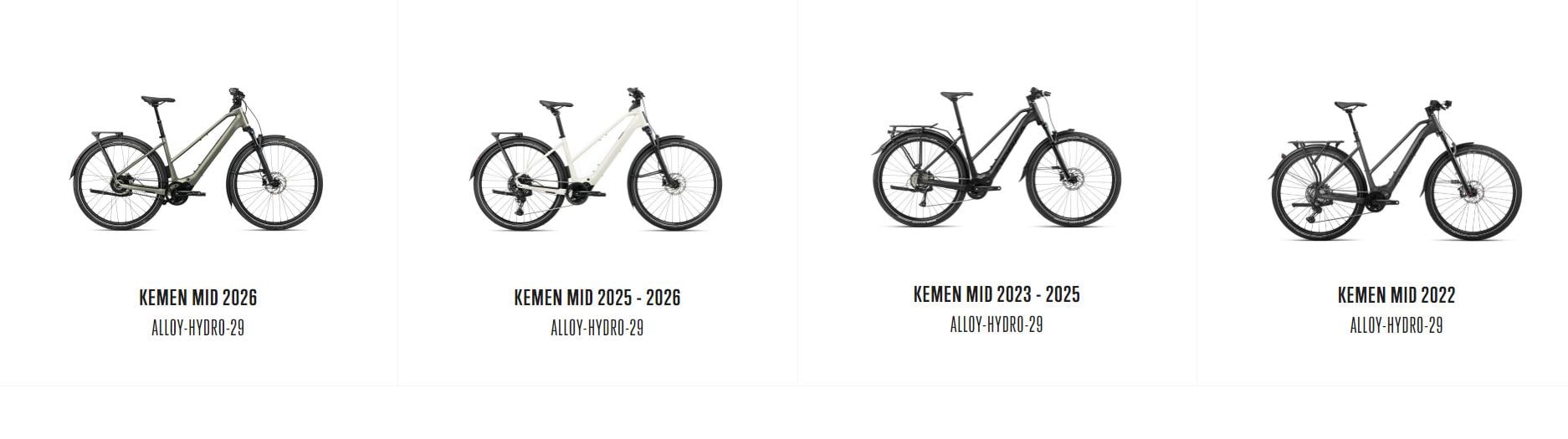

Thanks Ron. I have a Kemen ep6 powered ebike which is a derivative of the urrun and apparently it too has the closed system and electronics that Ron outlined in his post.
Here is the Shimano dealer manual for the EP6 drive system. The manual contains wiring information.
BAh30,

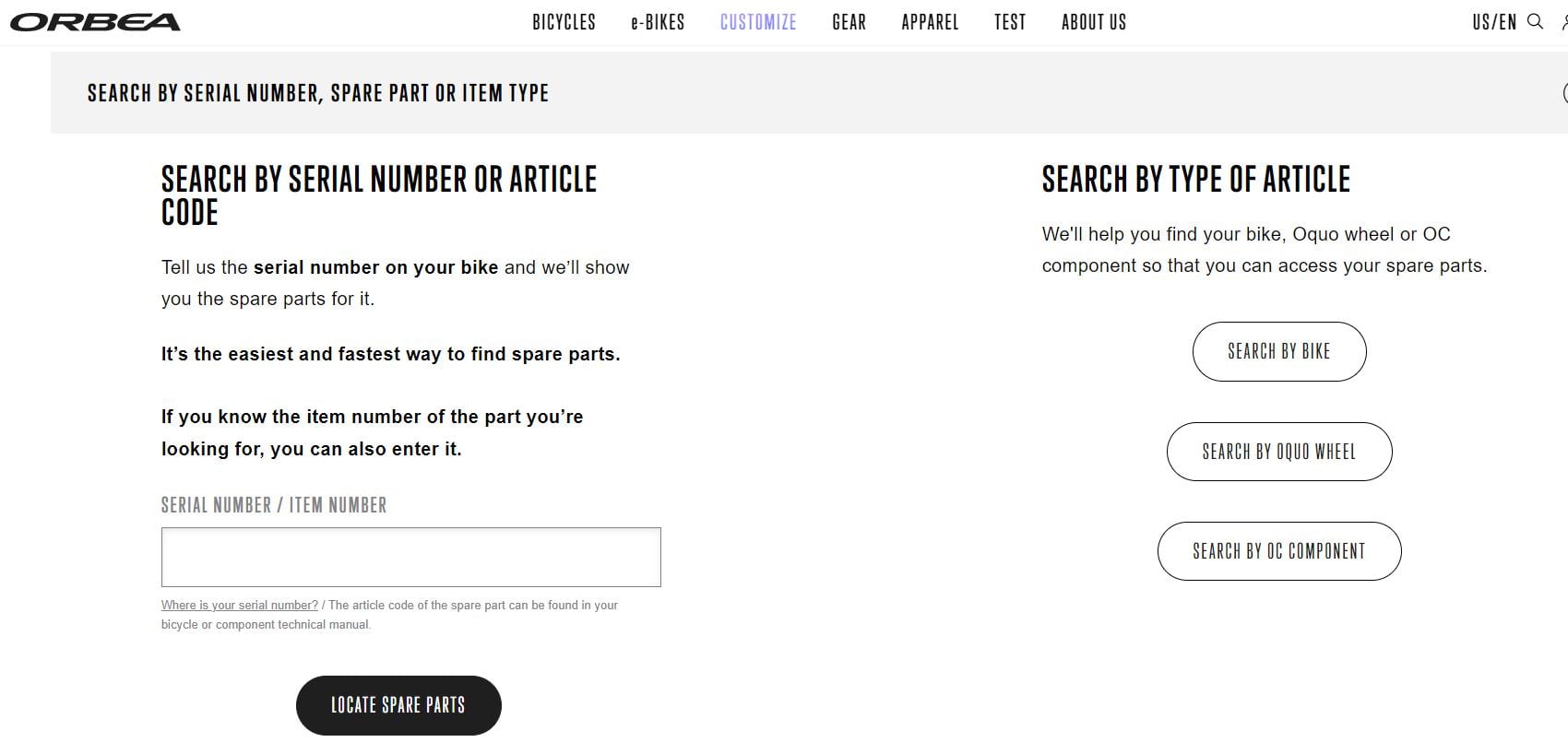

If you visit Orbea's website and click on the word "Gear" located on the top header bar, this will take you to a separate menu which lists various things including "Spare Parts."
Click on Spare Parts and this will take you to another screen which allows you to search for bike parts specific to your bike. You can search by bike model or frame serial number.
If you wish to perform a search for spare parts by bike, you'll need to know the year of manufacture and model of Kemen.
Select your bike and a new screen will open listing Kemen bikes by year and model.
I suggest checking the Spare Parts section as this will provide a picture of the exact wiring harness used by Orbea for your bike. Below is an example here is a wiring harness for the 2025-2026 Kemen Alloy Hydro Model.
Here are the tech articles I wrote:
The 2020 thru 2022 Orbea Rise uses a single linkage arm pinch bolt that does not provide sufficient clamping force to hold the linkage arm on the upper pivot axle. If your Rise has a rear pivot linkage the looks like this it will need a more frequent service than the newer models.
I ended up ordering the Cascade Components, Orbea Rise Pre-Load kit. Quite expensive ($88 incl postage) in the UK as I needed to order it from US.
Just fitted the preload kit yesterday and do notice the difference as the noise from the pivot has stopped. Good advice from Rod B.
