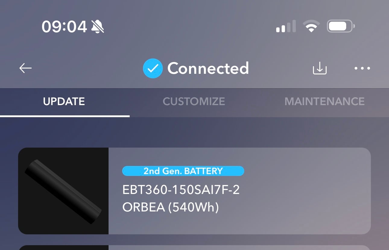

Hi All,
I've just picked up an Orbea Rise M-Team. I had ordered it with a 360wh battery in. However, when i look at the app it reports the following:
Is this just the Shimano app false reporting? I'm a little confused about the model number (which includes 360) but then the 540Wh stated after.
Anybody else had the same issue?
jab0rnal
Sep 20, 2023
13
I think I've worked out the model number: 360 refers to 36.0 volts, and the 150 is the amp hours (15.0) . So, 15 amp hours at 36 volts is 540wh.
Looks like I got an upgraded battery.

Thanks ChillyWilly, yeah i figured as much once I deciphered the model number after looking at a few other Phylion batteries online. Thanks for the reply.
