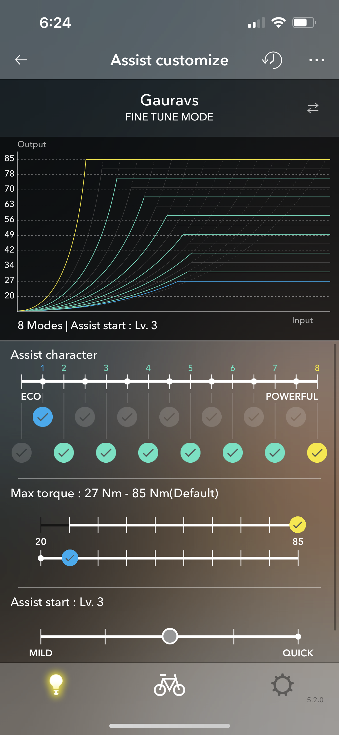

I bought 2023 Orbea Rise M-Team from an Orbea authorized dealer / LBS in SF Bay Area (California USA)
To my surprise the Shimano Steps E-Tube shows 85Nm as seen in the image below -
I haven't explored any backdoor hack or anything like that. This is the way the bike came.
And BTW the assist level indeed seems a lot at max level. Although I have no other frame of reference as this is my 1st bike of any kind in over 30-years.
I thought this eMTB is limited to 60Nm as it is stated in the official Orbea Specifications. Wonder what do other Rise owners have in theirs?

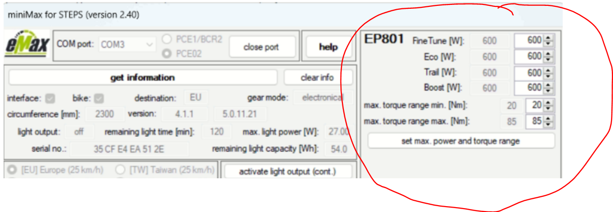

I'd say you got lucky and have the standard EP8 firmware on your motor - there have been a few similar reports of new bikes supplied that way. I requested mine to have the 85nm firmware loaded before delivery.
You can ask your dealer to put the 60nm firmware on if you prefer.

My Rise M10 from 2021 has 6000km on the odometer, and the motor was replaced by Shimano some weeks ago (internal sensor issue)
The new motor also came with full torque (85Nm), but the peak power was lower than the normal full torque motors (500watt)
So they have delivered a motor with full torque and lower peak power (350watt) - strange.
My current settings are:
eco: 250 watt, 30Nm, 32kmh (only emergency usage)
trail: 350 watt, 53Nm, 32kmh (normal usage)
boost: 450 watt, 70Nm, 32kmh (very rarely usage)

I just wish the software gave 4 or 5 power levels to choose rather than 3 over 2 modes which seems pointless.
The fine tune mode in the Shimano App lets you set all the way up to 15 levels. In one of my profile, I've enabled 8-levels as you can see in the original post. The other profile is the standard - Eco/Trail/Boost modes.

Y'day I asked my dealer how come the torque of 85Nm being available on my bike. Their response was that I'm one of the lucky ones who received one of those bikes that slipped w/o the firmware that restricts the motor to 60Nm. They also said that they inquired Orbea if they should reload the correct firmware on to rectify the issue on such bikes, if there is any warranty concern, but Orbea is being indifferent apparently.
Most of the time I ride at the lowest setting of 27Nm anyway, as I'm learning and building stamina. But it is good to have high power on tap for fun esp. with 540Wh internal battery and option to add the range extender, I won't have range concerns.

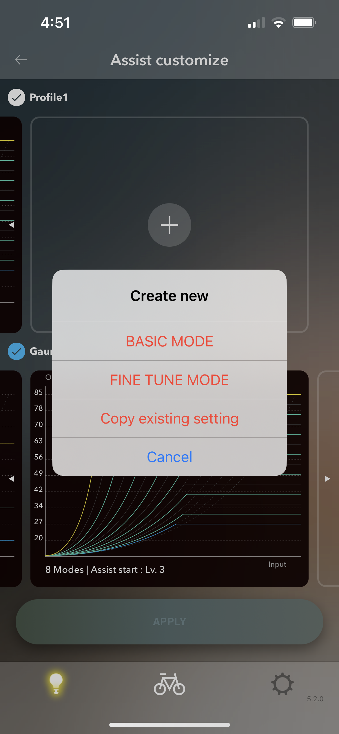

Which Shimano app is that? With Steps I can only see eco/trail/boost and mode 1 or 2.
TimC7
Ovine Assaulter
Apr 22, 2023
204
769
Shimano E-Tube Project App. The procedure is described here: si.shimano.com
Basically you create an assist profile with "Fine Tune Mode" . .
And do you then get the ability to select, say, 5 power levels on the up/down switch rather than eco/trail/boost without stopping and changing modes?
beerider
Oct 20, 2023
13
12
San Francisco Bay Area
That's right, once you have the so called "Fine Tune" profile selected then the assist levels switching is via the up/down switches.

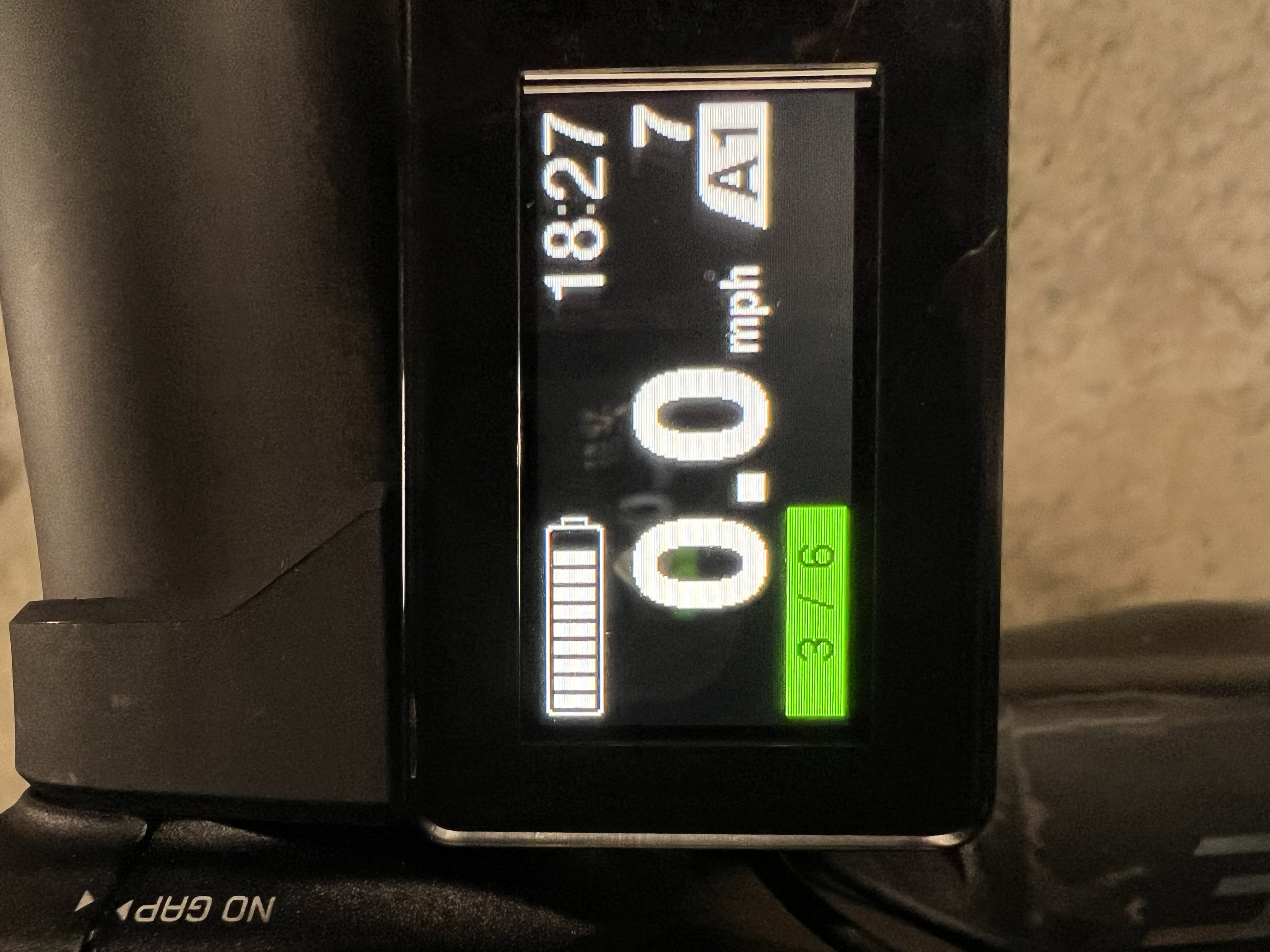

I think you are referring to "Profile 1" or "Profile 2". What I'm asking is since you've enabled 8 levels and normally there are only 3 "modes" (eco, trail, boost), how do you know which assist level of the 8 you are in while riding?
beerider
Oct 20, 2023
13
12
How do you see what mode you're in while riding? Not sure on 2023 models but on 2022 there are only 3 led colors for modes.
The lowest level gets the blue color, highest one yellow, and rest of the middle levels green color.
The specific level is shown as x/y in the small bike computer display as seen below in the green bar -
