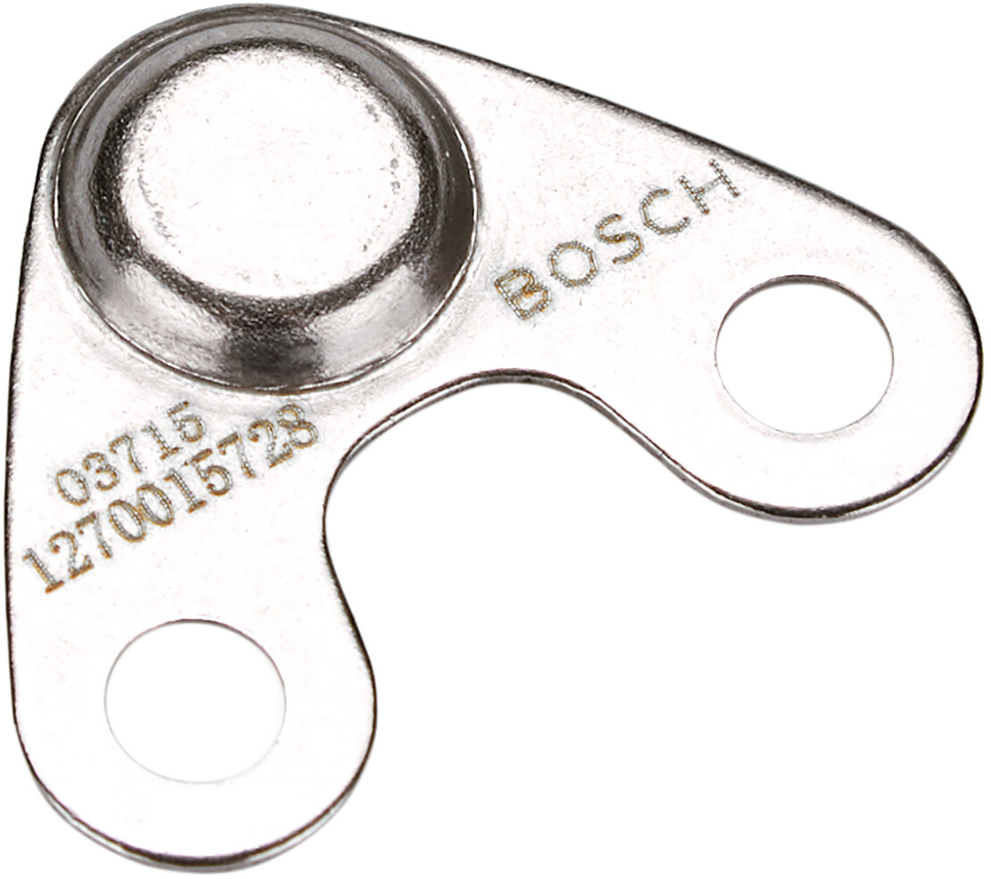

How about this ?
Tubby G
❤️‍🔥 Hot Stuff ❤️‍🔥
Dec 15, 2020
2,593
5,195
North Yorkshire
How about this ?
perfect thanks
I also emailed Orbea and asked the same question, they have confirmed that the X240000 is the correct type to use on the Rise with 6 bolt rotors 👊🏼

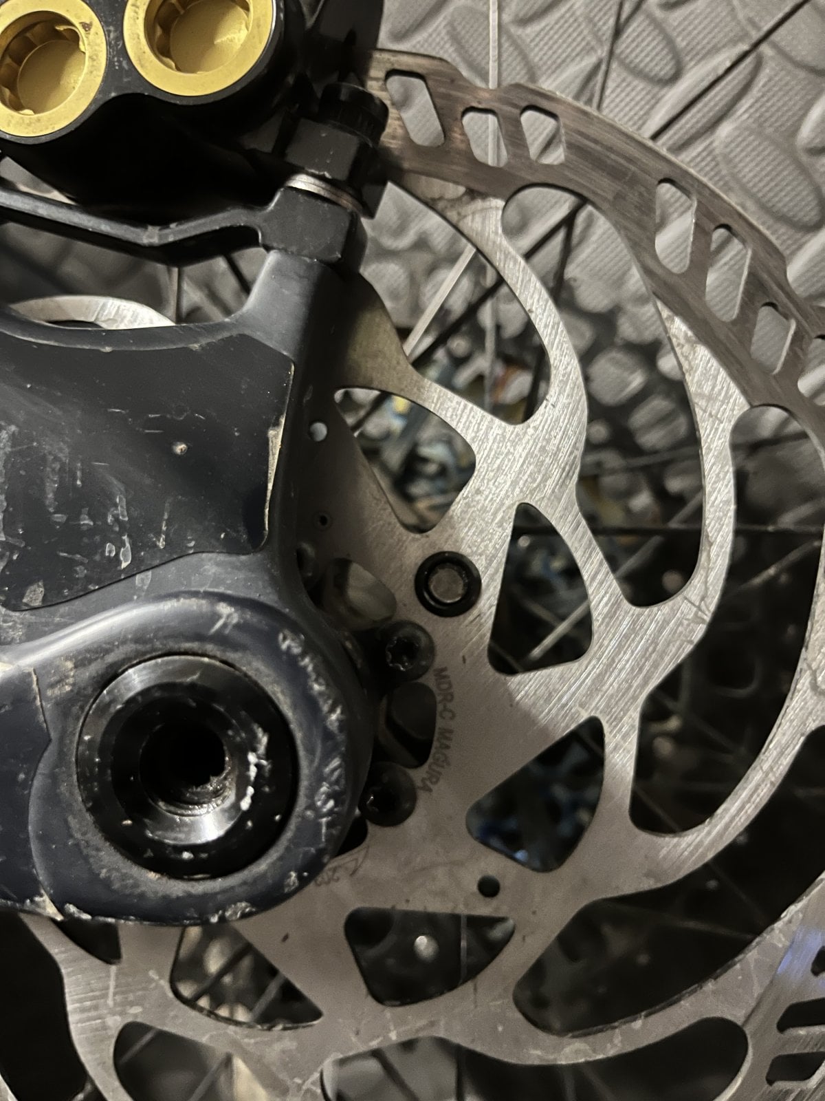

Howdy. I use a 10x2mm neodymium magnets. They are small and very powerful. I had some carbon wheels I wanted to use on my Rise and could not find a rotor with the sensor. I now run a 6 bolt rotor with a magnet placed where the sensor would be. I live in Lake Tahoe, great riding with lots of boulders. The magnet is still in place!
Good luck.

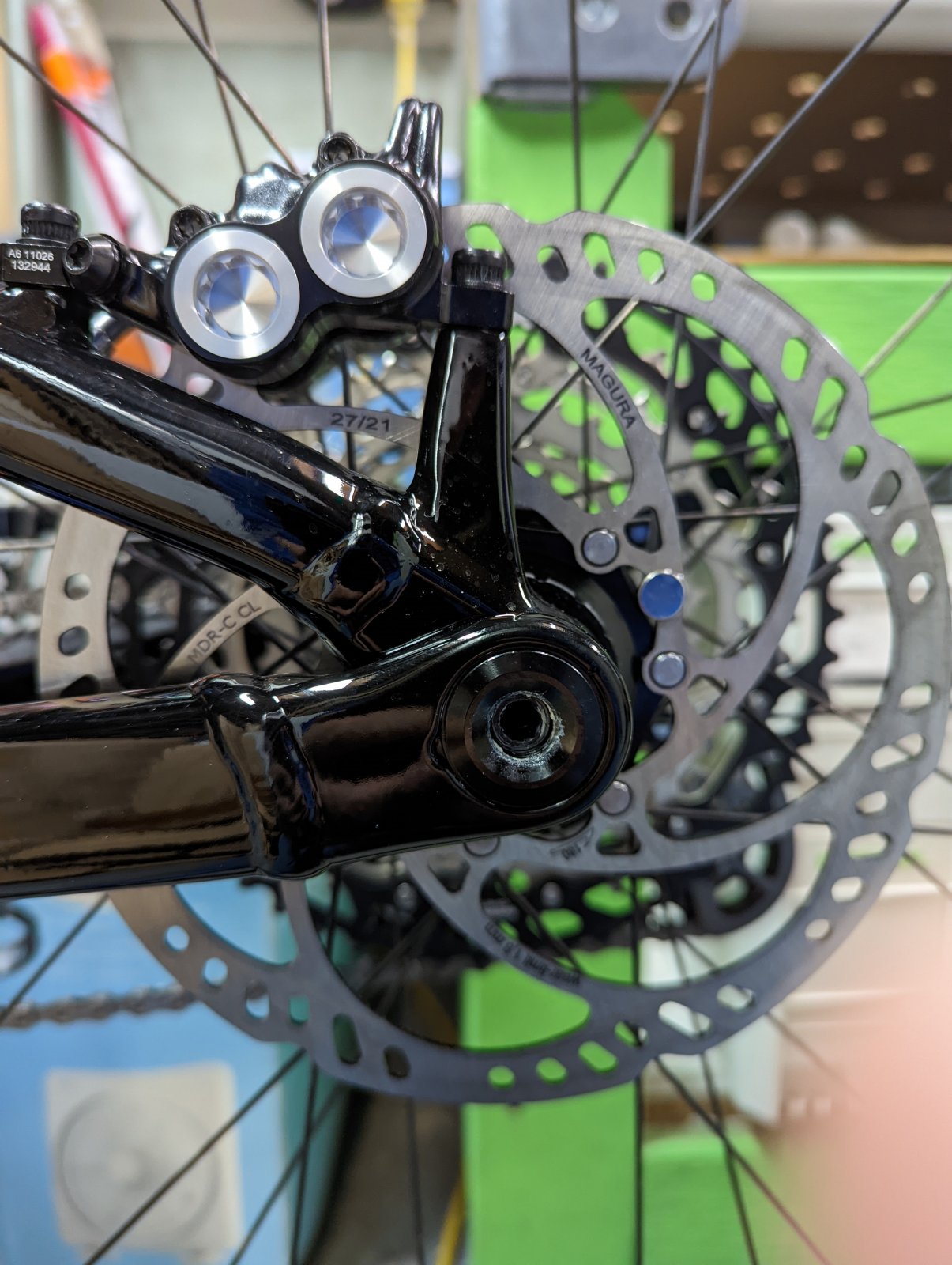

I also used a rare earth magnet (10mm diameter, 2mm thick) that I used araldite (epoxy) on my Magura centrelock rotors. You can see it at the 2 o'clock position in the photo. Much cheaper than other brand options.
So long as the magnet triggers the sensor you are OK, as it is just measuring a full revolution (and not an exact distance) that corresponds to the general outside diameter of a 29" tyre.
As for the question around the definition of a floating rotor I think it is just that the carrier portion of the disc (that bolts onto the axle) is not attached rigidly to the outer braking surface. Usually it is achieved by some design that allows the outer disc to be clamped to the inner carrier) in a non-rigid fashion.

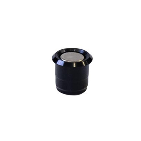

I use one of these Magura magnets in my Magura 6 bolt rotor, they fit though the hole & held in place, work great on the Rise

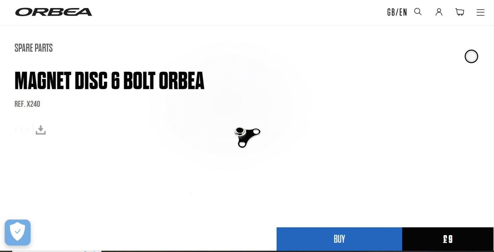

Tubby,
Here is the part link to Orbea's UK website for the magnet adapter mentioned in the above posts.

Thanks Rod. Orbea sent me that link via email too and it turns out it is exactly the same Bosch magnet as mentioned in the first reply (#2) in this thread
It typically takes about two to three weeks to get Rise parts from Orbea in Spain. Maybe source the Bosch magnet locally so you don't have to wait?
