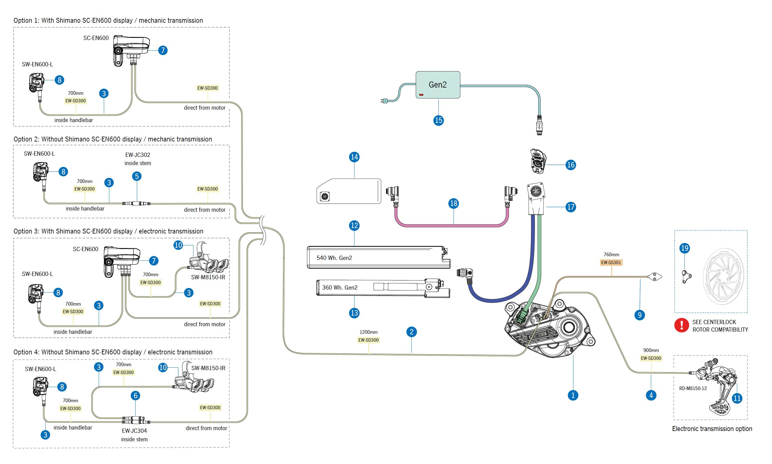

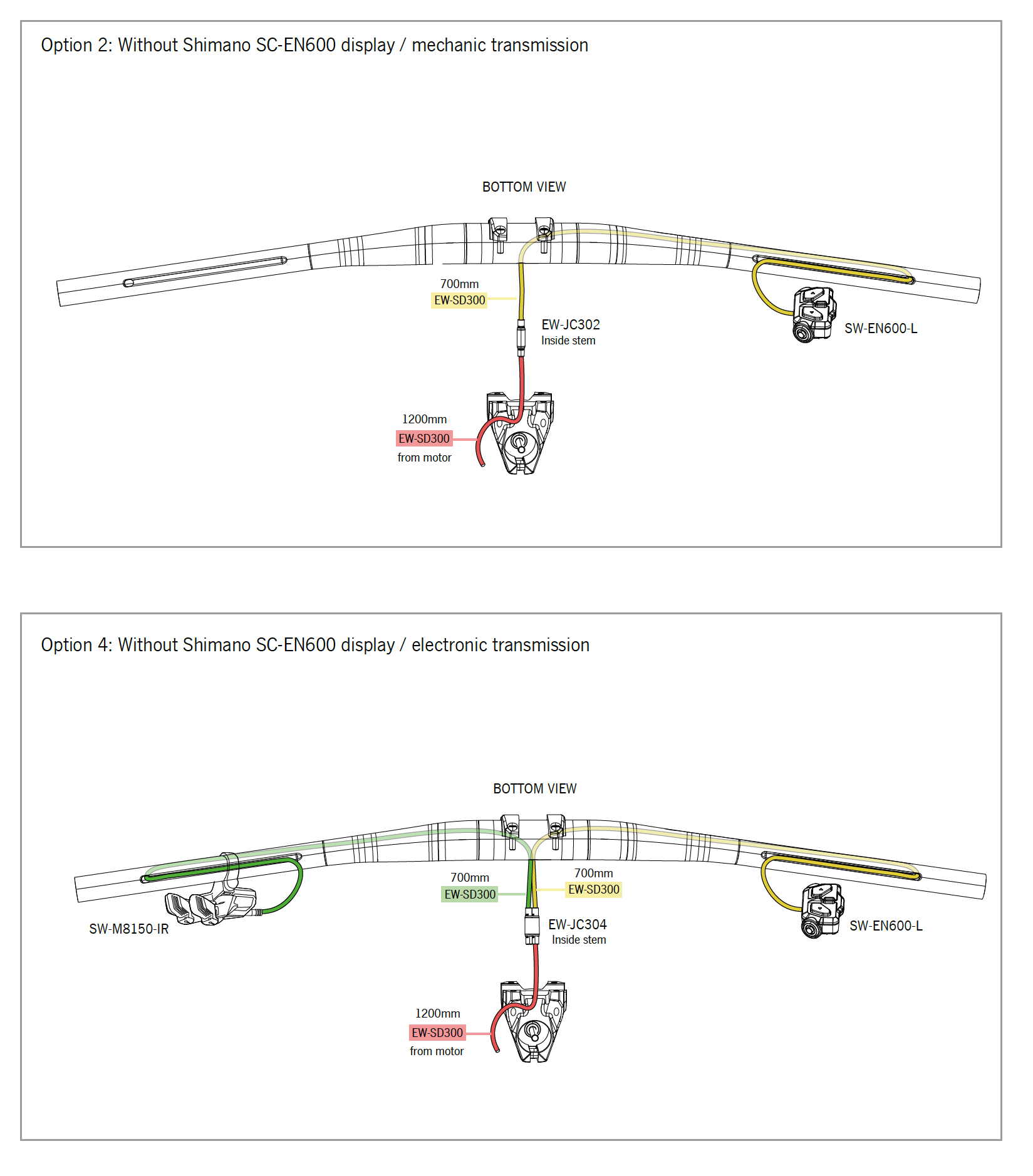

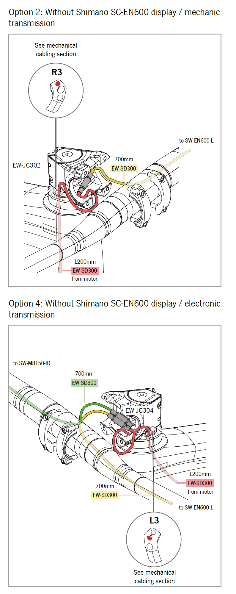

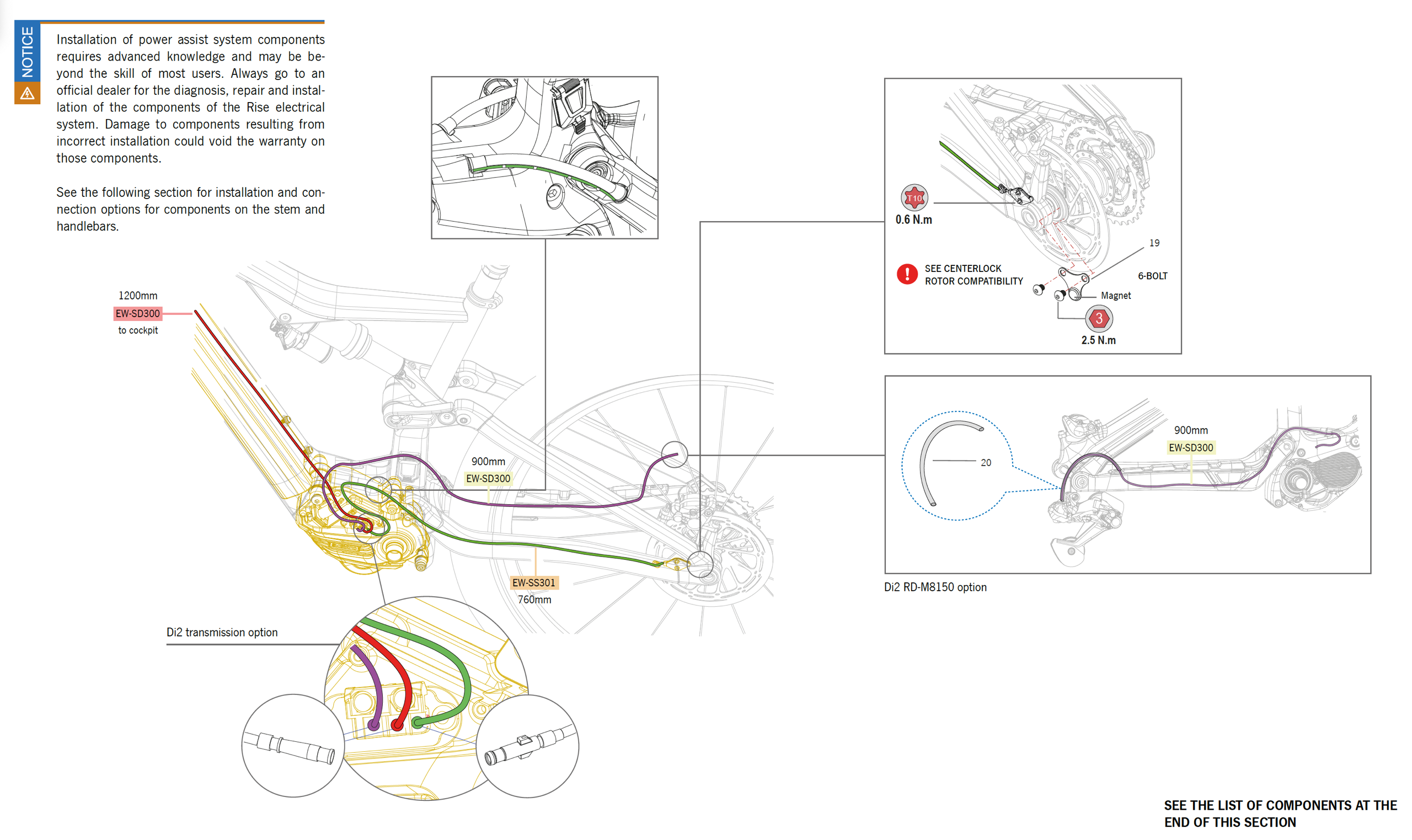

Hi Ron, I have an Orbea Rise M10 and want to install the xt di2 system. I don’t know much about it. Would you please tell me what parts I need. How is the di2 wired into the battery in the bike? Thanks.
@Cronkie I have some info for you. I did this on my 2023 M20 and found lots of great info in the Orbea Blue Paper that you can download from the Orbea website. You can look at the diagrams and compare those that apply to your bike with the ones for a bike that comes with Di2 to see the differences. I've attached screenshots of the diagrams that were useful to me, but if you have one of the newer/older bikes there may be some differences, so probably best to download the Blue Paper for your specific bike range.
I got the following parts:
Derailleur: RD-M8150-12
Shifter switch: SW-M8150-IR
Di2 junction box (goes inside stem): EW-JC304
Di2 cable (from shifter switch to junction box): EW-SD300 700mm
Di2 cable (from motor to derailleur): EW-SD300 900mm
I had it installed at an Orbea dealer, and they had to contact Shimano to enable activation of the derailleur.
