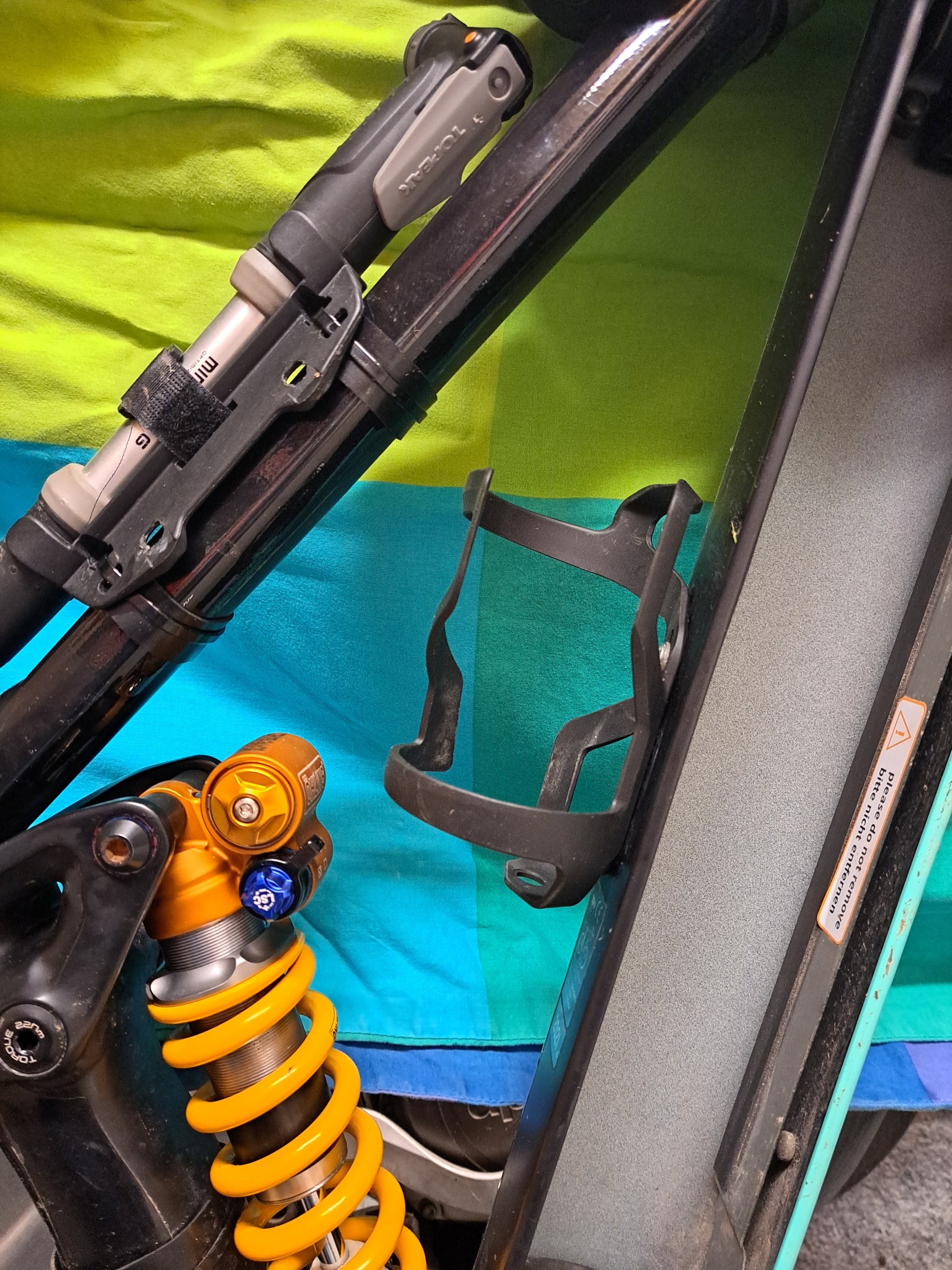

After fitting the Ohlins TTX22m.2 shock the bottle holder needed to be higher in the frame and closer to the down tube to hold even a 600ml bottle.
So I bought a Specialized Zee Cage II then drilled out 11mm holes so that the holder would fit with bottle as high up as practical. Fitted the 11mm holes in the cage over the 10mm frame fixing points, then used a couple of short low profile bolts with washers. The Ohlins coil shock just clears the bottle when compressed.
Edit: with the bottle as high up as practical.
