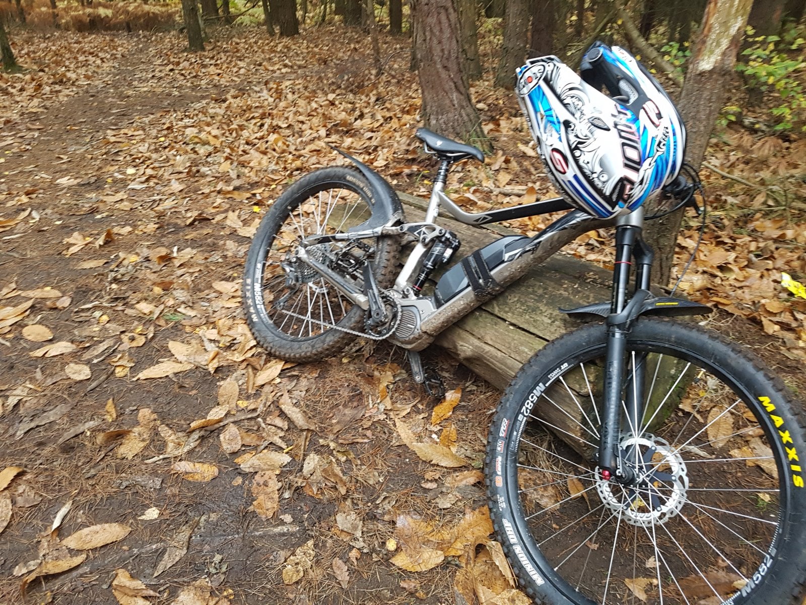

here is my e800. upgrades include-
FAST Yari damper upgrade
170mm lyric damper rod
Luftkappe air piston
DT swiss wheels, rims are 40mm ID for my 2.8" Maxxis tyres, best upgrade!
Magura calipers with Shimano Saint levers
203mm discs front and rear
I also have some 165mm cranks in the garage to be fitted
aim to also convert the Yari fork to coil in the new year.
Super Delux RC3 shock
Reverb post
Renthal bars
really happy with it. once I've got a DH run sorted when riding my V10, I can ride the same DH run on the Merida. but also ride back up! love it!
I've got that wrong, best upgrade was the velcro straps to hold the battery solid relative to the frame, I find that if I case a jump (without the straps fitted) the Steps motor would switch off. Never had that issue with the straps fitted. I know I could adjust the battery clamps but the battery seems well adjusted

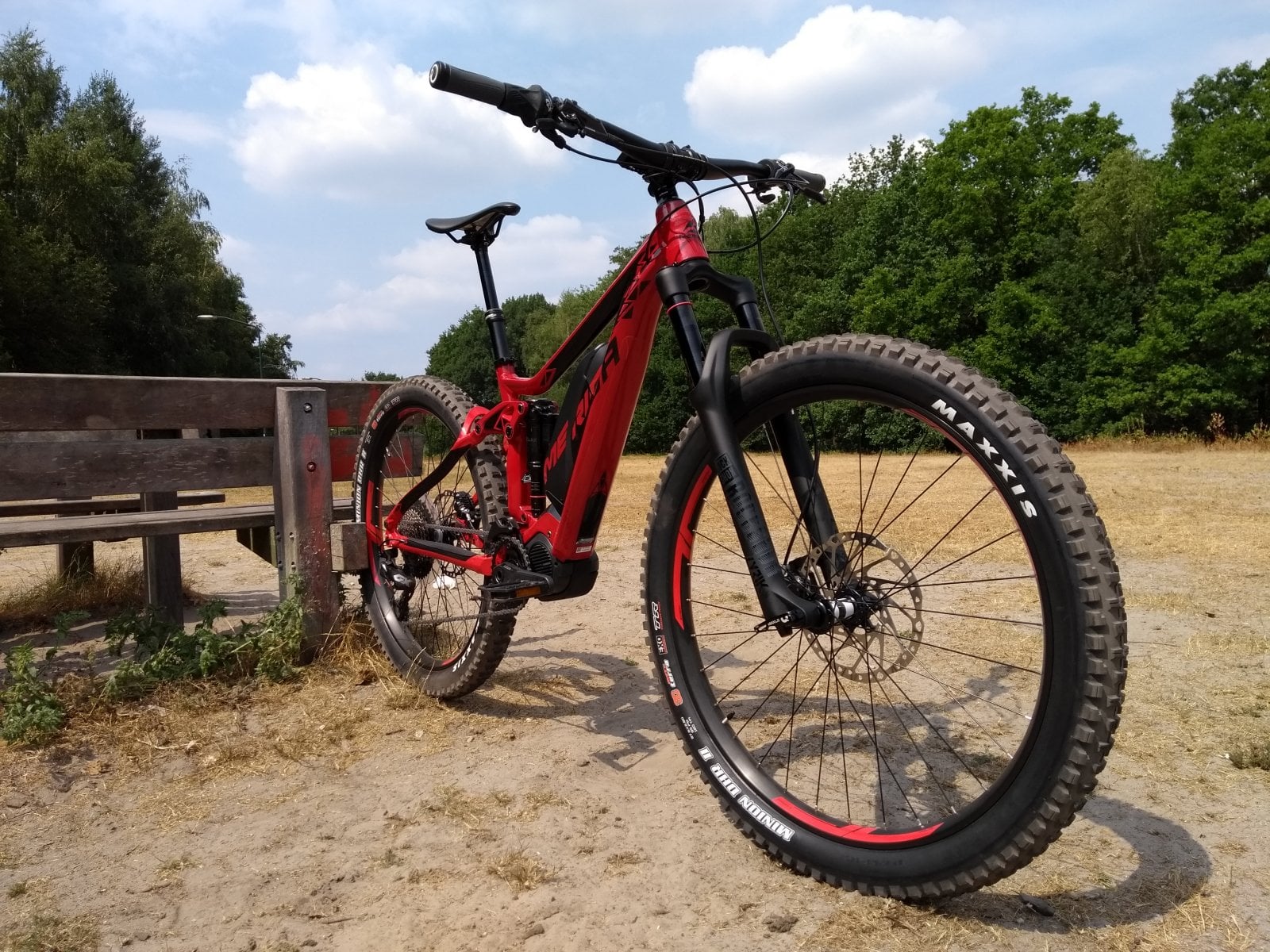

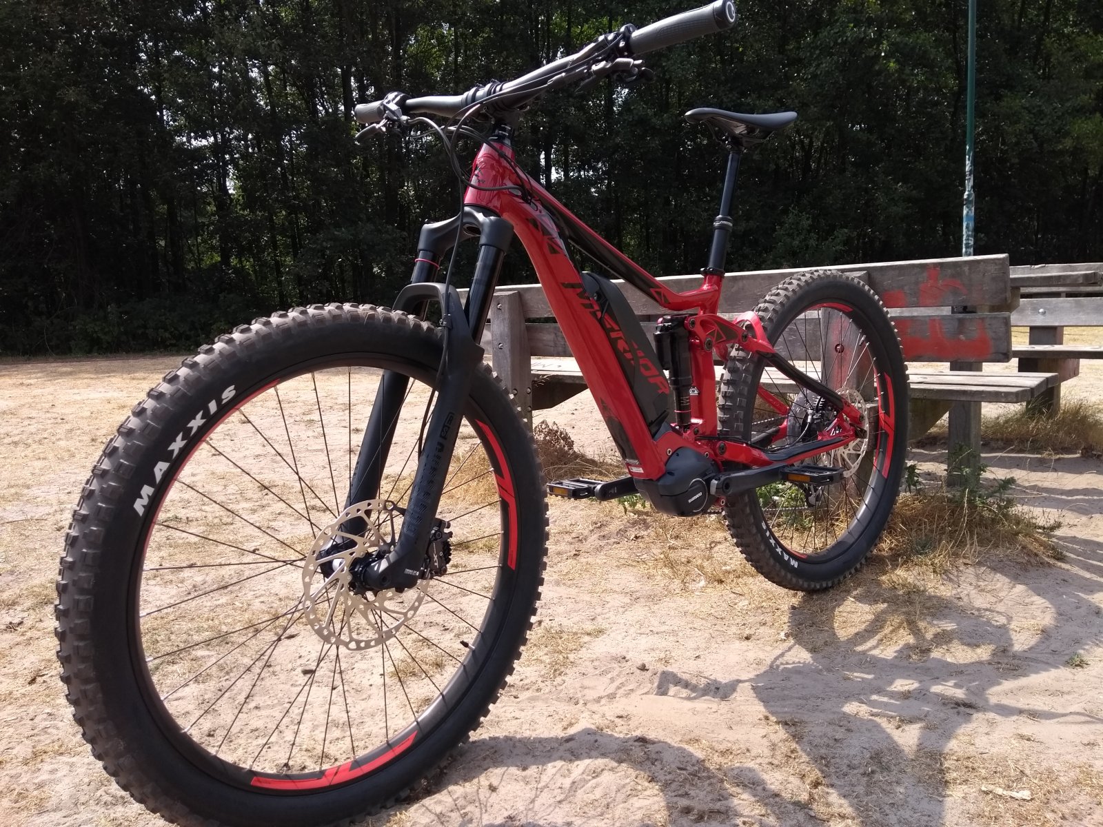

Got my 900 (size S) last week and did some changes/upgrades before the first ride.

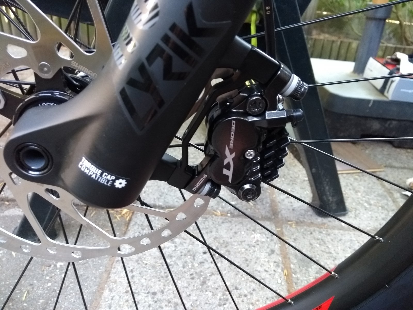

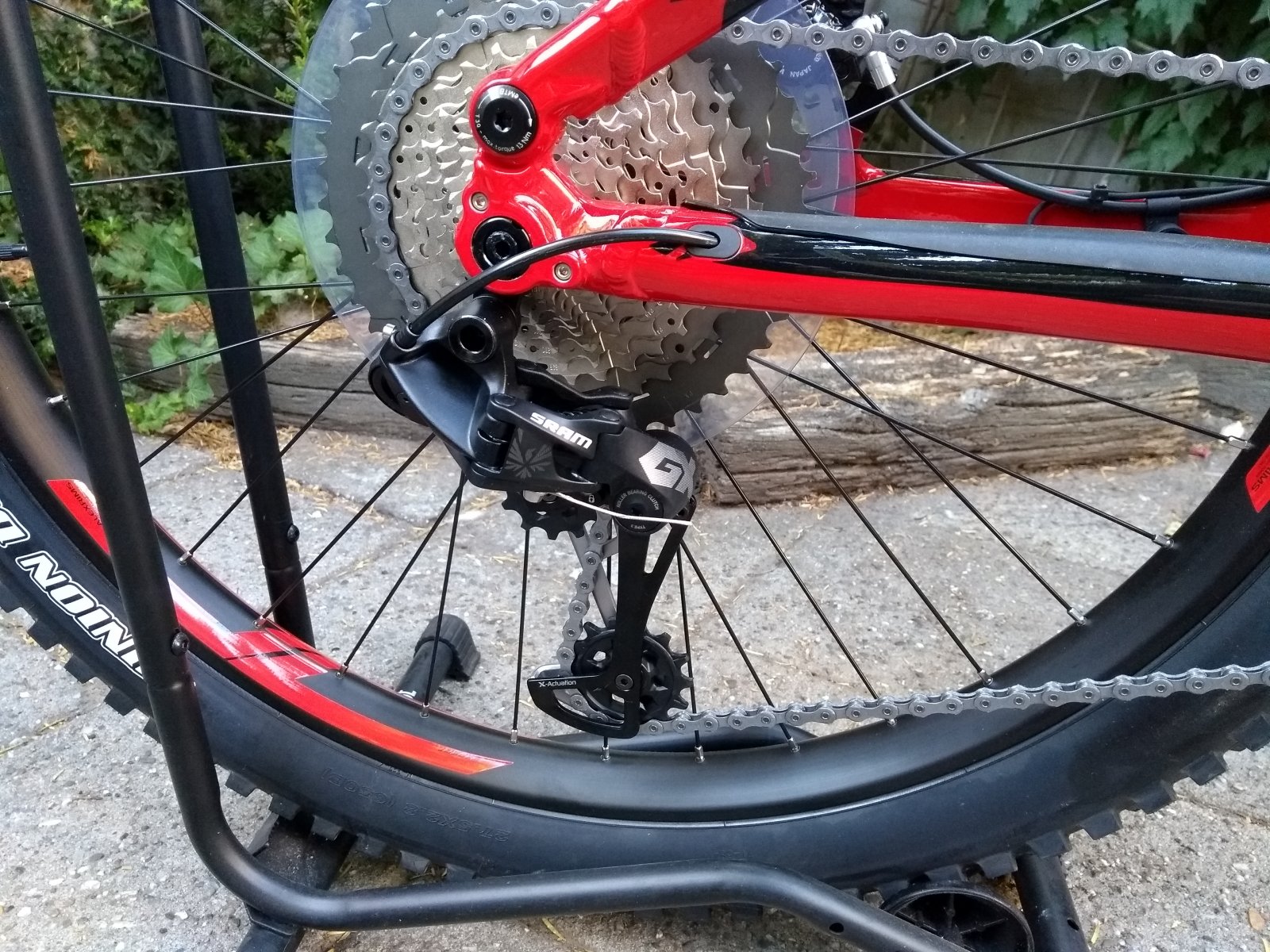

Changed the shifting to gripshift (and a Sram derailleur ofcourse) because my thumb doesn't like triggers. And I switched the XT calipers for the new four-pot calipers.
I also switched the hoses from left to right vice versa, so now the front brake is on the right hand side (in Europe bikes are setup with the front brake on the left hand side). Because the hose enters the frame on the left side the routing is not ideal now, maybe I'll change that some day but I think that needs removing the motor... :(View attachment 3271
Cable end cap coming soon ;)
Yesterday I did a short first testride and I'm sure I'm going to have a lot of fun with this bike...
Ofcourse the extra weight takes some getting used to, but the bike feels very well balanced. Did some small jumps, tight turns and it handles lighter than you'd expect.
I'm already getting the feel for the way the motor kicks in, looking forward to getting the bike on some "real trails" (which unfortunately are not very close to my house). Next step is finetuning the suspension, experimenting with tire pressure and putting on XT pedals (on the pics are the plastic ones that came with the bike).
And as a bonus, the Merida really is a pretty bike...
When changing over to the 4 pot calipers, did you have to use new hoses as well or do they just go on the end of the existing brake hose? I’m looking at getting the 900 and this is also and upgrade I’d be interested in doing.
the 900 bikes have the banyo ends , so when you get the new calipers eg XT or saint make sure you get banyo bolts to suit
