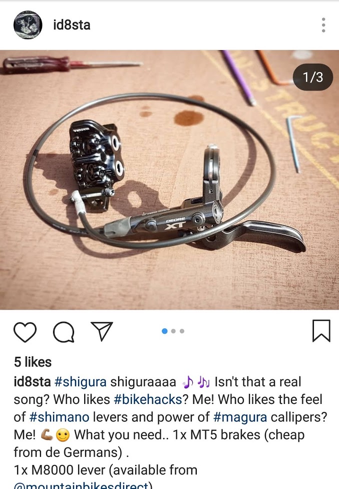

Do you mean lever (grips)? Shimano levers are the all the same. I've tried nearly all combinations on Shimano and there's no difference. What I have discovered though is that I prefer to pair Shimano levers with Magura calipers... Shigura!
That's right, al Shimano levers are compatible, even the old ones (before they started to use the servo wave on hydraulic levers).
Never tried the Shigura option, I'm happy with the Shimano's as they come ;)

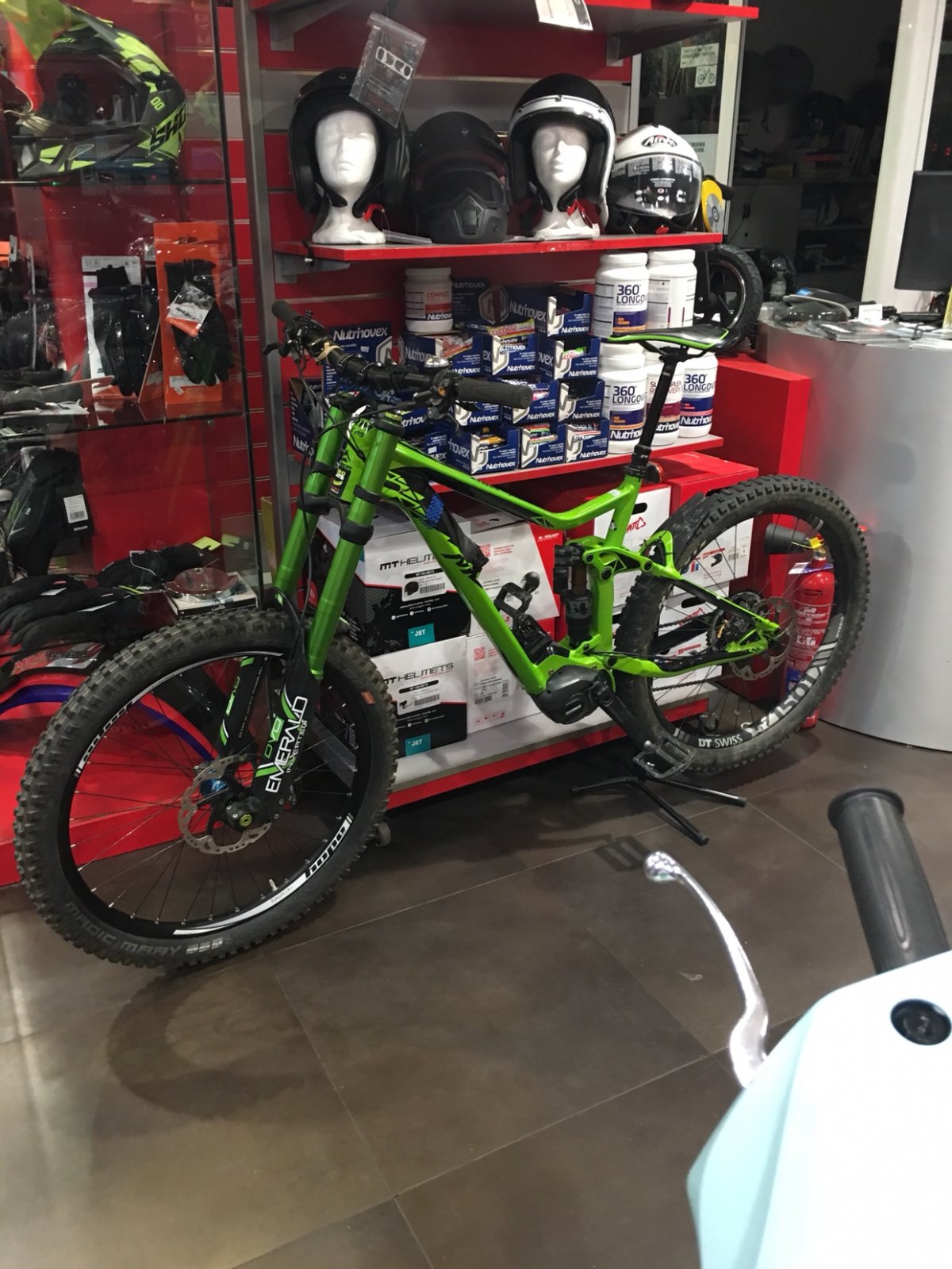

this is my stock eonesixty just swaped to saint brakes this bike is so much funn after braking two one twenty 9.8000 :sneaky::sneaky: did a test ride and was hooked
