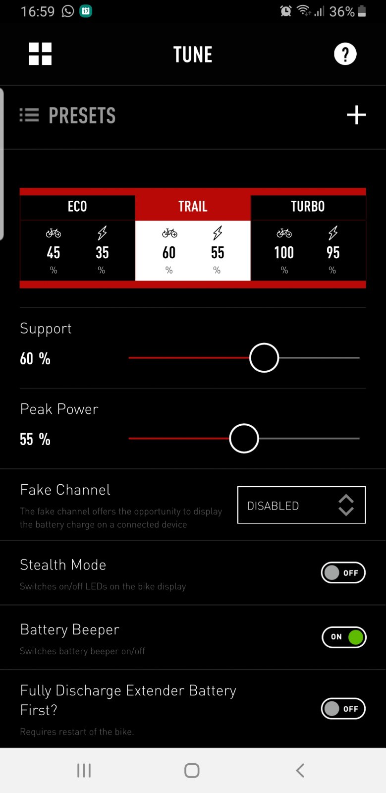

If I've attached the right files, you'll hopefully see my support settings (to suit my injuries/disability), my ride distances from today, and the remaining charge when I got home. Of this, approximately 18-19kms was offroad, on rough moorland, granite bedrock, and woodland singletrack, using mainly Eco and Trail. The rest is on roads using Turbo. I took my range extender, turns out I didn't actually need to! Unbelievable range on this bike. When all the PR blurb was released, I genuinely thought Spesh had oversold it. If anything they undersold it by quite some margin.

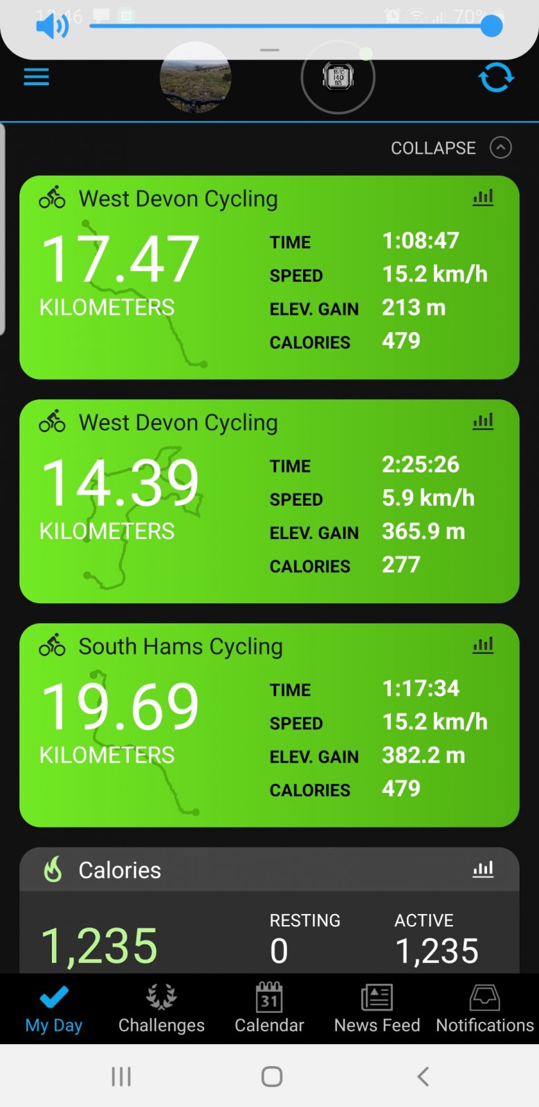

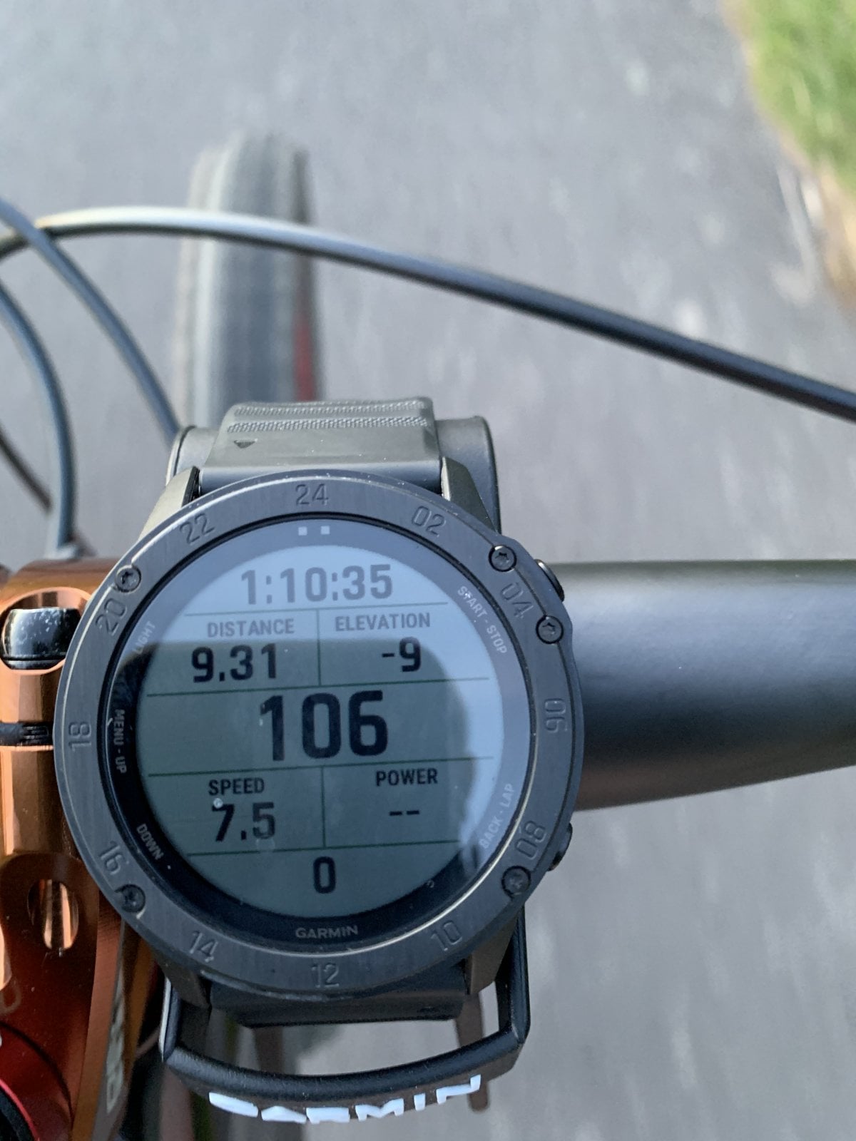

You're making me feel bad, 479 calories in 1:17! I only burned 213 calories today in 1:08 running in Eco, maybe it's my elevation gain of 10 meters, all on pavement (Florida coastal area). ;)
Where in Florida are you. I’m in Jupiter. Not many sLS here.
thats not true....Use a chest strap heart-rate monitors for calories with your Garmin. And your right body wheigt is also important.
I don’t agree. And there’s a significant difference between my specialized calories and Garmin! Garmin is calculating based off a normal bike. it’s like hiking and hiking with someone pulling you. I could just be out of shape and someone pulling me with the same heart rate of me doing it alone and in shape.

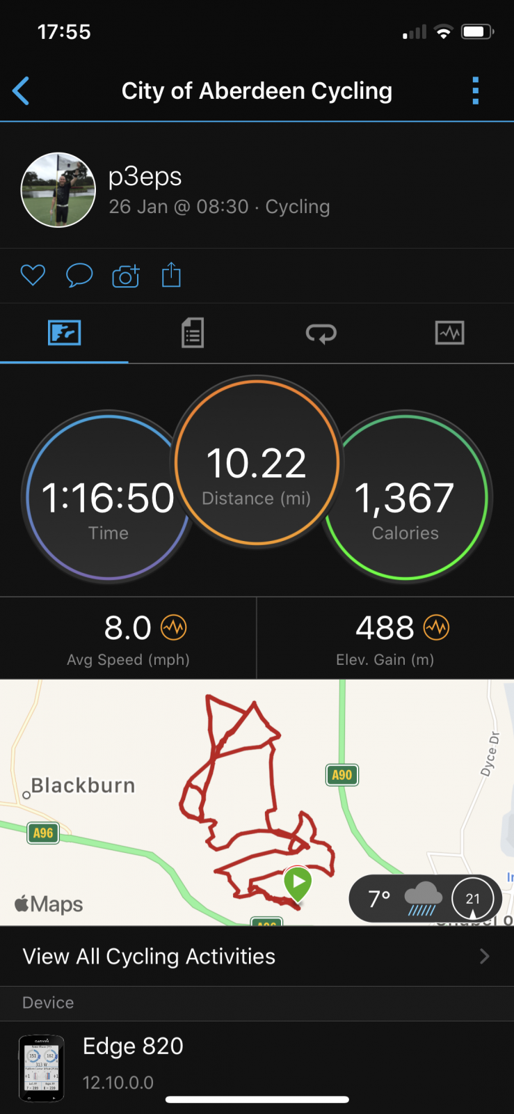

attached are the same rides from Garmin and specialized. Difference of about 300 cal.
I think you are right. The difference however is not fully matching the power consumption of the battery (128wH equals to ~110kcal).
Any calculation is always approximate and based on multiple factors. When I play badminton with my friend - we are pretty equally average players - I burn about 60-70% more calories than him, while I do weight about 40% more than him and we are both using Apple Watch.
You have to use specialized apps calculation for calories. Garmin thinks you’re on a normal bike.
Garmin knows I’m on an ebike. I picked the ebike category, which is why my ride is titled ebike. If I use my regular bike, it doesn’t say ebike - or display the ebike battery etc.

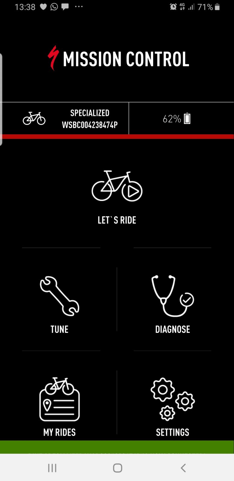

I only use the Spesh app for setting the Eco / Trail / Turbo values. I don’t use it for logging my rides. I also don’t pair my HRM with my phone, as it seems to randomly disconnect from the Garmin if I have it paired with my phone too.
I’m tempted to try BLEvo though, as it gets some good reviews.

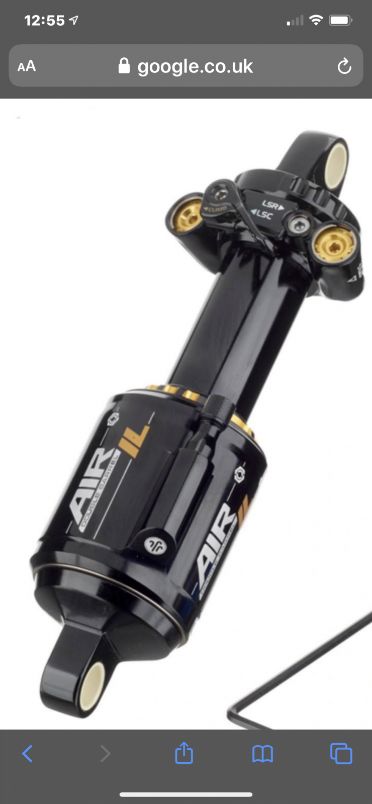

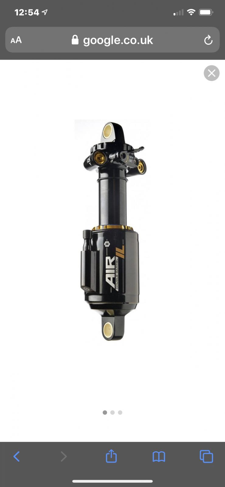

I Ordered the Cane Creek DBair IL from them yesterday ,, couldnt pass it up for £333 shipped , tuned to my liking with added hardware .
I’ll look forward to your thoughts on it then - and how it compares to your Super Deluxe coil.
That is a very good price! I’m almost tempted just to go for it and give it a try!

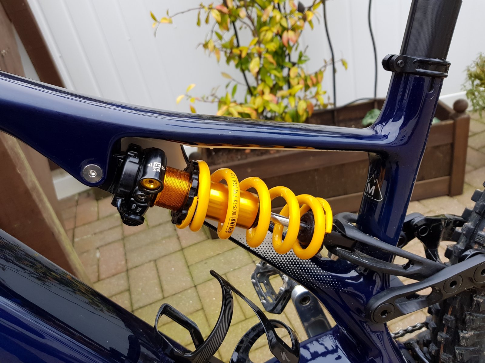

Its only a temp shock for me so when ive lost a about 15kg i can put my coil back on .. but with the weight saving from the air shock and if l like it then i might not go back to the coil . massive adjustments on the cane creek , J-tech also turn the air can to an angle so the can is at the bottom flip chip and the adjustments and lever is at the top .. i also went for the 55mm stroke .. ordered the 52.5 stumpjumper version but put in comments to uprade to 55mm as instructed by james via email .

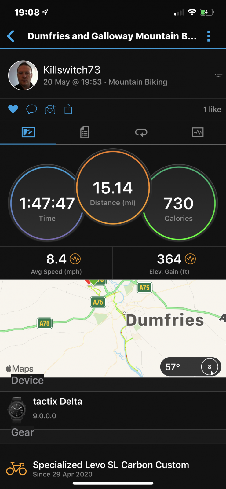

I seem to average about 500 cal/hr of riding on the SL. It's up from about 300 or so on the Kenevo. Obviously support settings, weight, fitness all factor into that. In general, I am at about 170-180 weighted average watts

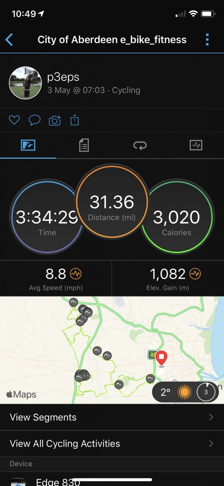

Just for comparison, here’s a pre ebike ride of mine. If I search through my Garmin history, I could probably find many 2000+ calorie rides last year on my regular MTB.
Much less distance, and time - but the calories per hour are probably more.
I’m about 185kg kitted you, but have a very high active heart rate - which is why I burn lots of calories.
I don’t trust the Specialized app at all for calories. Did today 4h ride with average HR of 147. My Apple Watch gave me little short of 1500 active calories (total 2000) and Mission Control showed less than 900. That said, I did not have HR linked to MC.

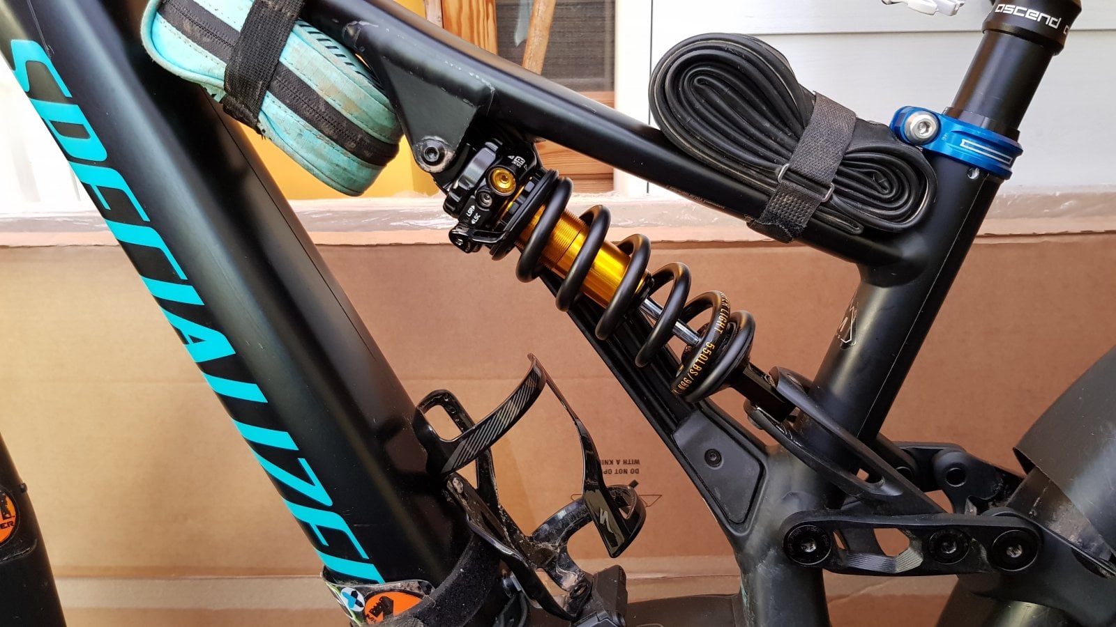

You can change the eyelet alignment yourself, you just have to grab the air can and twist. The shaft is free to rotate, so you can realign the eyelets or misalign them at will.
Yes all air cans can be .. not the adjustment side with all the controls as it’s parallel to the eyelet . They alter this in the workshop for it to fit until the frame as the a dual (gold screws) have to be turned to stop it from hitting the frame as it’s too wide . See pic the shaft side eyelet can’t be twisted so it moves the hsc/lsc duals , the 90 degree angle has to be done in shop .. this is what I was told and I believe them .. the air can side can’t go on top eyelet as it’s to big .
The DBIL Coil didn't need any workshop alterations to fit, I was able to adjust it myself. Why is the air shock different?
