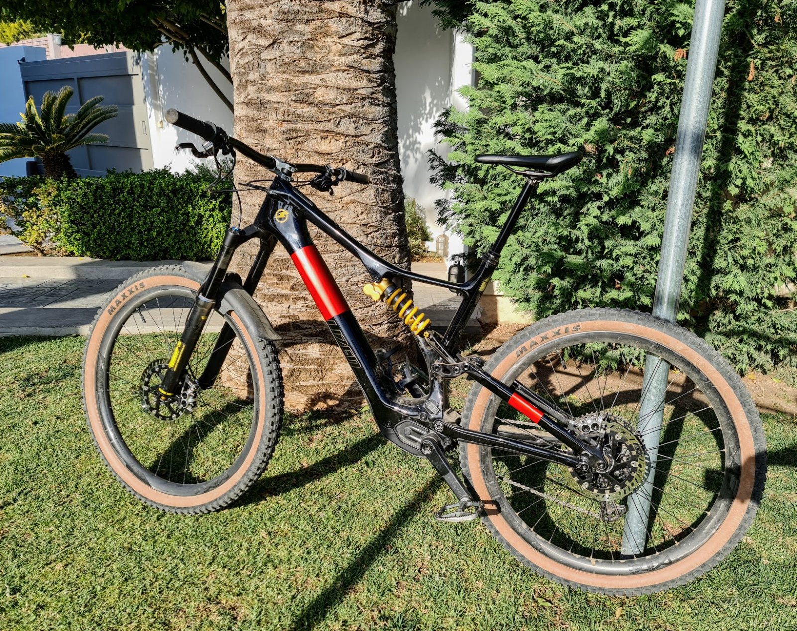

Latest round of mods just completed.
16.45kg in XL with pedals and no- compromise components.
Impressive! What have you got on there then?

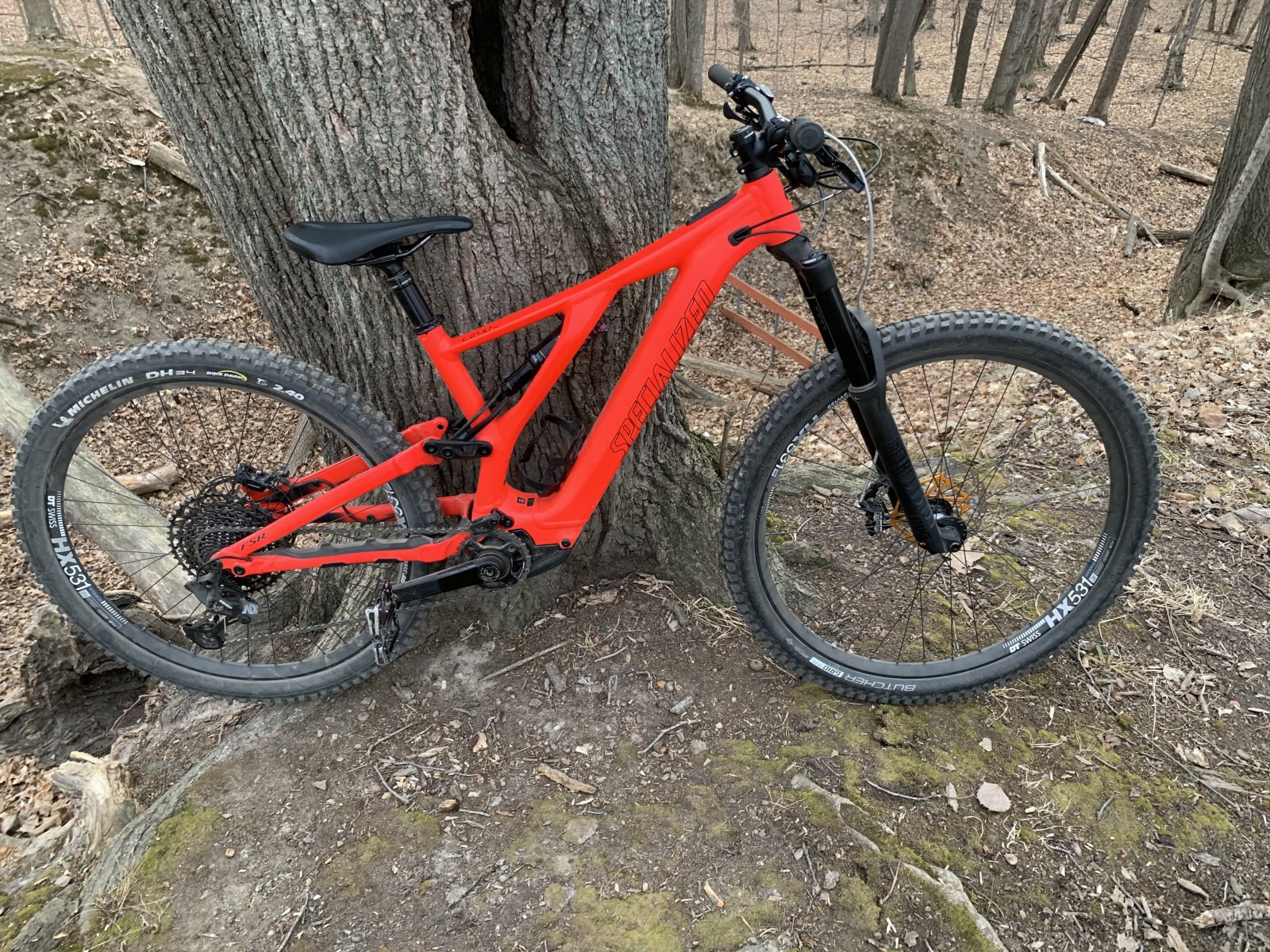

Built up some 36h eMullet wheels using DT Swiss's beefed up e-bike components.
Stiffer wheels and fork (Pike) made a big difference in rough corners and I love how it handles as a mullet.

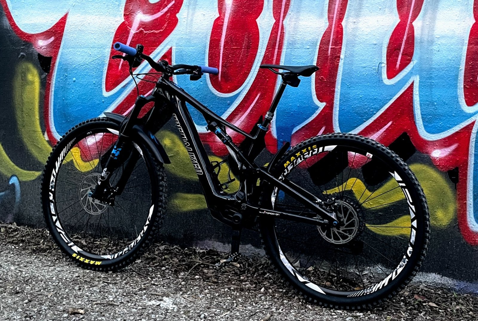

I have setup my SL as a mullet as well but am not able to quantify exactly what that change has done to the bike other than the occasional BB hit. I see that many of the new bikes are coming out in mullet configurations but does that require a shorter chain stay to make a difference? I am also not understanding how a 27.5 front wheel would be of any benefit?
Quicker steering, less weight. Also allows tire rotation. ;)

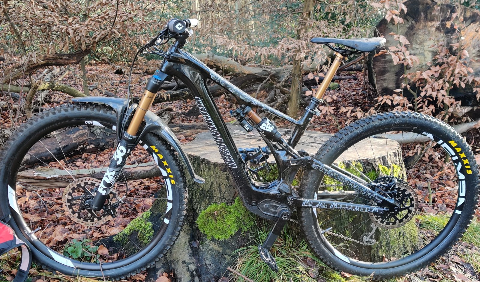

In the last few weeks it was still cold in Switzerland and I was looking for a little lockdown EMTB project. So I bought a couple of older Roval Traverse SL 142+ carbon wheels from 2014 to use as XC wheels on my Levo SL Expert. In order for these to meet my requirements, I carried out the following work.
- Roval Boost Upgrade Kit conversion
- New SRAM brake discs front 200mm / rear 180mm
- New Maxxis Shorty tires 29x2.3
- New bearings for the front and rear wheels
- 54t ratchet upgrade
- New aluminum ring nut
- XD Freehub
- SRAM Eagle XX1 10-52 cassette
- New DT Swiss AeroLite knife spokes at the rear and newly centered on Boost.
- New tubeless rim tape front / rear plus tubeless valves
- New CAMO decals (unfortunately the old ones cannot be removed, but you can hardly see them)
- Small items (seals, screws, spacers etc.)
Somehow the bike feels even more nimble and weighs 16.85 KG in the photo.

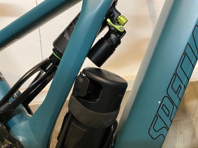

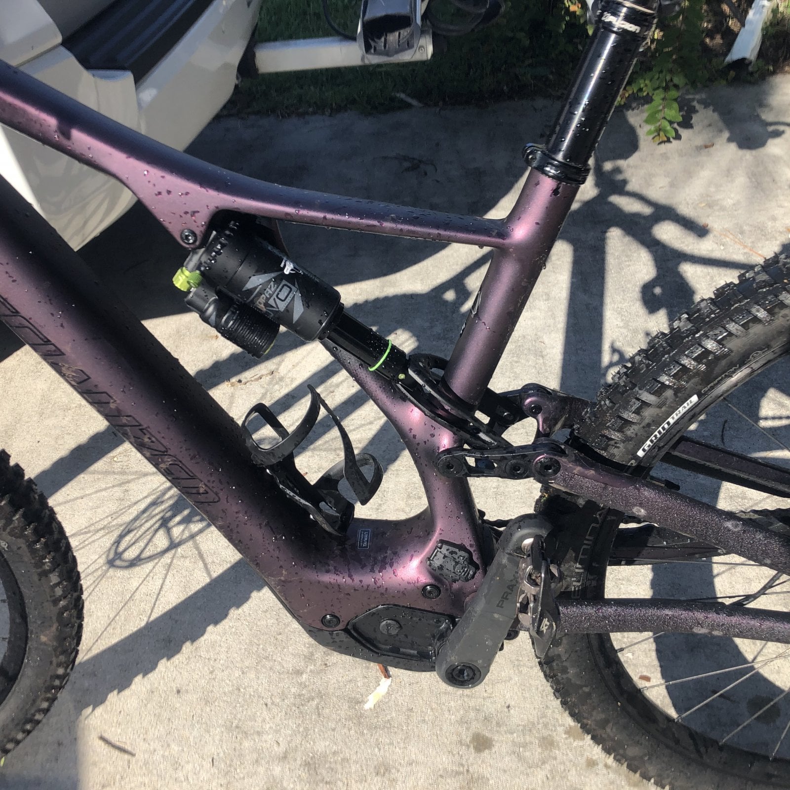

Hi, did you rode with the extender and the Dvo Topaz?
I have a size M levo SL and want to install a Dvo topaz 210x55, but I'm not sure if there will be enough space for the range extender...
This is after drilling out the cage mounting holes a bit to lower it a little, I'm going to make a bracket to get it a bit lower yet if I can, but it seems like there is sufficient room, it is tight though.
I'm also on a size medium, shock is 210 x 55 and its awesome...

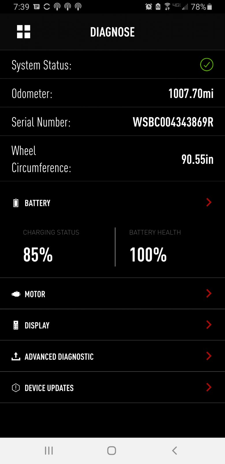

back from my lbs and he fixed my wheel size inside mission control to 2400mm is it correct?
