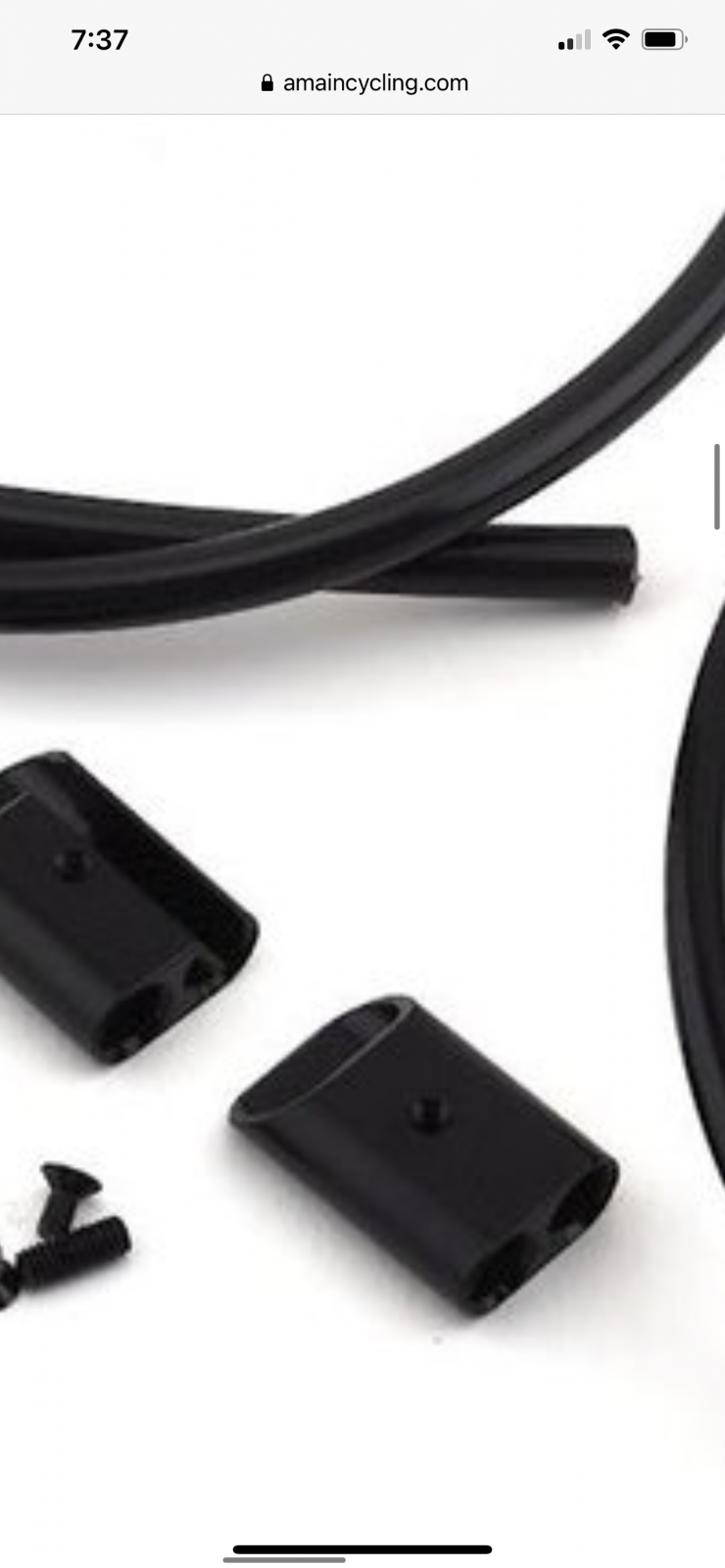

So picked up my 2020 Levo SL Expert the other day, noticed at the shop the dropper cable was very long up at the handlebar, kind of thought nothing of it, dropper was right down so just thought i would trim the outer once I had got everything setup as I wanted.
Been working on some other part swaps in the meantime, cassette and AXS.
Whilst charging my AXS battery i took a look at the dropper. Almost impossible to push the outer cable into the frame at the hole by the handlebar, loosened the seat clamp assuming the dropper unit would pull out and the cable would pull through but no. Gave the dropper unit a bit of a tug in the hope it would release but the dropper piston released but the unit is still stuck. Outer cable is still stuck fast doesn't move more than a few mm in or out. On closer inspection the outer is all chewed up, even in the slack area dangling above the fork. The bike shop obviously had an issue and knew it was a problem and just left it and hoped i wouldn't notice.
The obvious answer is take it back to them and get them to sort it. Issue is they are 2 hours drive away each way.
Any ideas where it could be caught?
Thanks
Rob
Unscrew the plug where the two cables go through. There is another screw on the side that locks in the cables.
Thanks, will have another go tomorrow. I did try unscrewing the plastic bit, and although it was loose from the frame, struggled to slide it out the way over the outer cable. Will try and get that out the way. Thanks
The plastic tubes run all way way down the frame, just need it out a couple cm.
Is the cable locking on the tubes themselves?
If so I almost suspect they have locked it in place and then pulled the slack through to the front whilst the cable has been locked. That would explain the damage to the outer cable that is visible.
I think the issue I may have is that i cant get the plastic tubes out more than a few mm because there is literally no slack on the outer cable at the other end.
The battery could be hard against it. You might have to swing out the motor and remove the battery
