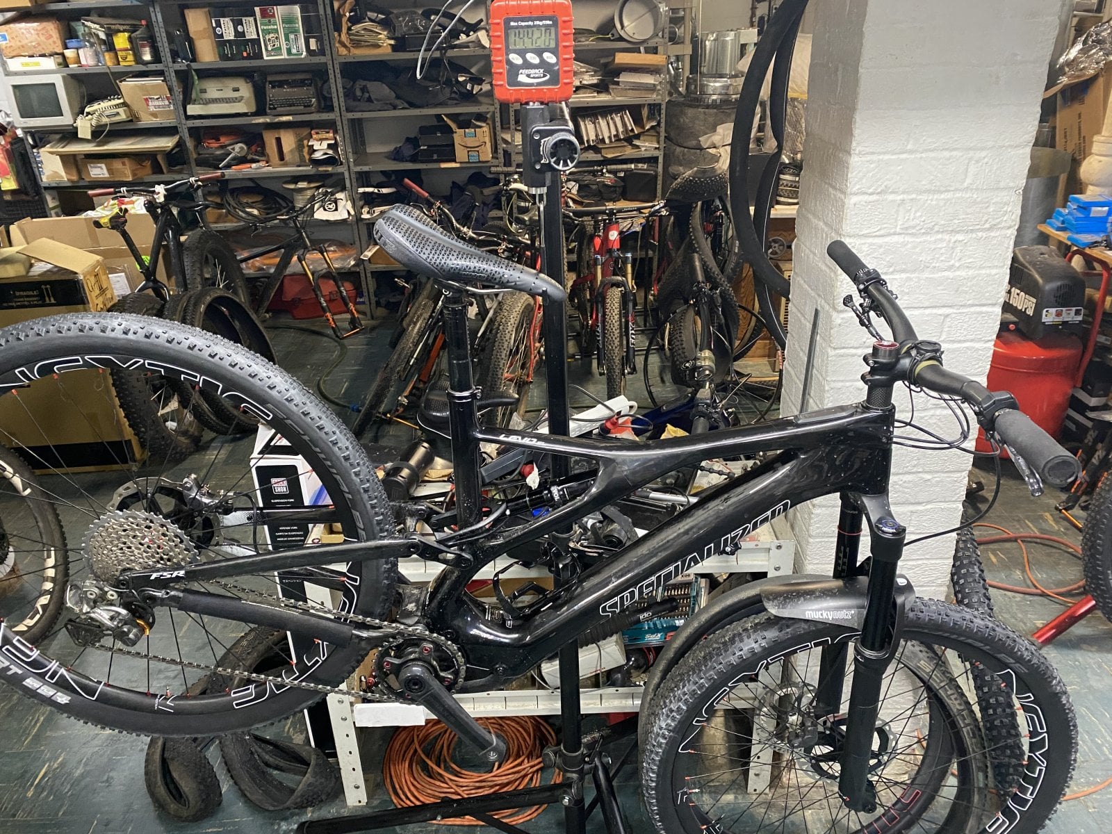

Levo SL on diet with main battery installed, without pedals 31lbs 12oz

BigFoot
Jan 9, 2019
91
46
Bethesda, Maryland USA

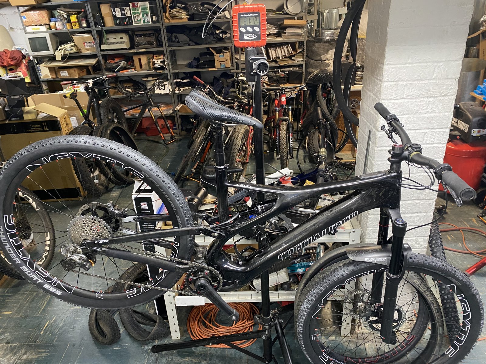

How did you drop 9 lbs?
The Nextie Wheelset set is close to 1200 g the wheel set they came with it was over 1900g
Also the tires that came with the bike are nearly 1000 g each
Yeah those tires in the picture are barely 55 mm wide they are definitely sketchy doing a wet winter ride.
I mostly riding the bike at 32 lbs. 12 oz. to about 33 1/2 pounds depending on where I’m riding .
Bontrager XR2 2.2 or 2.35 these are fun fast tires.
Or if I’m riding in the mountains in the Frederick watershed in Maryland over wet rocks I prefer the XR4 2.4 tires.
If you guys are interested I could make a list of how I saved the weight?
@BigFoot Yes I would definitely like to see your list. Thanks.

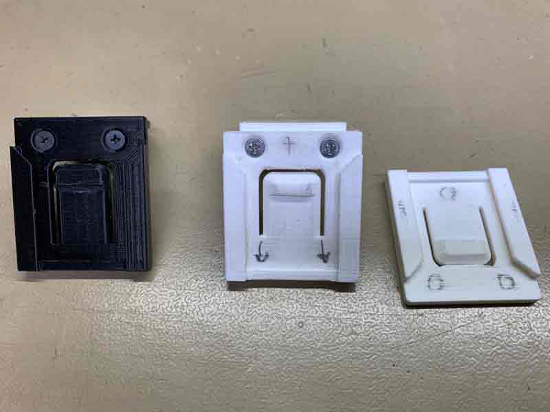

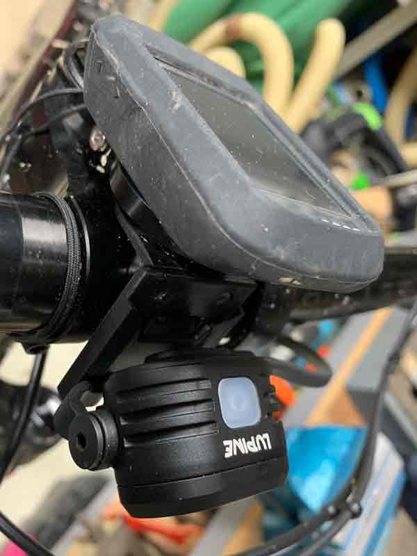

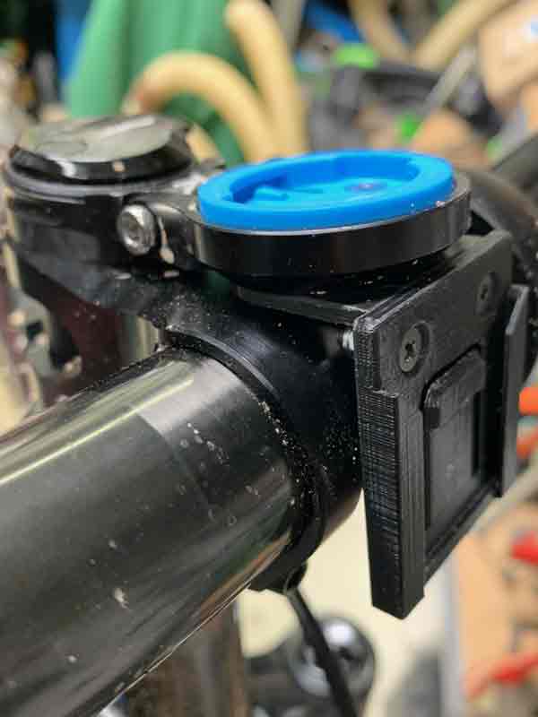

sonix
Oct 18, 2020
7
All a happy and healthy 2021 !!

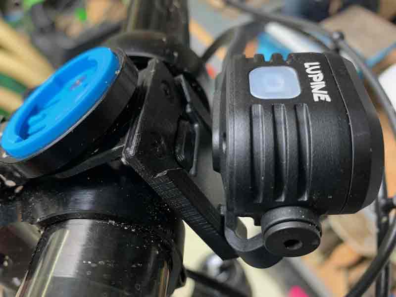

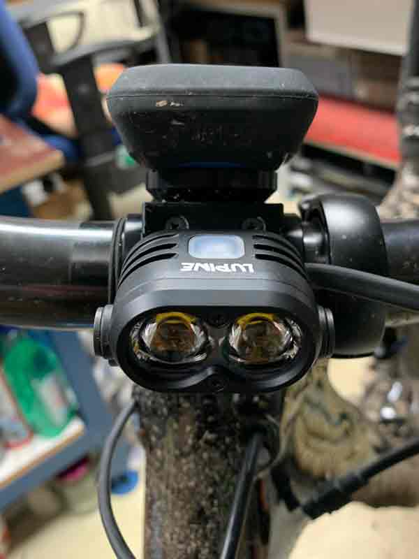

Since there was time to do something today ;) , I thought about assembling my Piko.
I didn't want to add an extra bracket, so I was looking for a way to mount the Piko directly on the K-Edge bracket for the bolt.
Tata ..
first test prints to see if the dimensions fit..
.. and mounted.
cheers
Tata ..
.. and mounted.
cheers
Nice bracket
can you power that light with your levo SL?

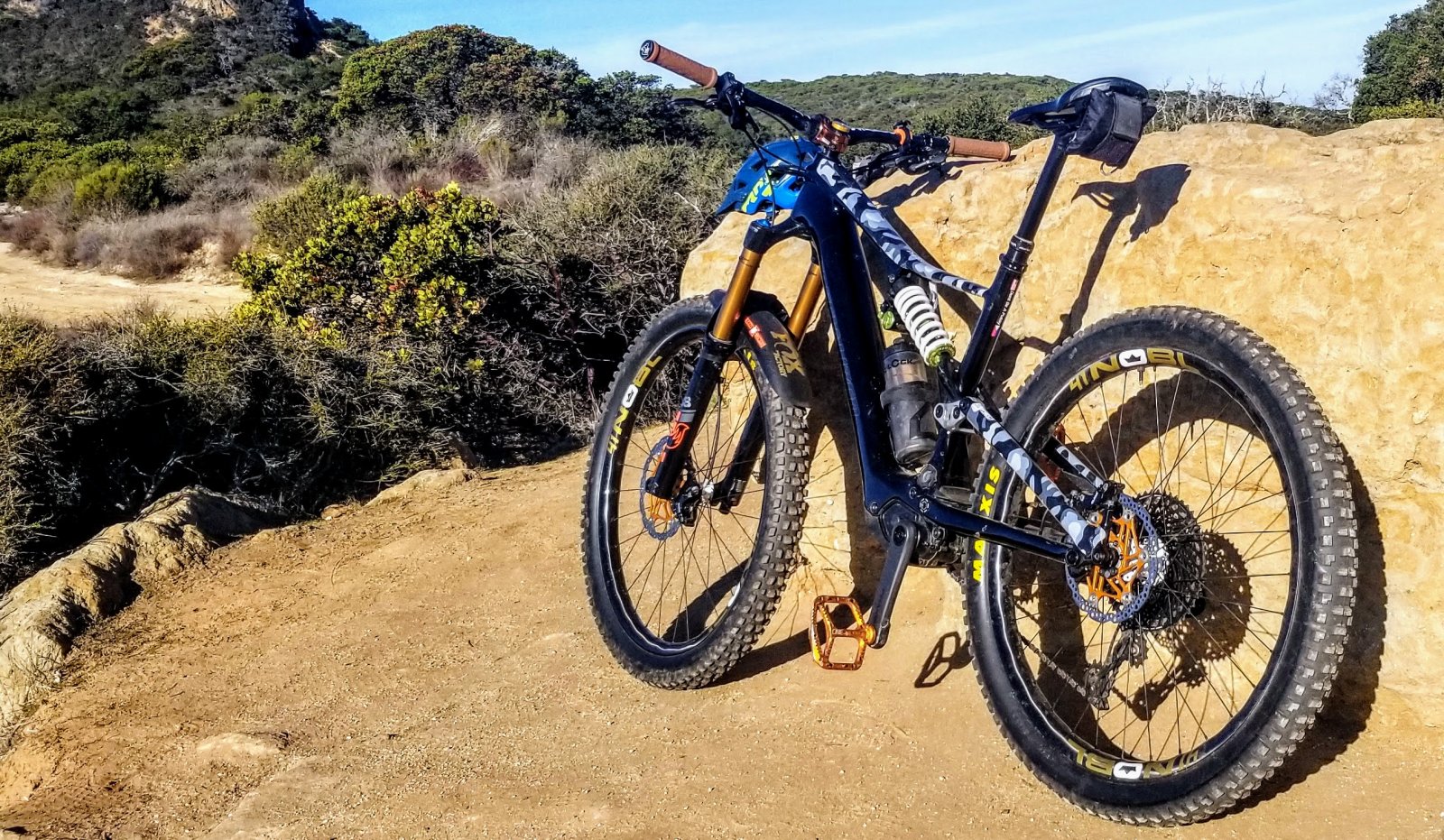

I guess it must be a lens distortion as the wheels look the same size in this image! How do you find the SL performs with a smaller rear wheel?
Yeah its hard to tell in that pic. I just recently replaced the rear tire from a 2.4 to a 2.6 because I was getting a little too many pedal strike even tho I had the flip switch in the high setting, Now with the 2.6 the bike feels great!! No more pedal strike, turns great and tons of traction! I'm loving it.

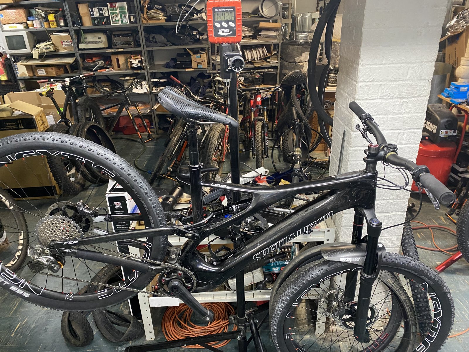

Weight savings of carbon 2020 SL Expert
Traverse wheelset carbon 1950 g
Nextie DT Swiss hubs CXRay wheelset 1250 g
Butcher Eliminator tires 970 g each
Schwalbe 2.25 tires 575 g each
These Schwalbe Thunderburt and Racing Ralph are not enough tires to run in the winter wet, I prefer 650 to 850 g 2.35-2.6 tires for wet winter riding .

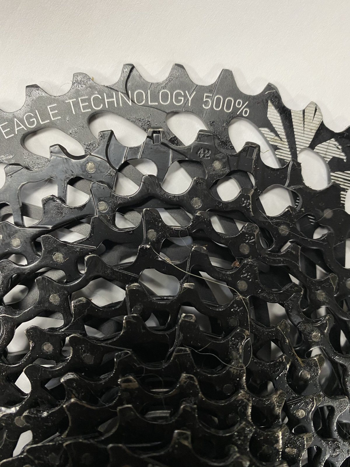

XG 1275 10-50 12 speed cassette 450 g
XG 1199 10-42 11 speed cassette 260 g
See picture below I only seem to be missing the 50 cog, depending on where you live you may not need it either.
SRAM G2 brakes to-
XTR M-9000 brakes about 100g savings Per brake
200 mm rotors to 180 mm ice-tec rotors remove adapter from brakes 80 to 110g savings about ?
SRAM GX derailleur and shifter and cable to DI2 XTR about 50-100 g savings
Chain stay protector to lizard skin 40 g saving.
X fusion Mantic 625 g
Bike yolk Divine Seatpost 400 g +45 g carbon shim
Bridge saddle 265g
WTB Koda 210 g
Praxis Alloy Cranks 475 g
Praxis carbon Cranks 340 g
Chain guide removed 27 g
Chain doesn’t fall off even on advanced trails
Fox 34 E bike 1910g
Rock shox Pike revelation 2.0 charger 2021 160 mm Airshaft 1792g
Swat tool removed 132 g
I already carry a multi tool that has more functions
Stock grips 110 g
Shimano pro foam grips 70 g
Specialized stem 150 g
Renthal stem 120 g
Alloy riser bar 362 g
Renthal carbon bar 190 g
25,822
