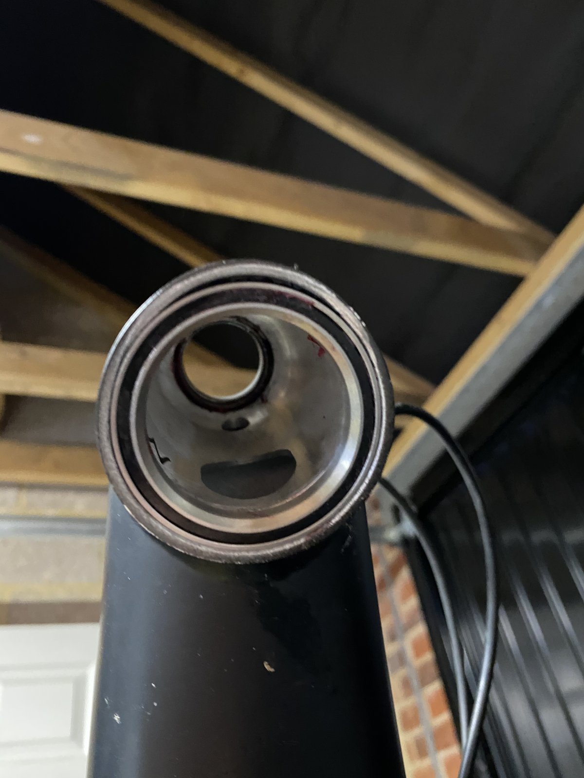

My 2020 Expert produces an off-putting juddering sensation from the front end on bumpy terrain. It is as if something is loose.
I initially thought it was the front hub, as with the front brake engaged there is a slight amount of play or ‘rocking’ that that be produced, however I am pretty sure it’s a headset issue even though I can’t feel any play in it at a standstill.
I have stripped the thing and regreased (and in doing so noticed that the lower bearing came out in two pieces exposing the ball bearings). I have also tried it with the topcap torqued to spec and slightly over. Still happens. So now I’m tempted to try removing the unused SWAT tool and reinstalling a normal starnut. The preinstalled one came installed at a slight angle, which may be a factor.

Has anybody had a similar issue and managed to solve it? I heard a few complaints on a facebook group but noone offered a solution.
It’s much better then starnut and the specialized swat tool.. the biggest improvement is the 1.5 reducer crown. I would sort that out ASAP or you head tube will start to bend
