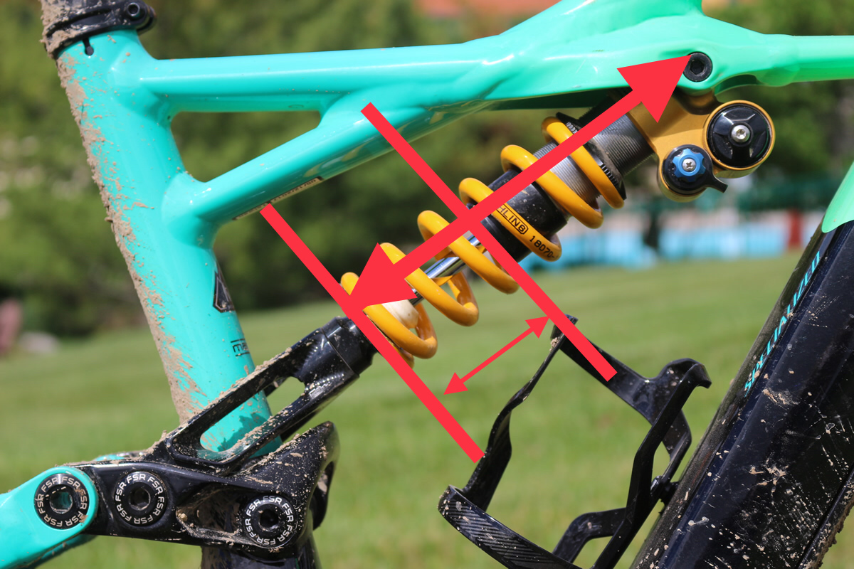

Could anyone do me favour that has a kenevo expert with the ohlins shock. I’m chasing some quick measurements from the shock.
- Bottom spring plate to top shock bolt
- bottom spring plate to bottom of shock body.
Apologies for my dodgy diagram below but you get the general idea of what I’m after.

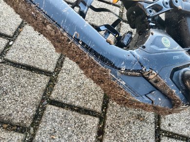

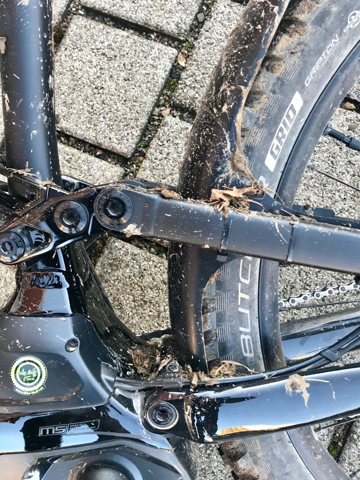

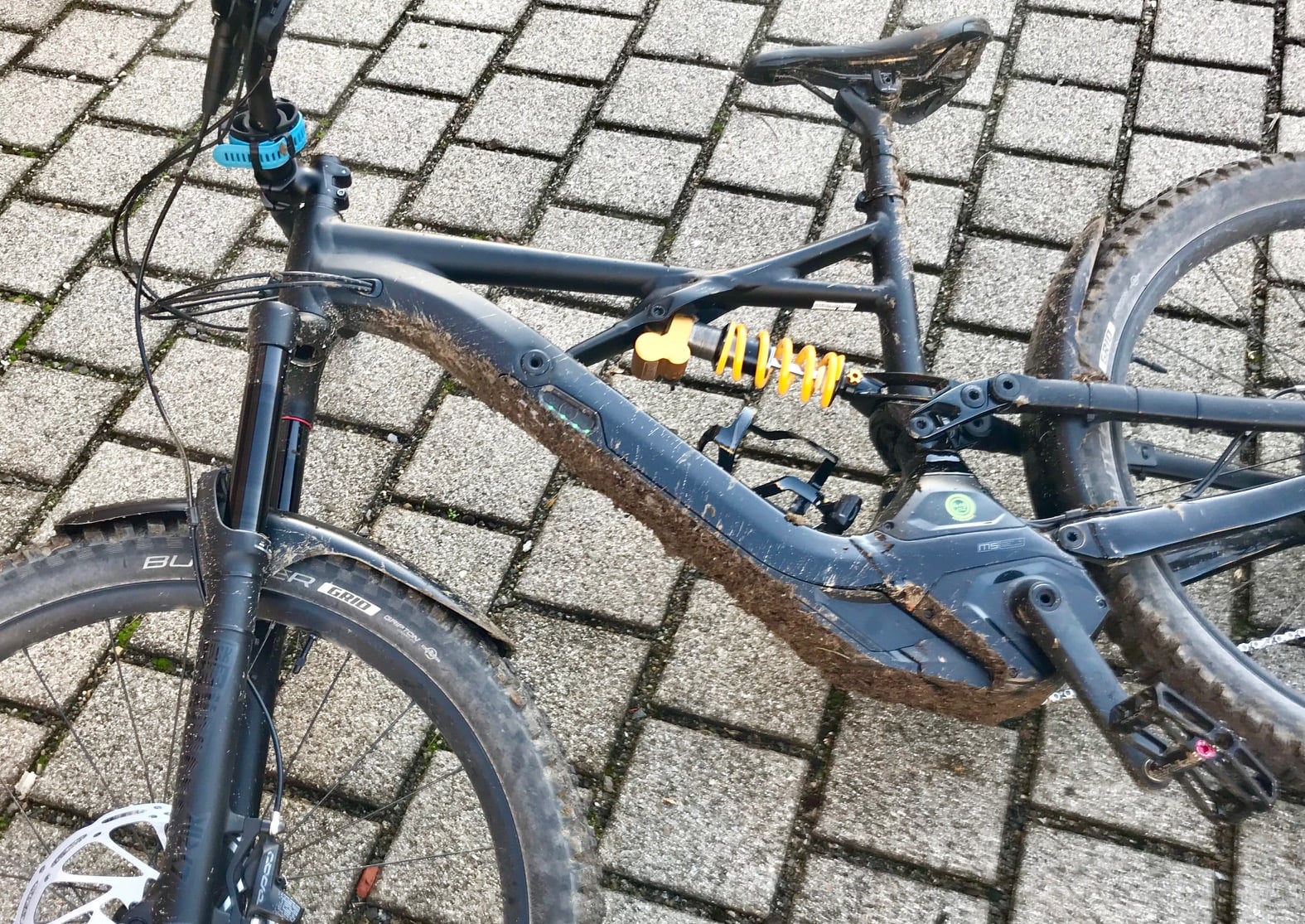

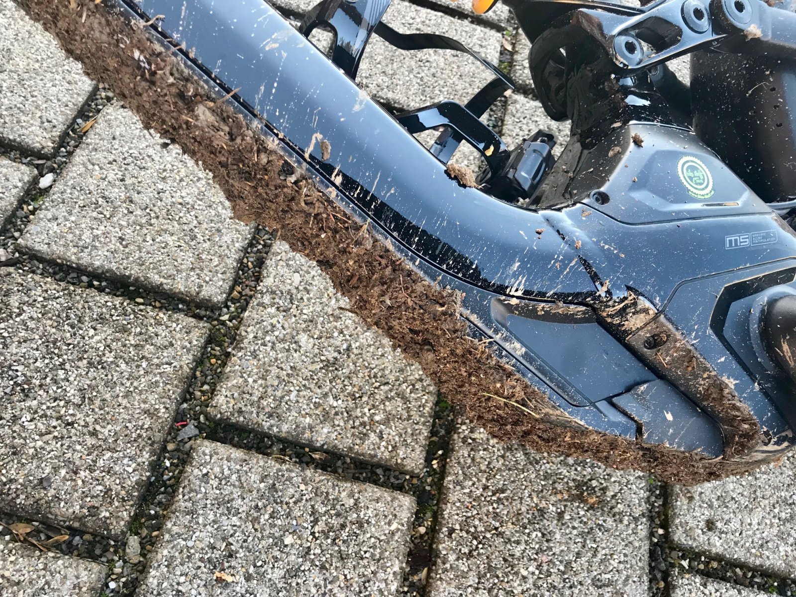

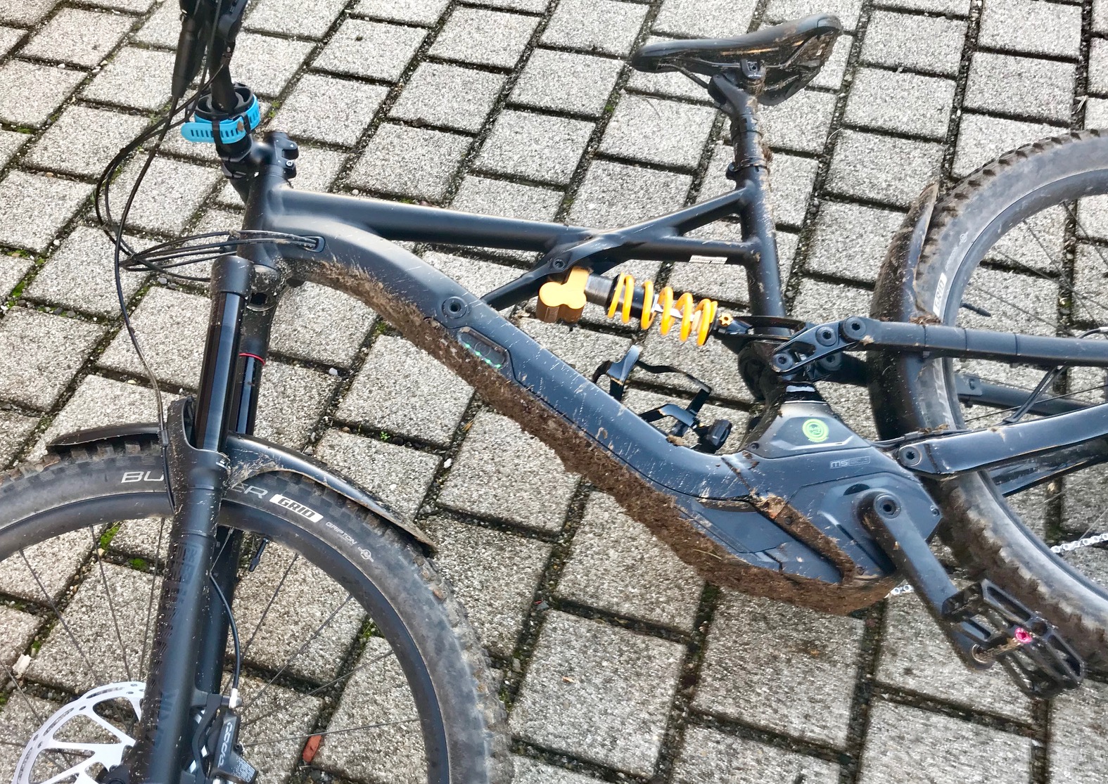

On this weekend i had the first chance to test the mudhuggers. They did a pretty good job protecting my face and the rear joints, coil&spring and the back of the motor housing. Have a look here, you clearly see where the dirt goes and where not (so much):
Yes i know, that's nothing compared to real muddy conditions ;)

What do you need the measurements for? Planning on swapping the shock?
Ti Springs claims the Kenevo has a shock stroke of 2.25" Specialized Kenevo E-Bike Springs
The faq here says that the shock has a eye to eye equivalent of 216mm and stroke of 63mm 2018 Specialized Levo and Kenevo info thread and FAQ - EMTB Forums
So does this chart on TFTuned Specialized Turbo Levo and Kenevo BikeYokes - Shock Parts - TF Tuned
But the TFtuned chart is relating to the shock size required if using that yoke to convert the bike away from the standard mount. I'm not sure if using the yoke changes the required shock size.
The thing is though, that 216mm equals 8.5" and 63mm equals a stroke length of 2.5"
Which doesn't add up to me because you wouldn't want a 2.25" spring as TiSprings suggest on a 2.5" stroke shock like the faq and TFtuned chart show, as it'd result in a spring that could get possibly coil bound before the shock has used all it's travel.
You have the Kenevo Comp, what markings are on the Fox spring it came with at the moment. It should probably say the stroke length of the spring on there.
I hope some of that has helped at all.
Which specific huggers did you go for?

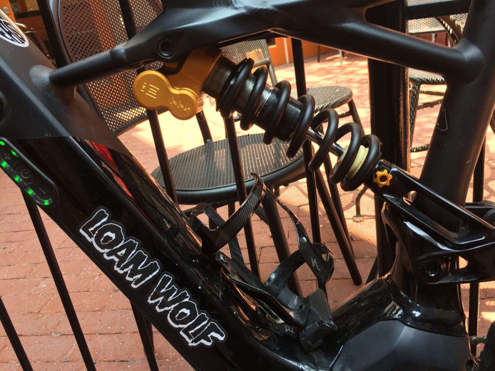

Also I need to get a stiffer spring, as with the one fitted (548 lb/in) my sag is about 50% I've spoken with Ohlins and they have recommended a 112N/mm / 640lb/in from the Specialized Enduro range. Does anyone know of anyone else who who make a spring of roughly that rate that would fit on the kenevo?
On another thread in the "for sale" section, member @73Steff mentioned that he has a 640 spring available.
I did the same on the rear, had trouble when it got very muddy so I had to remove it. Not a lot of clearance back there between the frame and tyre with those Butchers. But it was VERRRY muddy.
Thanks for the heads up. I've actually just got a 674 from J-Tech Suspension. It seems that Ohlins have started to make bigger springs for heavy Kenevo riders. If anyone is looking for a nearly new (118km) 548 coil please get in touch

Hey, it's the "front race long" Version on both wheels. On the rear i had to cut off 2-3cm to made a nice fit. Also some added holes were needed in the mudhugger, to be able to strap it tight.
Yes indeed - not much clearance! I regularly get small rocks or twigs in between. The rocks smash through, but twigs got catched 2-3 times already and i had to stop and remove them. That's the downside, but it's not that of a big bummer to me, since it doesn't happen too often.
