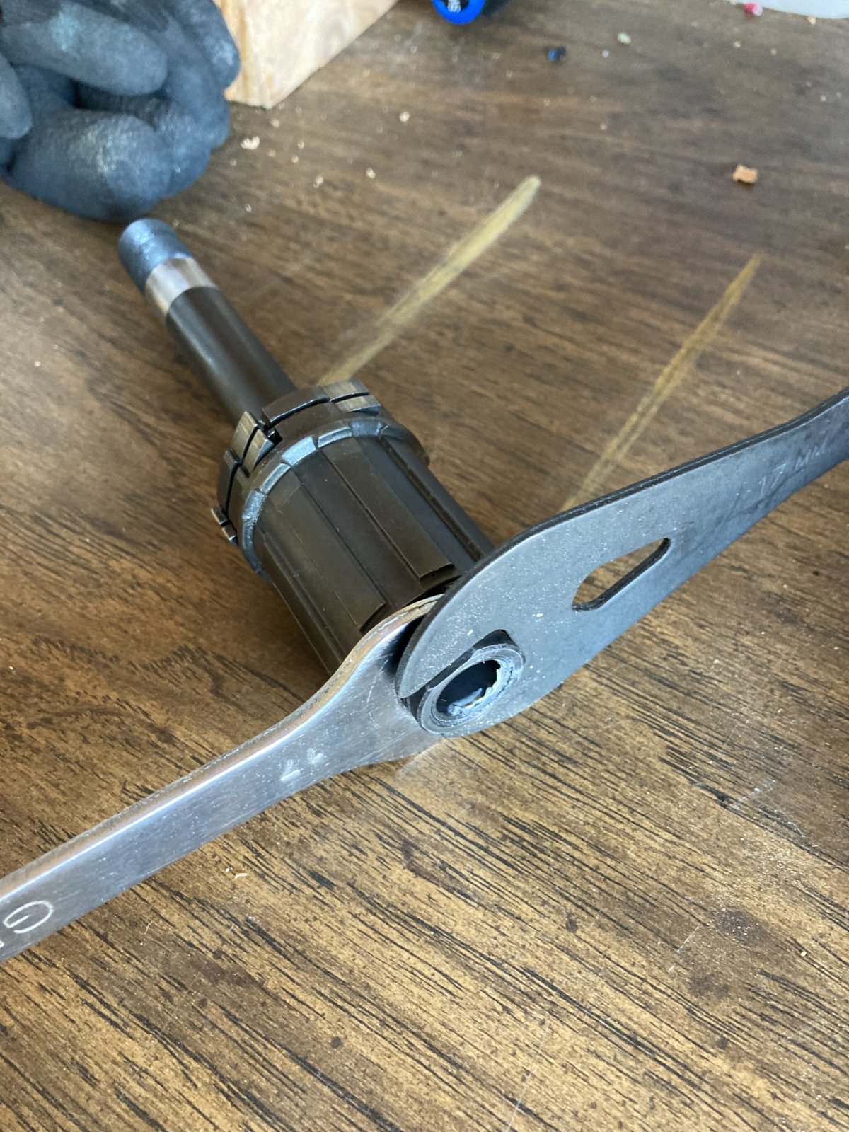

No the 162 comes apart just like the 462. Once you remove the assembly from the hub like you did it comes apart. They both have steel cassette drives and both come in 3 and 5 pawl versions but Focus uses the 5 pawl. The 162 has individual bearing and races that you need to grease while the 462 has 3 cartridge bearings that are sealed so it's the better option And both are the type that fit your hub. There is an 11 speed and 12 version as well. Like I said there are slots on one end for a slender wrench and I think the other end takes a hex. you adjust these for the 462 to just take the play out of the bearings on the 462 and when this comes loose as it does, then the bearings wobble and hammer the races, probably your issue. You just need to get this assembly apart now and it does come apart....but no replacement parts available other than just buying a new assy for the $70.
OK, it's two 17 mm wrenches to unlock the double nut on the end that you see in this pic. I have an extra one with the ball bearings that Focus gave me under warranty. Too bad you're not in the states.
