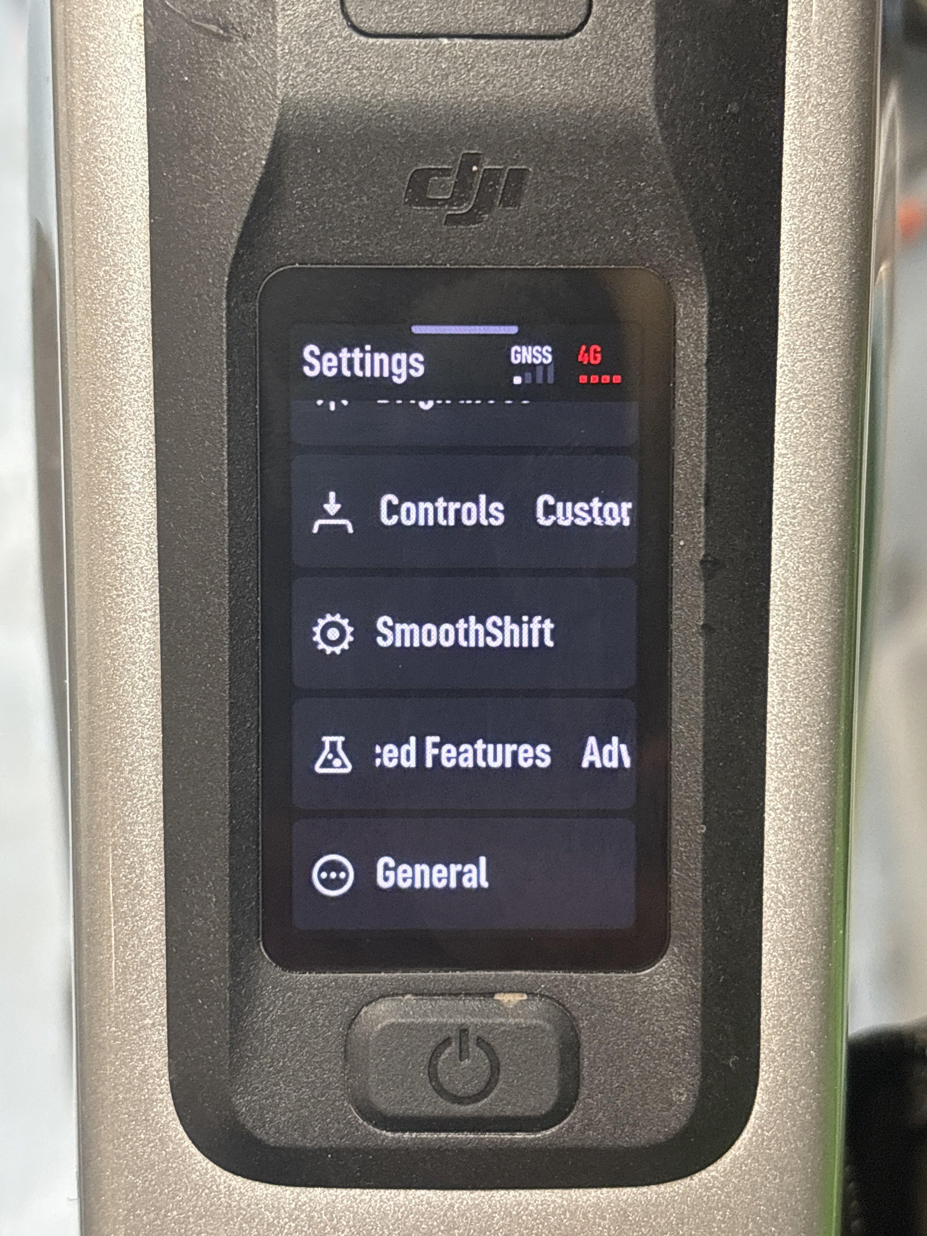

Hey anyone any solutions yet? I'm in the U.S., my amflow isn't seeing any speed limit options when scrolling up or down, I have the latest update.
It's kinda frustrated having it locked up @ 20mph.

Mine was imported here to the US. Initial setup it was locked at 20mph. I also do not have the feature shown in the app to change speed.
Unpaired it. Repaired it using Hong Kong VPN and now its good to go 28mph!! Only have to do once. After that it is always unlocked to 28mph whether its connect to phone or not. App does not need to be connected either. One and done

You can install NordVPN on your phone and subscribe. Then you have 3 days to cancel subscription before paying anything. I just found out that other VPN services not always work for derestriction, even NordVPN only works if you log into Hongkong, New Zeeland didn't work for me. I also didn't check if letting the RideApp using WLAN connection works for derestricting, but letting the app only connect via mobile data definitely did the trick for me last time. Please report back if everything still works as expected with the newest software updates.
It looks like Avinox are slowly identifying and blocking the use of VPN services - there have been reports on here that Privado / NordVPN etc worked before, but now do not allow region change to NZ...
Yeah Privado now doesn't work at all, tried their service with no luck.
