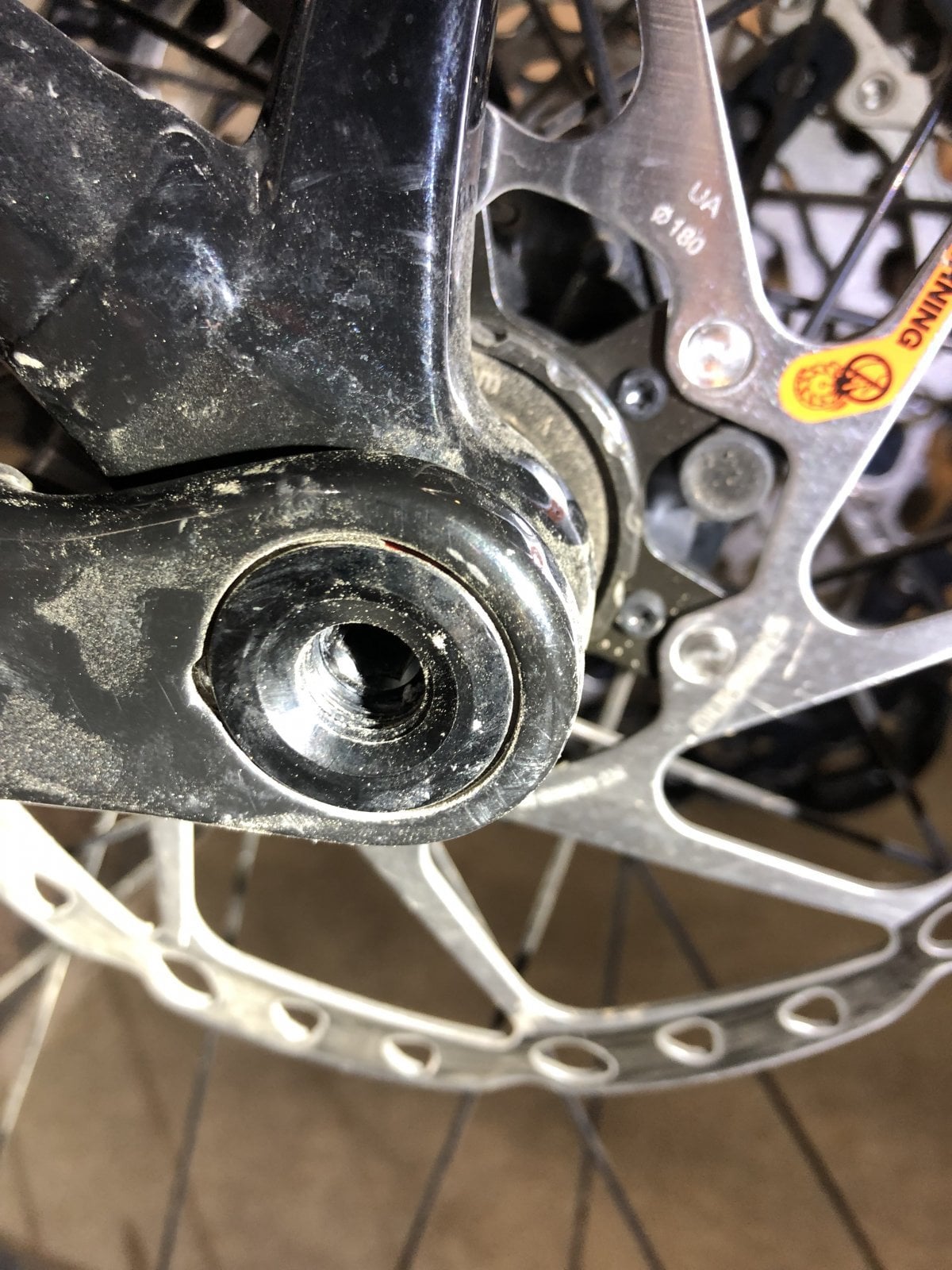

Today I noticed a noise on my Rise H15. I thought the cassette was loose, but it turns out that the threaded boot on the non-drive side of the rear axle has come loose. This holds a washer in place that is now dancing around. I see no way of tightening this. Even with the axle tightened to its 10nm, it's still loose.
Has anyone else had this problem?
It looks like the assenbly is fixed into the frame with a circlip...and that circlip looks to be broken. If so remove the remains of the circlip, remove the assembly, clean, and refit with a new circlip.
How do I remove the assembly'? It's threaded into the frame and I don't see any way to remove this. I don't even understand how they've got it in there.

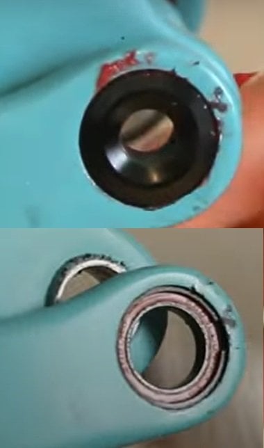

Maybe these will help. Looks to be held in place by the axle and when the axle isn’t connected it’s held in place by the o-ring? Might just push out from the inside? 8A3CC797-BD1D-4E1B-B1E5-E8B48EABB7D7.jpeg
This is how it should look. Looks like the whole assembly has popped out when the wheel was off or when the axle was pushed in and the circlip has popped out of its location. Maybe just remove it all and it put it all back together with everything properly seated so the outer cover sits flush and try not to push too hard when installing the axle

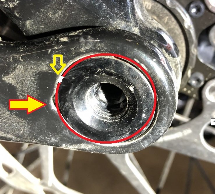

Normally the circlip should not pop out. It should stay inside a groove. I guess it might be a bad workmanship that allowed the circlip not fully housing in. And the bearing now might be pushed outward such that you can see the circlip right now. You may need to press the bearing to seat in completely before the circlip can be seated in its groove.

The circlip opening (yellow arrow) should be placed near the notch (solid yellow arrow) because you want the tool insert can easily squeeze the circlip out of the groove. If you place the opening opposite the notch, you may find it is hard to do that.

I can't get it to sit back under the end cap. It seems way to big. Also, there doesn't seem to be any way to apply any real pressure to the end cap. Should the circlip fit inside the red area of the bearing? If so, it's way too big.

OK. I've seen where it clips in, but I had to remove the bearing to get it seated. Now I cant get the damned bearing back in. And I don't have a bearing press. This gets better and better
Sounds like the bearing has moved out slightly. Remove the bearing and thoroughly clean the area so that the bearing can be fully pressed all the way back in. Once the bearing is fully seated it should fully expose the groove for the circlip to be installed that holds the bearing in place. Best to do it with a press but I’ve always used a selection of sockets and a long bolt and nut or vice/clamp.

Sometimes there's dirt or debris behind the bearing that causes it to not fully seat in the bottom and then the circlip is not expanded into its housing groove at all. Whatever it is, make sure you could see the groove clearly enough to allow the circlip returns into its expanded state so that it will no way escape from the groove. This design is alright. You could hardly see any failure if it is installed correctly.
