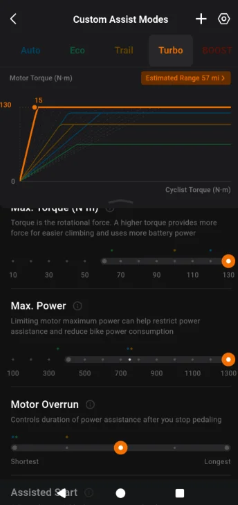

My understanding is that boost is basically max everything available with the current configuration. The custom setting goes to up to 1300w/130nm so I don't know what boost is offering beyond that.
What do you have your turbo mode set at?
If it's maxed out like in this screenshot do you still feel anything extra when you hit the button?

I’m not sure what the power is but it feels like it’s a step up of power from turbo. I’ll need to watch the power to see if it goes above 1300. You can’t change the power on boost. And it doesn’t display what the power actually is. It’s either on or off. Troydon stated boost and turbo are the same but after using yesterday, I question that statement.

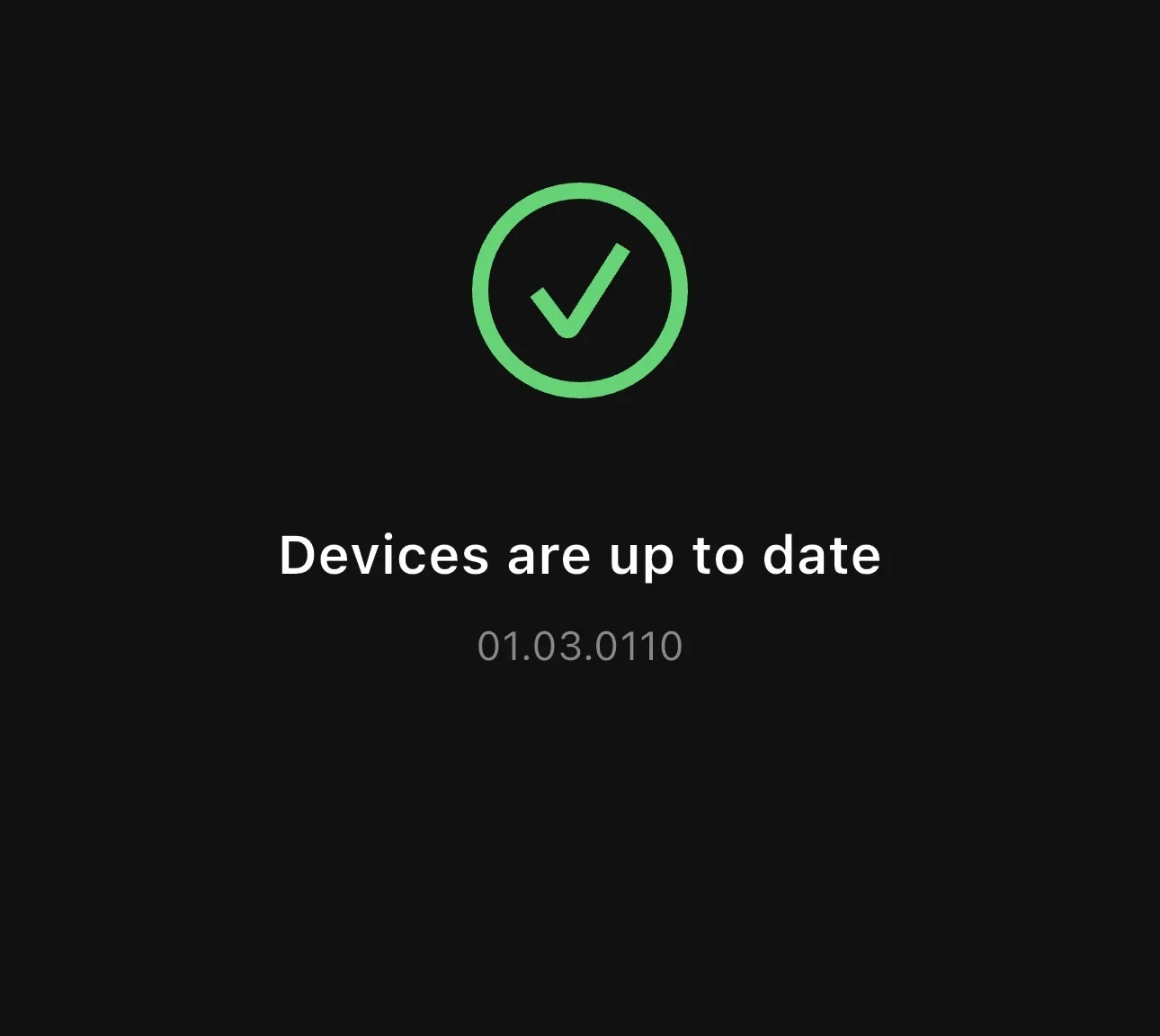

Not me. I get an update notice every morning and install it and nothing happens.

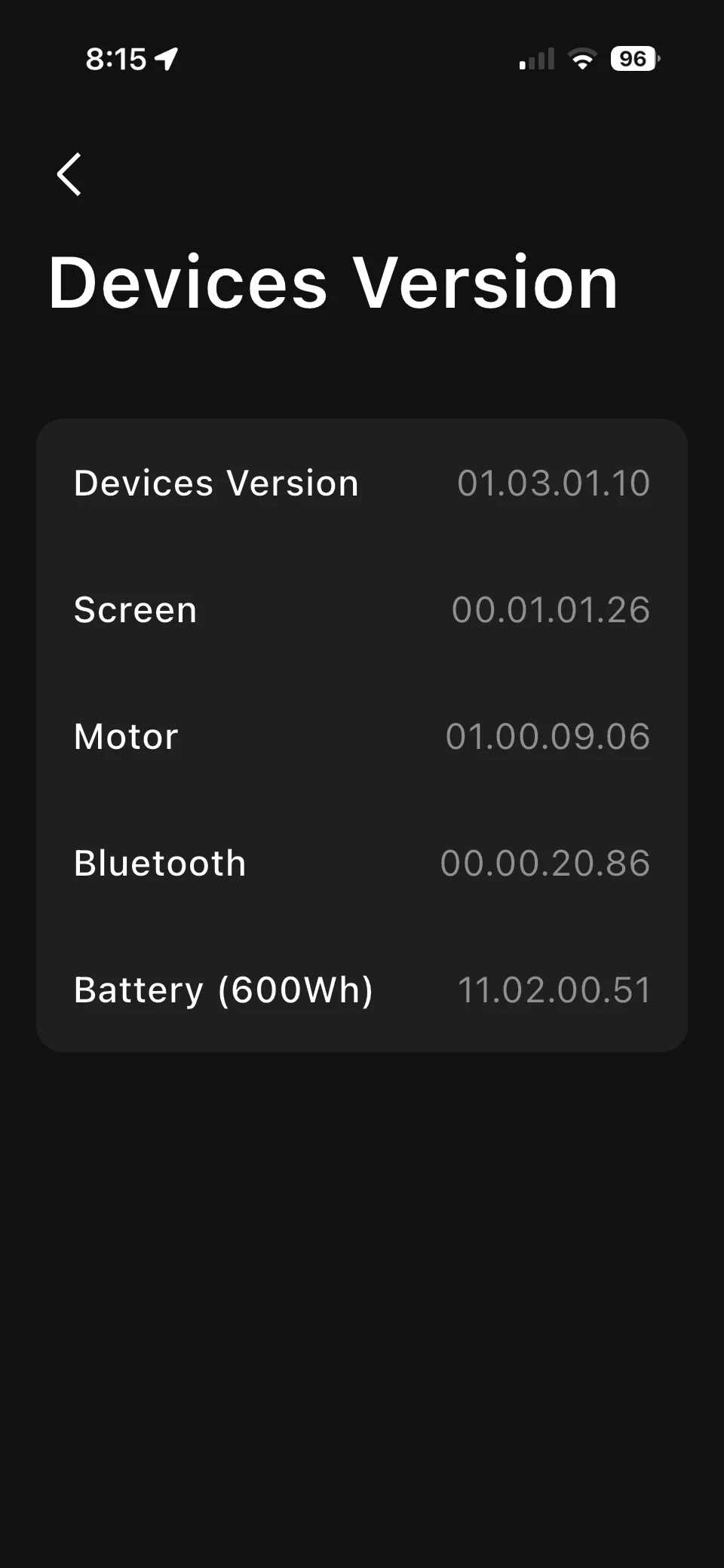

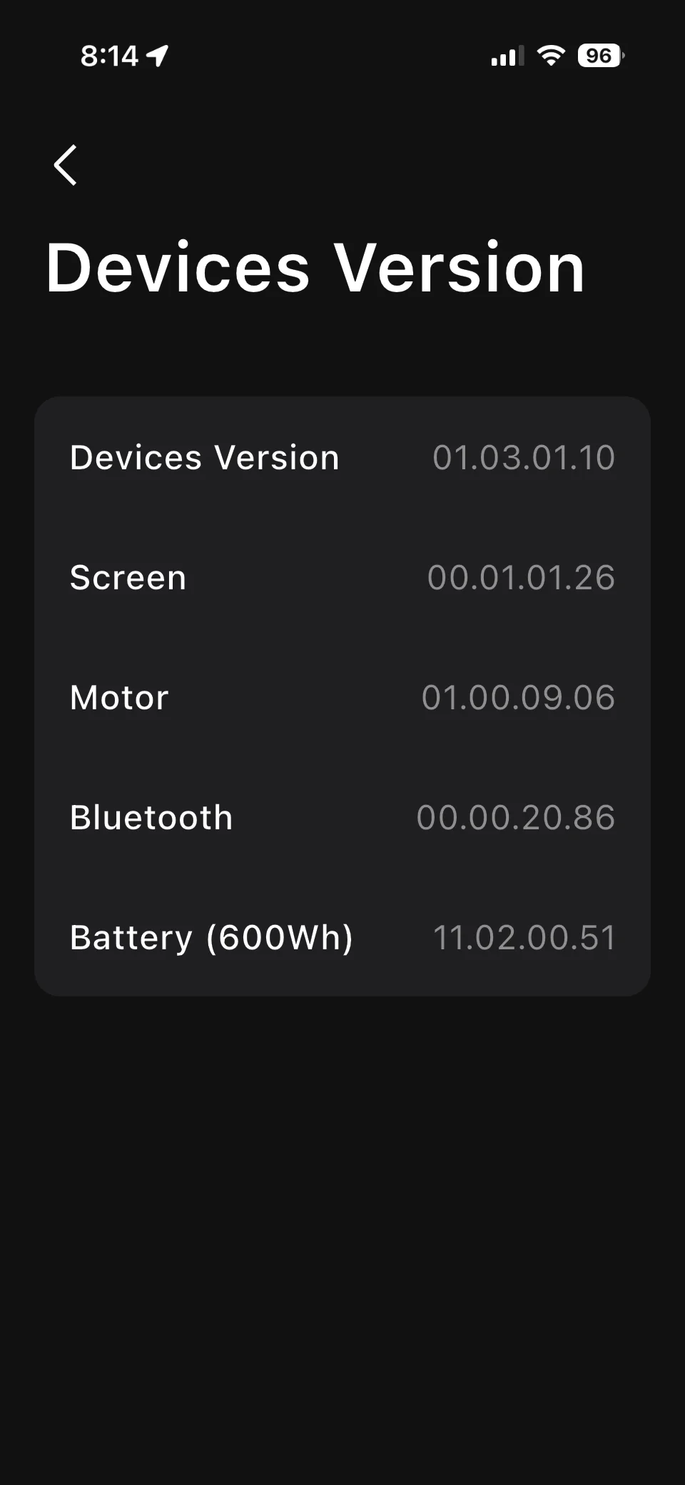

Before update followed by after:
Have any of you that successfully updated got newer versions? Or are the version numbers the same as mine above?
Mine also are the same. I noticed the devices version number didn't change when I did the update.

Happy to say I finally tried it and the latest update also worked for me.
