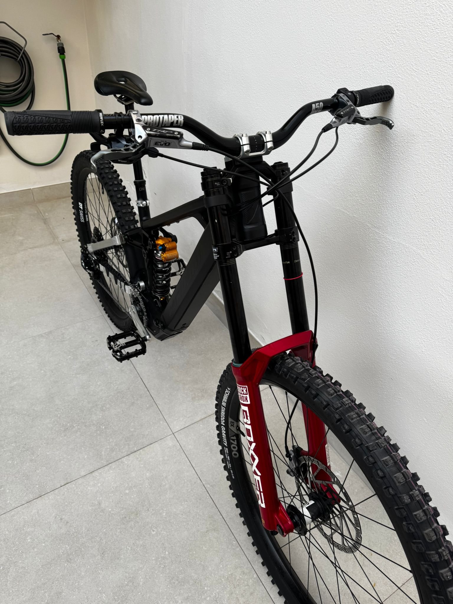

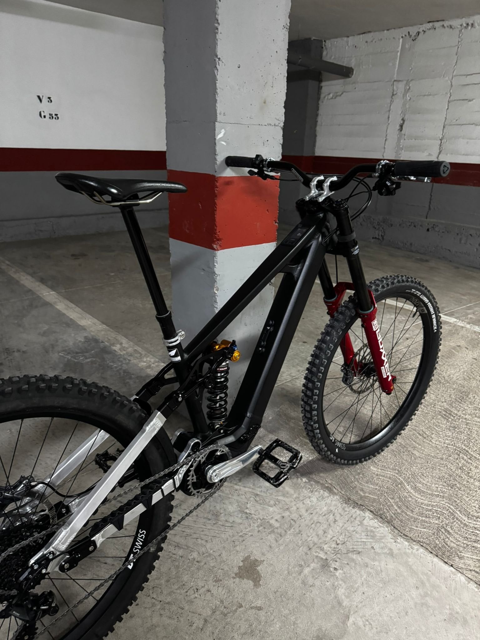

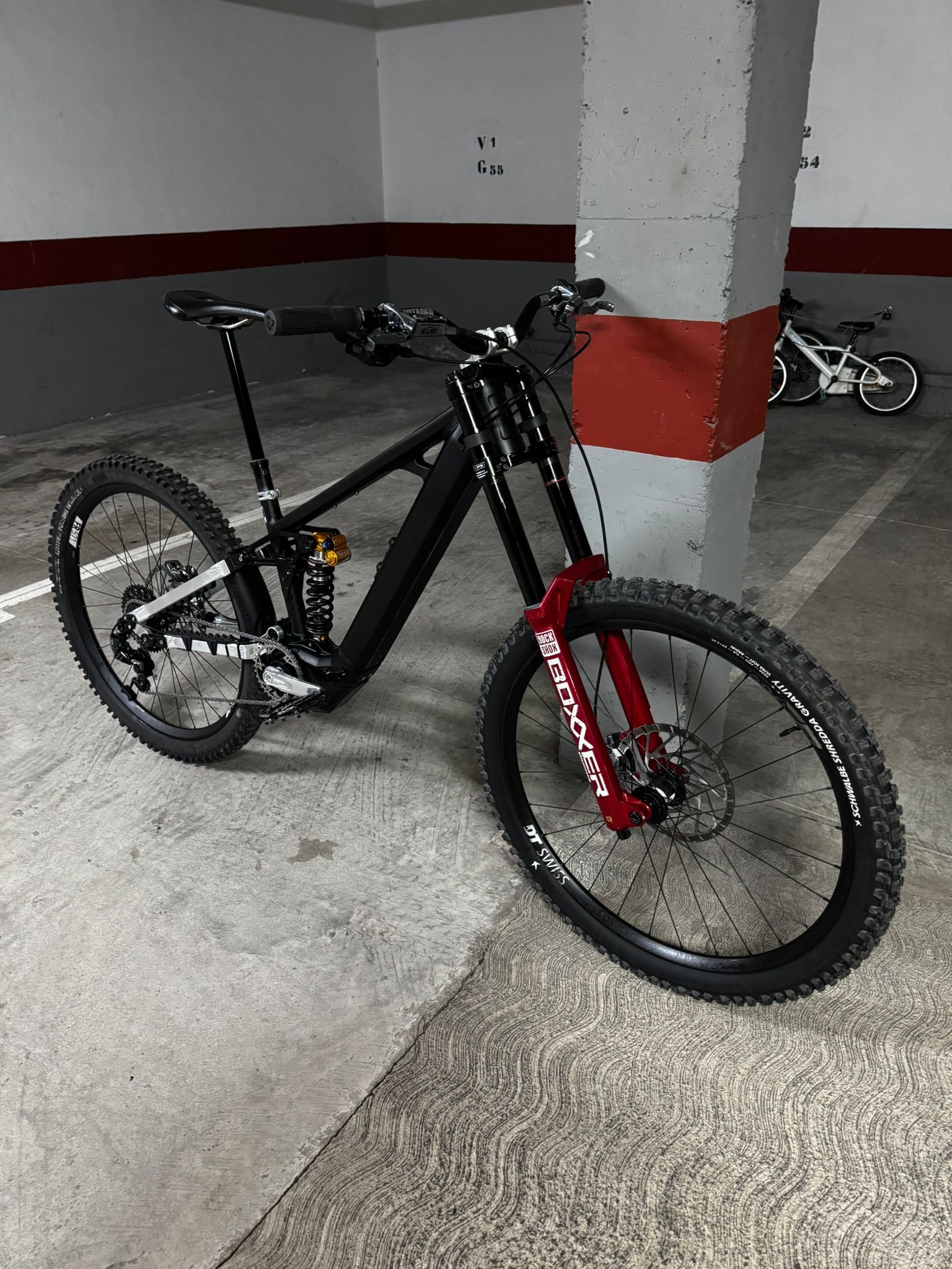

Here's some pics of mine, loving it so far! Obviously not a trail build and I hadn't ridden for about 3 months but managed 42km & 1700m elevation yesterday with 5% battery remaining at the end. Still playing with the power settings but did the most KM in Eco and Tour+.
WhatsApp Image 2026-02-05 at 09.35.52 (1).jpeg WhatsApp Image 2026-02-05 at 09.35.52.jpeg WhatsApp Image 2026-02-05 at 09.35.53 (3).jpeg WhatsApp Image 2026-02-05 at 09.35.53.jpeg

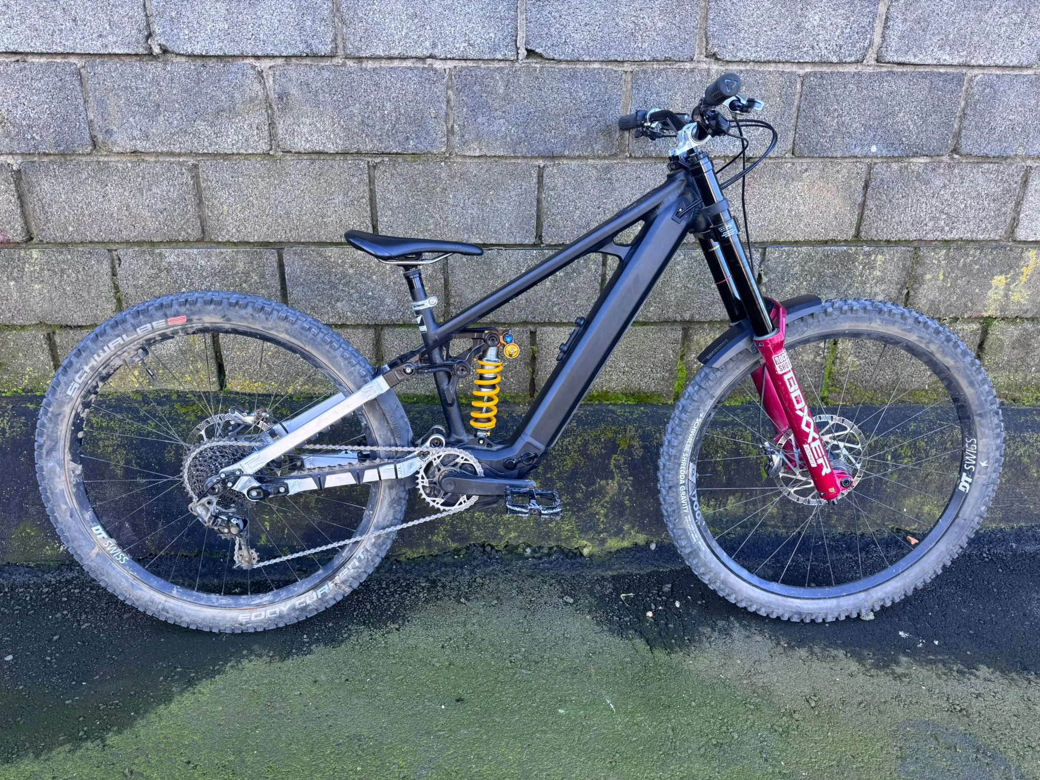

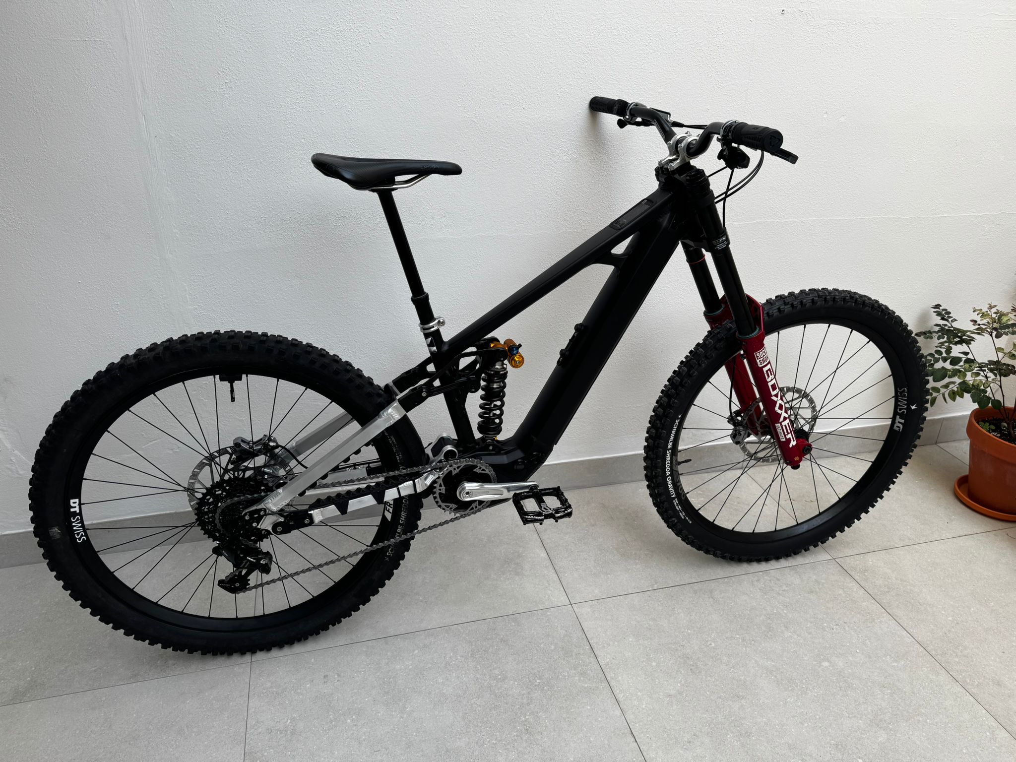

I'm afraid to ask but...
how light is the bike? 😉
Another post-ride pic for attention. @Rob Rides EMTB how are you getting on with the reserve wheels? My only complaint so far is that I'm getting loose spokes after every ride so considering a carbon rim on the rear at least.
Looking great!
To be honest the carbon rims have been great - the rear is the DH rim. Thats the thing I link about carbon rims, they tend to not need much fuss. No trueing etc (obviously catastrophic failure is possible!)
