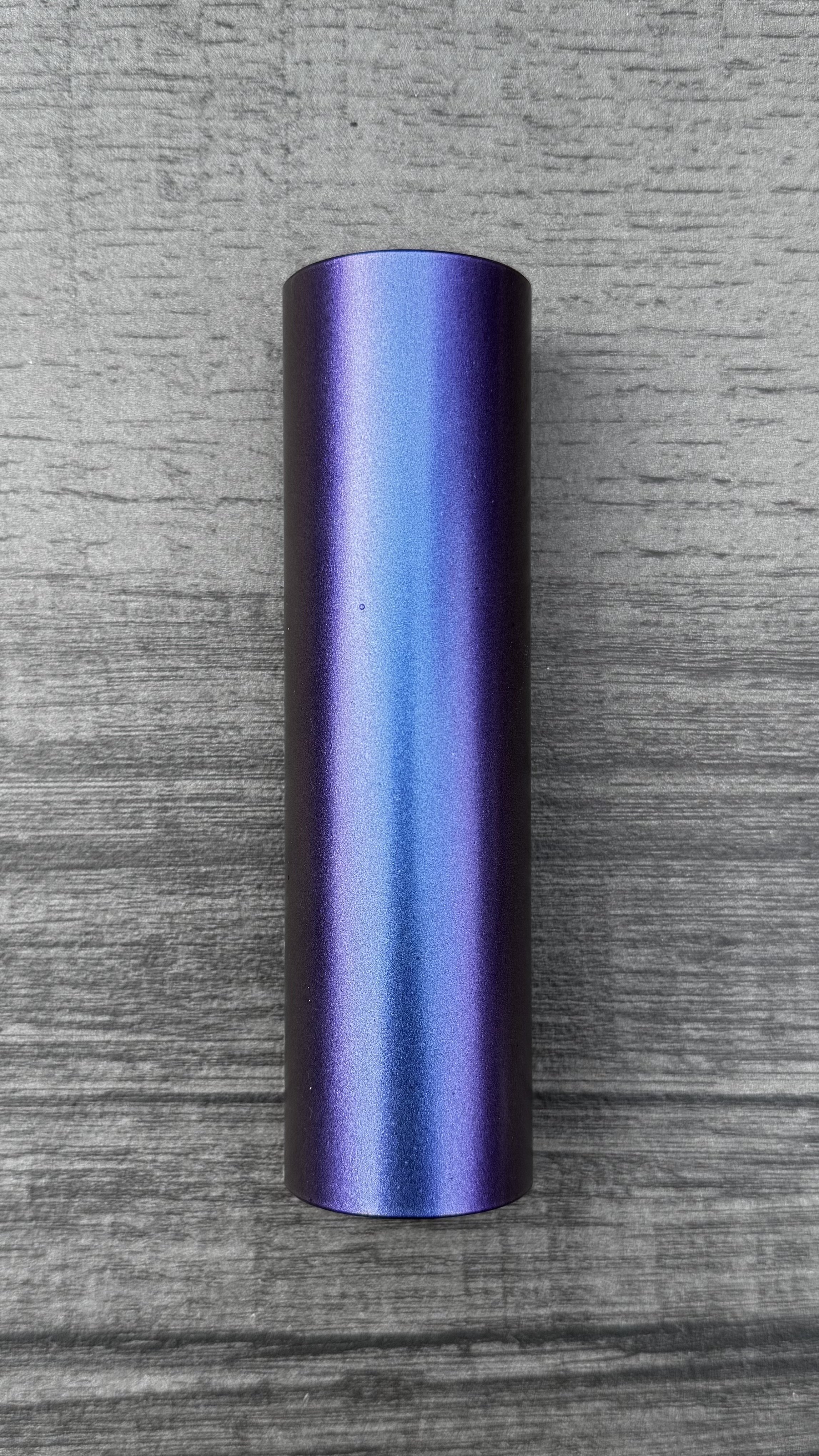

Chosen my frame colour. Cerakote in this colour.
Personally I loved the colour of the one you ride in the video!

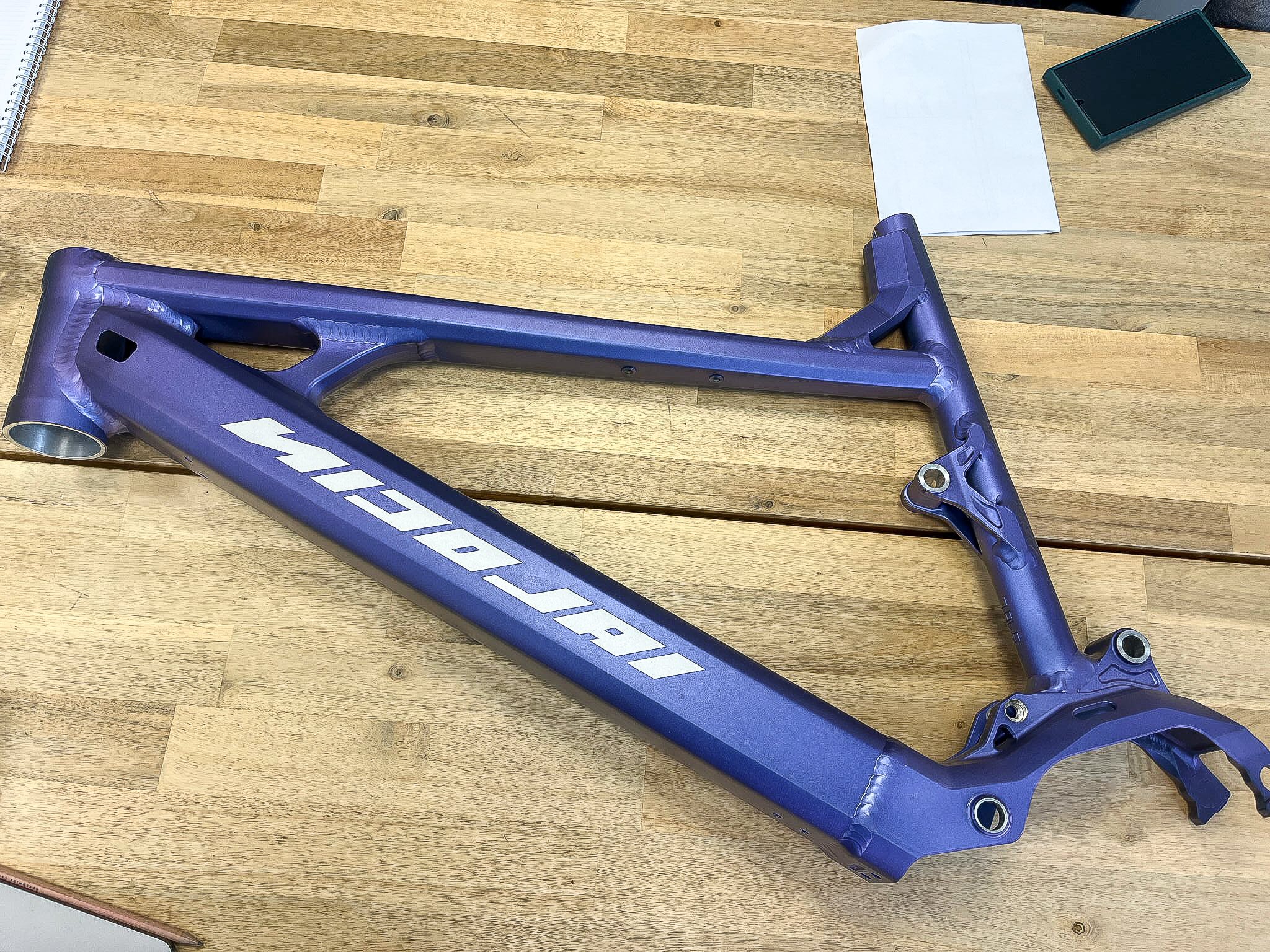

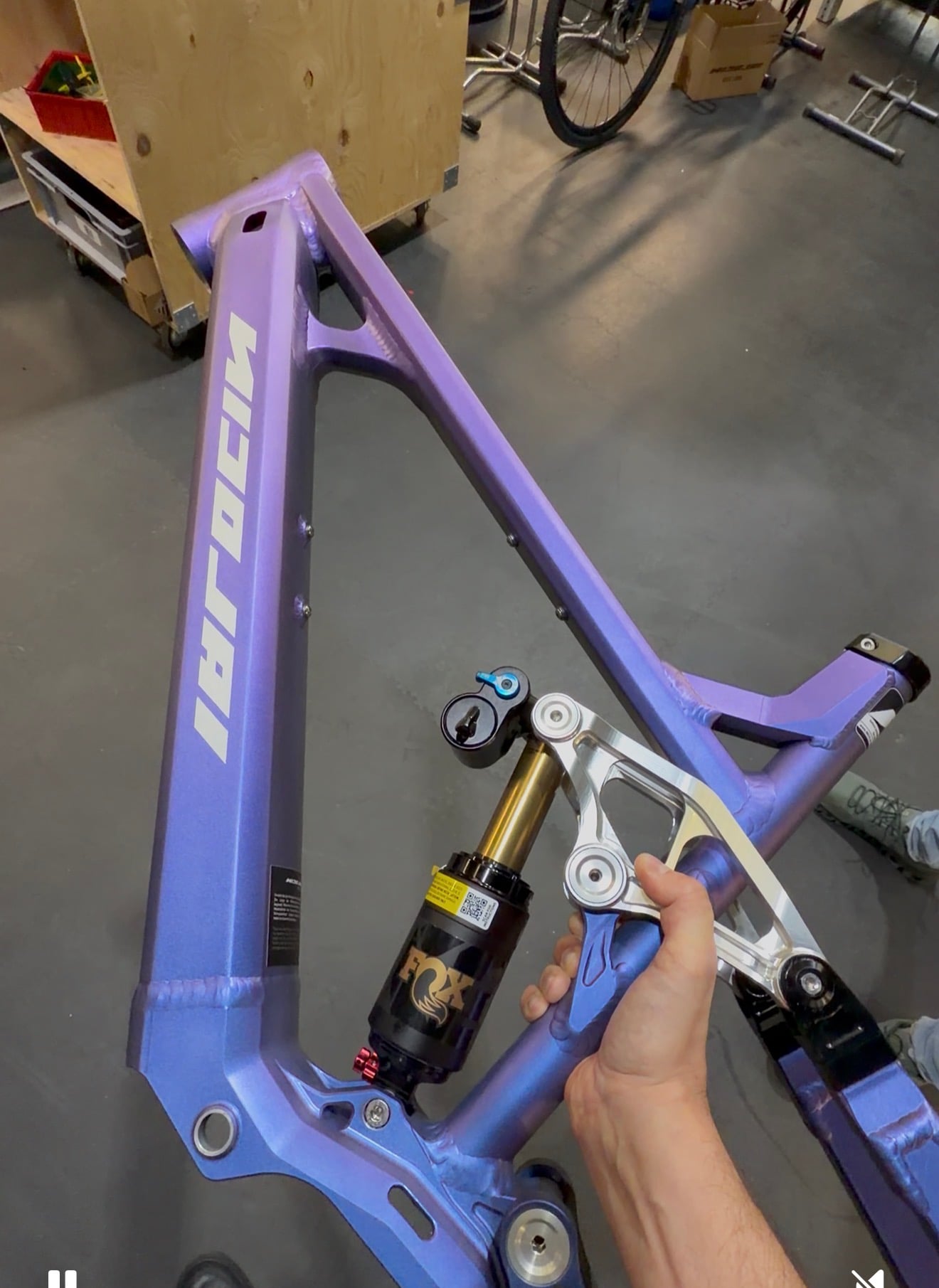

Just been informed my frame kit has been delayed until calendar week 40 :(
Oh no - any reason why? Thats the end of September I think?
Apparently some of the pipe profiles will arrive later than expected - I'm not sure what exactly these are other than they're from an external supplier? I've asked how sure they are about week 40 too. Mine's a size small btw so fingers crossed it's something size specific and won't impact yours!
Amazing. Beautiful colour! Mine should be ready next week too, can't wait!
Thats great - really looking forward to building mine too! I haven't seen the paint in real life yet, but it should have a little two tone effect to it, with the Cerakote protection too.
