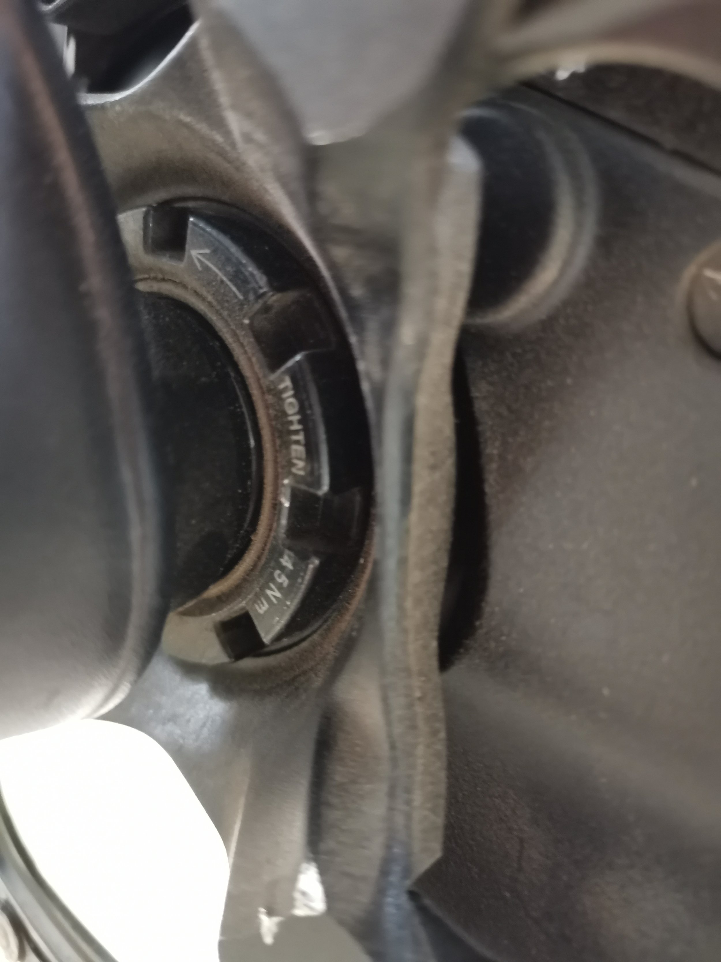

Well that's prophetic haha this came loose today, hand tightened on trail off to the shop Monday I don't think I've anything to tighten that up with
Tiny bit of lock tight on the bits you don’t take off on a regular basis won’t do any harm. Once you’ve been over them a few times in the first month there ok after that 👍

ok bike fixed, ready for the weekend, will see if I can go tubeless then too, doesnt look like it would take too long
