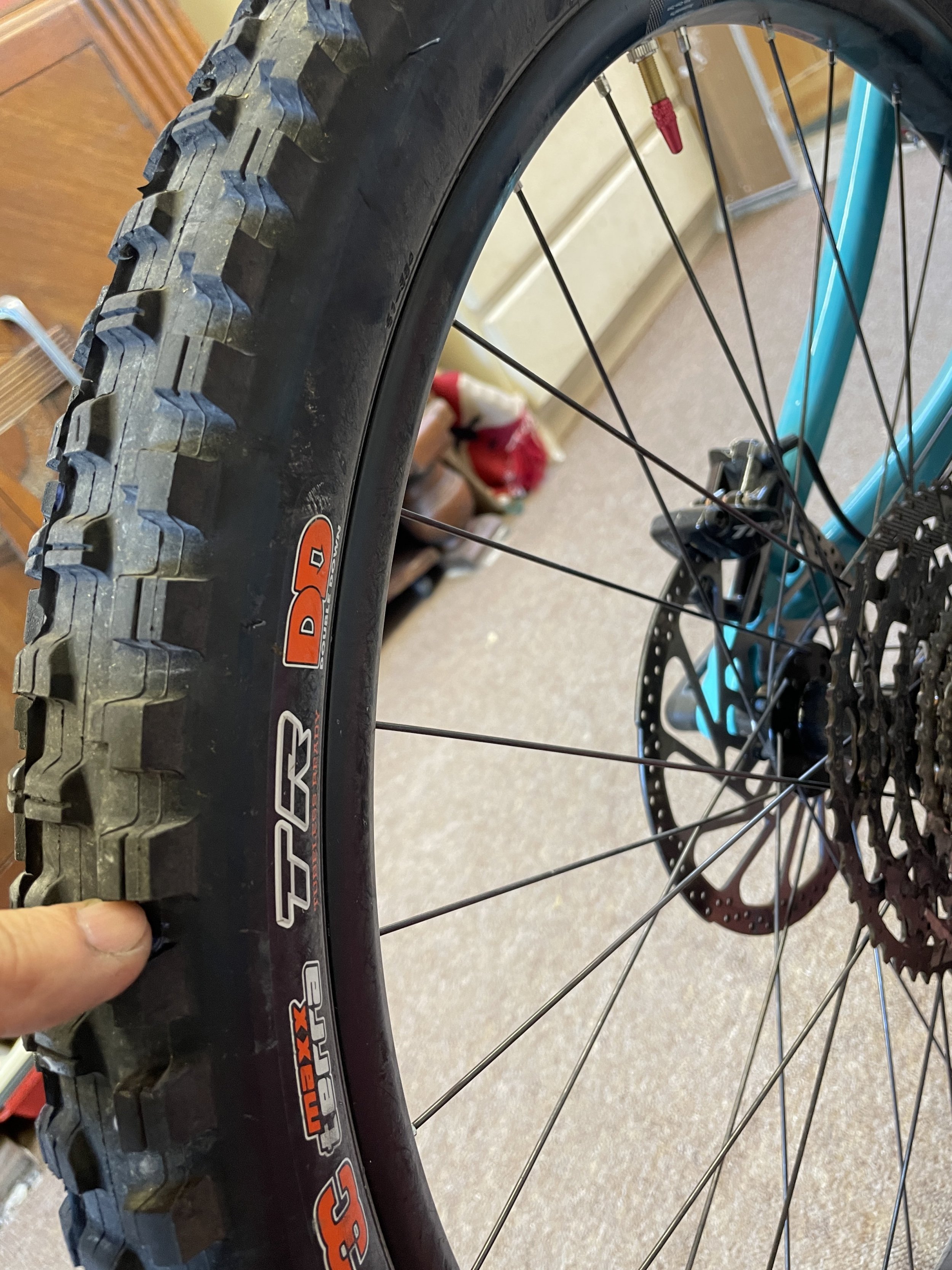

My new Whyte is my first bike without an inner tube and I just found a long thorn in the back wheel.
I pulled it out and hisssssss , so I turned the wheel so the hole was facing down and it sealed immediately with a little bead of white sealant showing.
So great, this tubeless stuff really works!
But what do I do now?
Should I:
  1. Ignore it - the thorn is about 1mm in diameter and the leak sealed immediately.
  2. Run and get a tubeless plug kit (with the licorice string) today and plug the hole before riding again.
  3. Plug it when I get time.
  4. Something else?

"Run and get a tubeless plug kit" and take it with you so that if the hole unseals when out you can plug it there and then. Last time we had this (Hawthorn trees everywhere) the plug blew out but another one got us (my wife) home. Educational because after showing her what to do she bought her own kit and takes it whenever she's out.

I have pulled thorns like that from tyres several times...........never used plugs and never had any subsequent problems. So just leave it.

I would ignore it. Don't pull the thorn out to start with if possible.
I think I have more than 2 dozen in my front tyre and it still fine.

I would ignore it.
If I saw a thorn sticking out, I would remove it and do what you did, rotate the wheel.
In normal use; the thorn strikes, the wheel rotates and breaks off the thorn, then sealant seals and I am completely unaware of what has just happened! :)
I once used a sealant that was fluorescent green; it left a green spot where the puncture was if the bike had been unused for several days. I counted 24 punctures on one tyre and 22 on the other! :eek: Both tyres behave perfectly normally. Just think of how many trailside tube replacements/repairs I had avoided! :love:

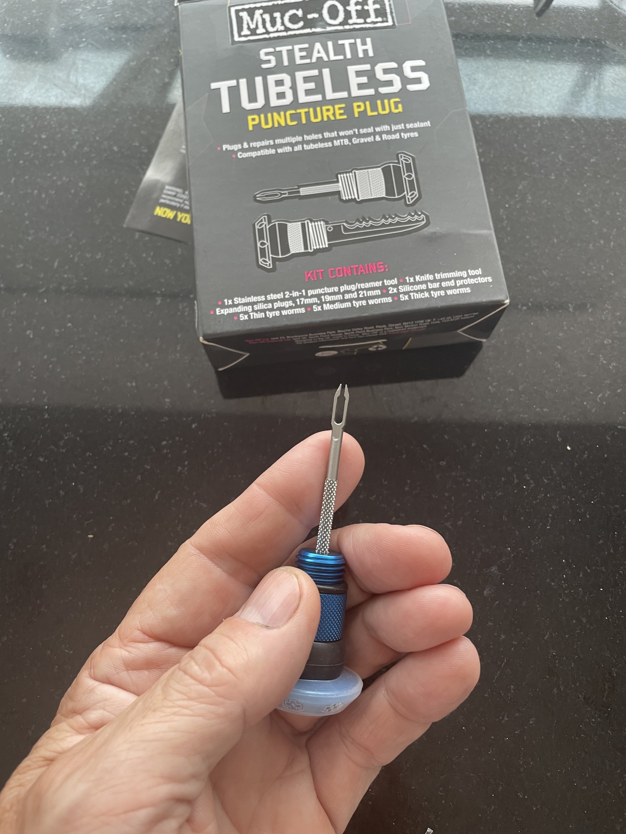

Thanks for the tips.
I did get a MucOff bar-end puncture kit but did not use it and will not - unless the puncture leaks again.
Looking at the insertion tool I wonder if forcing a 4mm wide fork into a tiny thorn hole could end up doing more damage to the tyre vs just letting the sealant do its thing.
Also the MucOff box says right on the front Plugs and repairs holes that won't seal with just sealant.

you still need to take an innertube for anything you can't plug.
Also you will need to redo the sealant every few months because it will dry out over time
