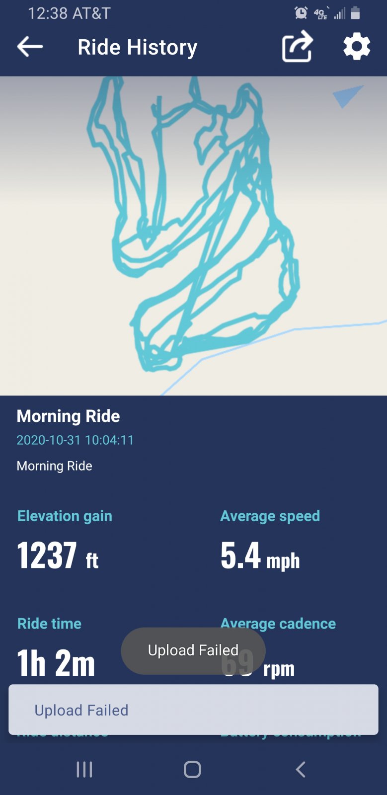

Lol. I used the new ride control to upload to strava and below is what I logged.

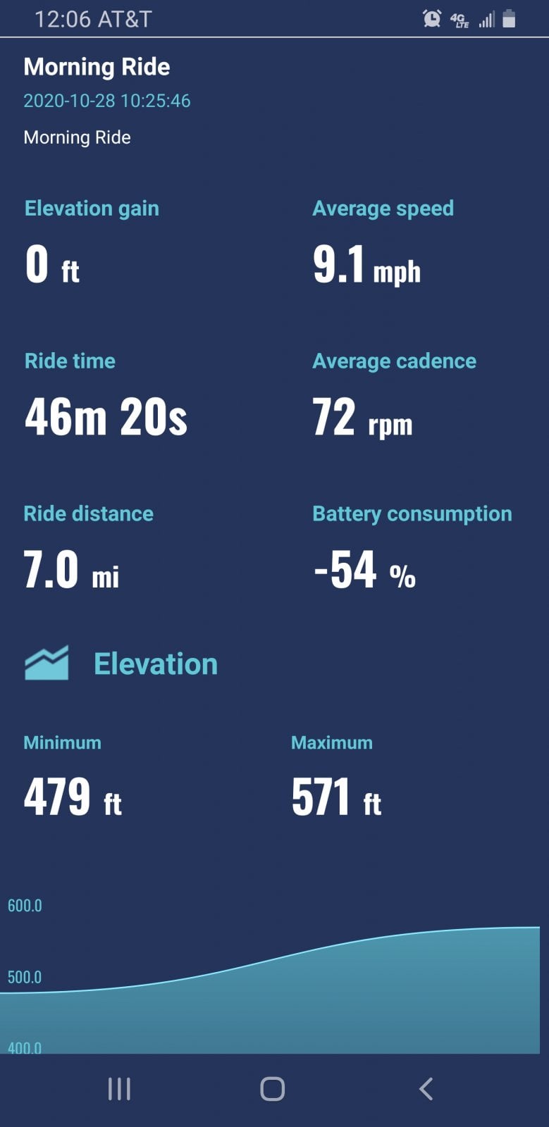

Here is what the ride control showed for the same ride as above. This is clearly a phone GPS issue. I think the bike logged a fairly accurate ride. GPS to strava... I don't think it's correct.

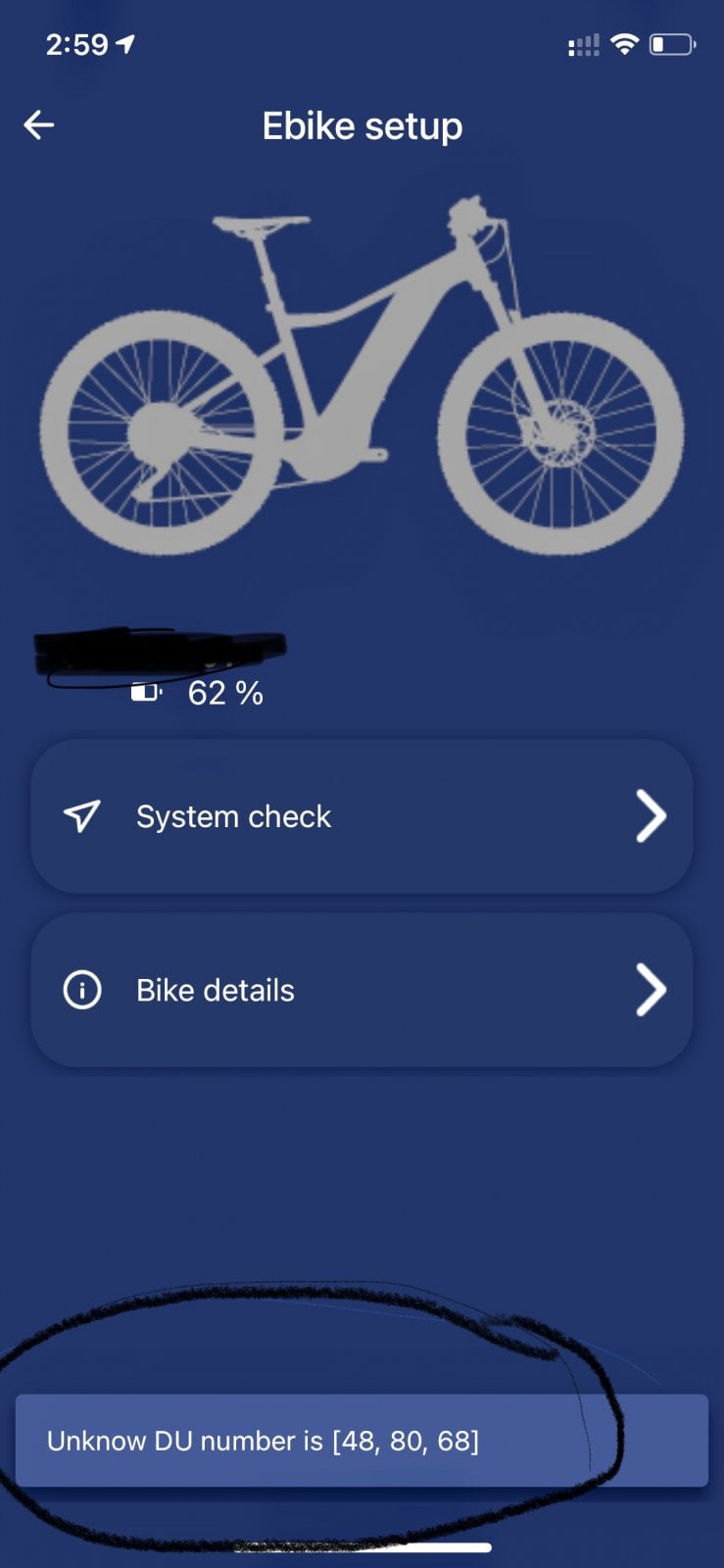

I don’t get the full menu to tune the motor. Plus I get a sort of error. It does read and check the bike for battery, km, charge cycles..

I suspect that error is coming up because our bikes are so new that our bike serial #s are not registered in their database. Which may also explain why we are not seeing any tuning capability yet.

My ride failed to upload yesterday as well.
Today's ride failed to upload also. Apparently the Gaint app launch is a bit of a flop. Apps bore me anyway. ?
