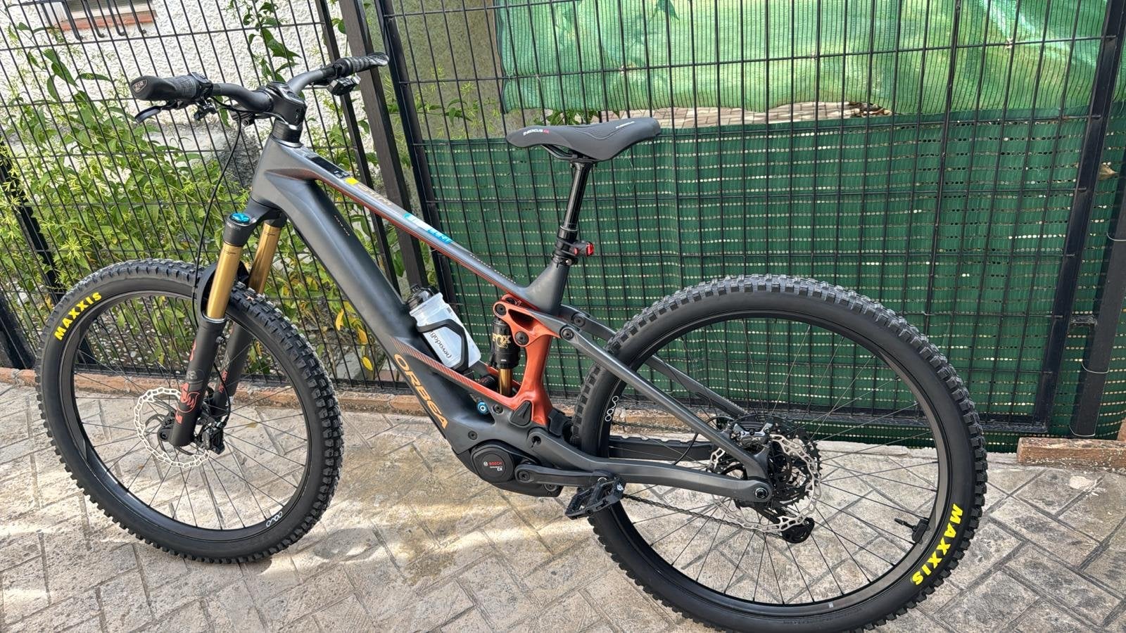

Meanwhile, a Pic of my new ebike
It is not perfect (I am very very picky) but if it is good enough for me, it is good enough for everyone :D
And I am telling this after returning a new Turbo Levo Gen4 Comp because of paint defects and choosing the Orbea Wild instead :D
P.D: I appreciate that they now include some protector vinyls preinstalled (not perfectly installed), but I have added lot more. I like to protect my bikes!
