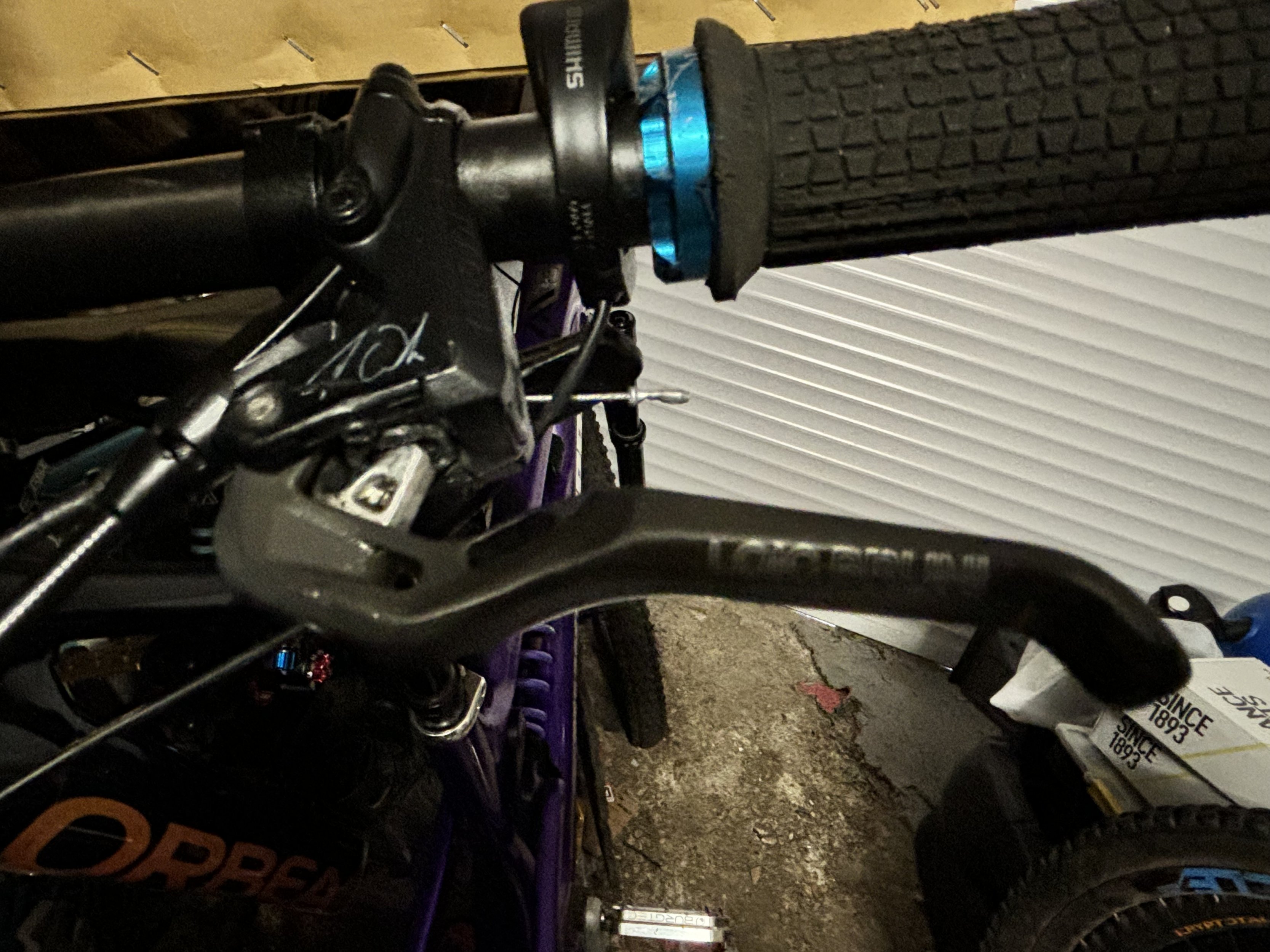

Just got my new Rise today, it's got a completely different bar/computer setup to the old one and i can't work out where the Dropper Lever should actually be.
IMG_20240325_095602 by Steve Weeks, on Flickr
IMG_20240325_095607 by Steve Weeks, on Flickr
There's not enough space due to the Shimano tab/limiter to move it inboard.
No matter where i seem to put it, the lever is almost touching the controller and it's really not a perfect setup....
I could of course move the computer to the inside and the dropper to the grip side... but i'm not sure that's right.
What has everyone else got/done ?

I solved exactly the same problem (of not having the dropper lever exactly where I wanted it) by replacing the I-Spec EV brake lever with a I-Spec II lever which doesn't have the outer tab.
Yeah i'm slightly torn on the lever at the moment. That one above is a cheapy one i bought for a different bike half a lifetime ago, but it'd do the job. But yes absolutely there are nicer ones out there, there's the hope, but i think they're direct mount and would need a band setup, Wolftooth i like, also One-up... I'll see how this one goes for now.

The brake location is set on Shimanos be a de-limiting tab/bracket, so is set about correct for orientation from the grip. They've done that for the last 5 years.

what?
it needs to be there:
fyi, that’s how i had it on my rise gen1 and how i run all my shimano levers:
that way the tip of your index finger is exactly on the end of the lever. i can’t even imagine how you one finger brake on your setup. do you only grip half of the grip?
New bike levers are set "outboard" or closer to the end of the bar because it's the easiest thing for the shop employee to do during the initial build setup (time = money). It's assumed/ understood that the rider will move the controls to the position that suits them best during the purchase or after.

TBH with that dropper lever, you really can't anyway... it's just not 'right' in any position. The brake de-limiter tab doesn't help, but it's stil pretty much a deal-breaker, hence the fact i've cut it off and fitted a different one.
MAte, that's not 'my' setup. That's how the bike came from the dealer this morning in a box.
what?
Moving it to there still wouldn't have resolved the issue of the dropper being too close to the newer controller, it's bigger than the previous one, both from the front and the housing underneath. It wasn't the brake location that brought on the problem.
It's now like this,
IMG-20240325-WA0008 by Steve Weeks, on Flickr
But you're still correct that the lever isn't exactly ideal there for 1 finger braking. But that's mostly due to the levers being massively long :D
Hence why i'll likely fit the Codes, especially as they're also my preferred brake and my boys (well, RSC on all of his).
