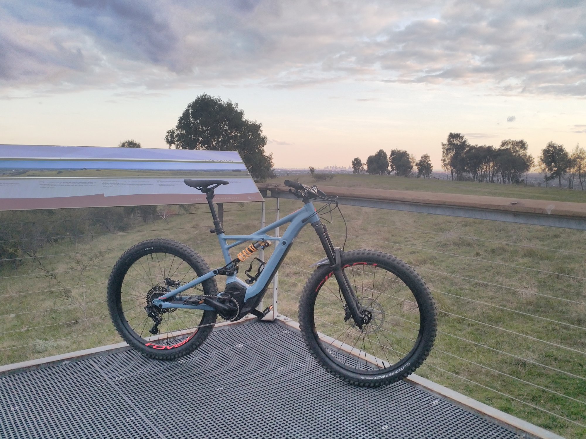

My Medium Kenevo. I'm still running the original 125/150mm WU post but the option of installing a Bike Yoke 185mm dropper is there if needed. With riding weight just short of 95kg the stock 457lb/in spring has been replaced with a 550lb/in Cane Creek Valt spring.
Seatpost up.
Seatpost down.
