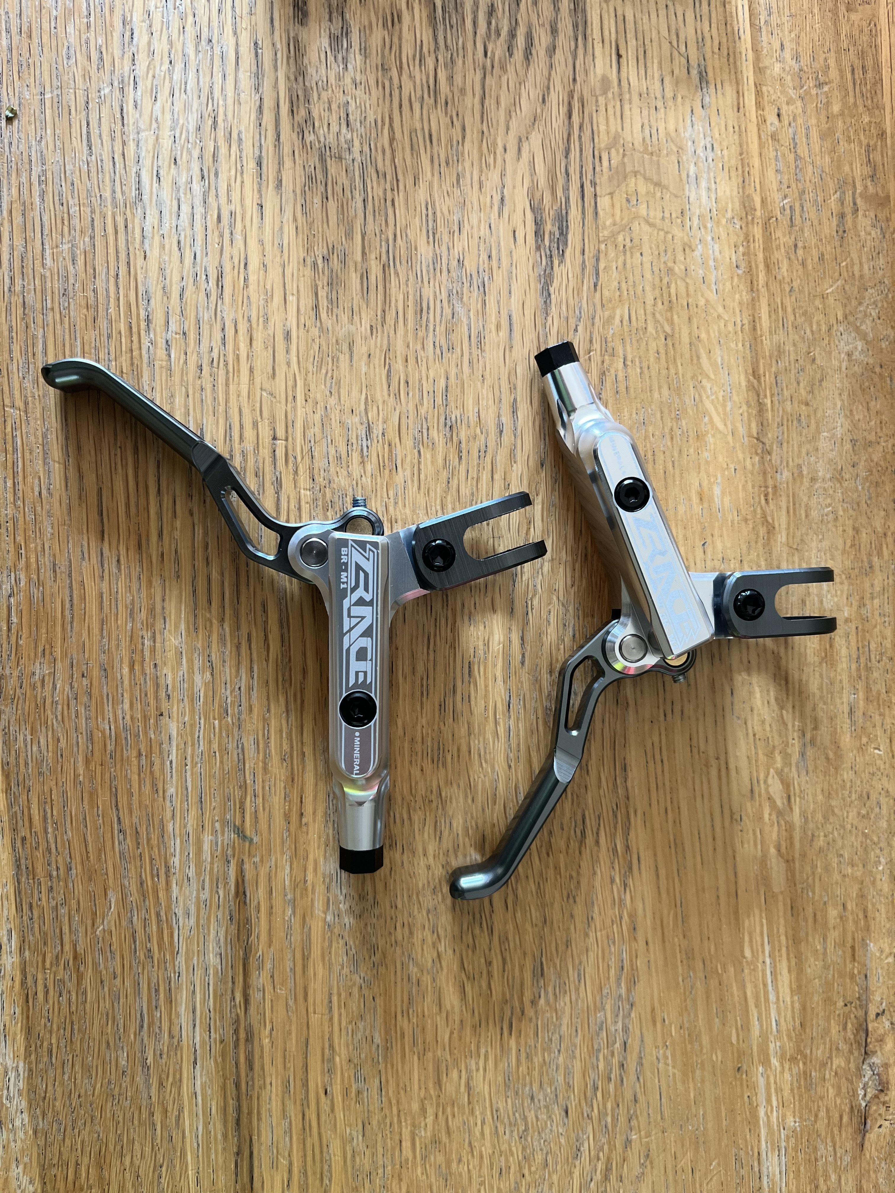

They are running fine with the MT5 calipers, didn’t even have to bleed when swapping over & had to put in new olives etc. they are bit more like running Shimano levers more an on/off feeling but no wandering bite point what’s not to like
do you know for certain that those zrace levers will work well with magura mt5 calipers? They didnt get glowing reviews in this thread here on mTBR

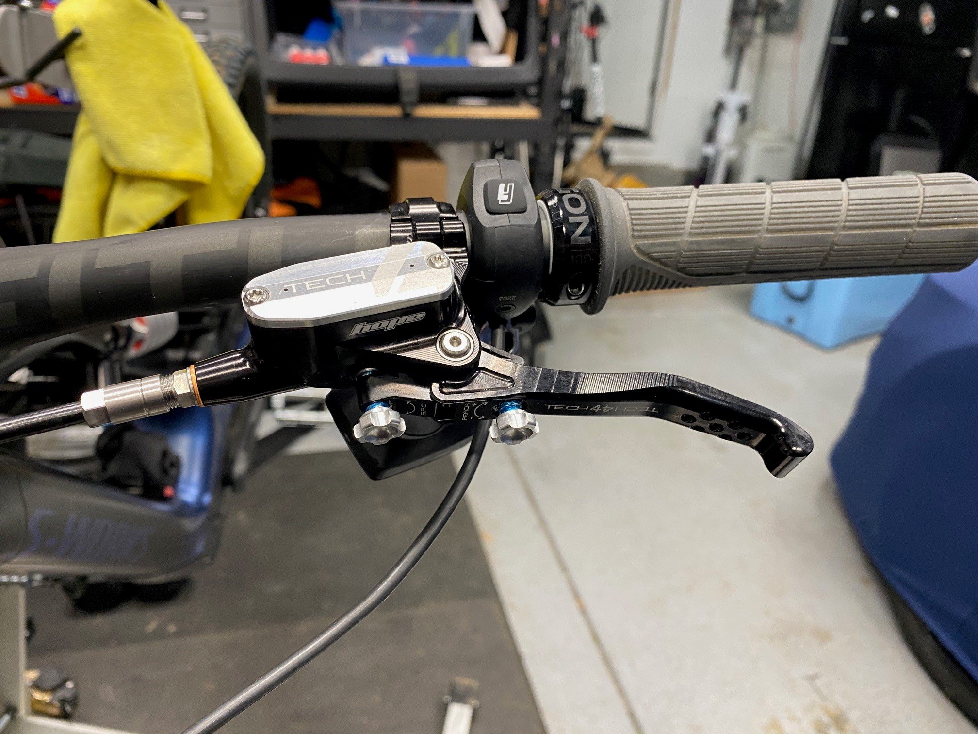

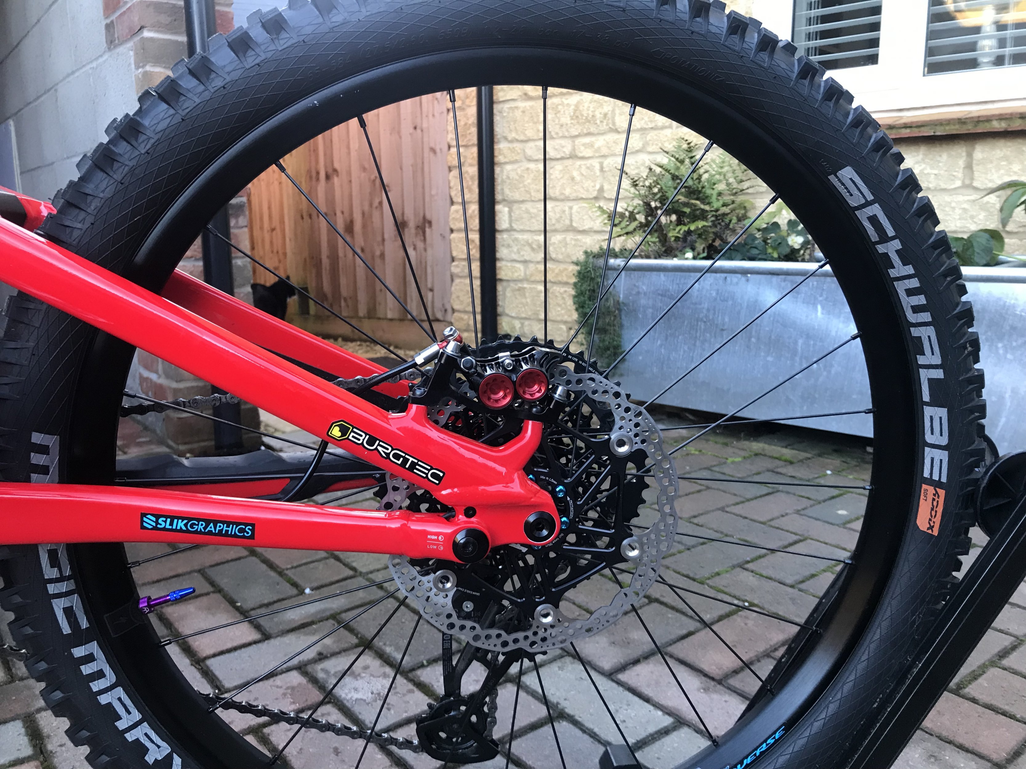

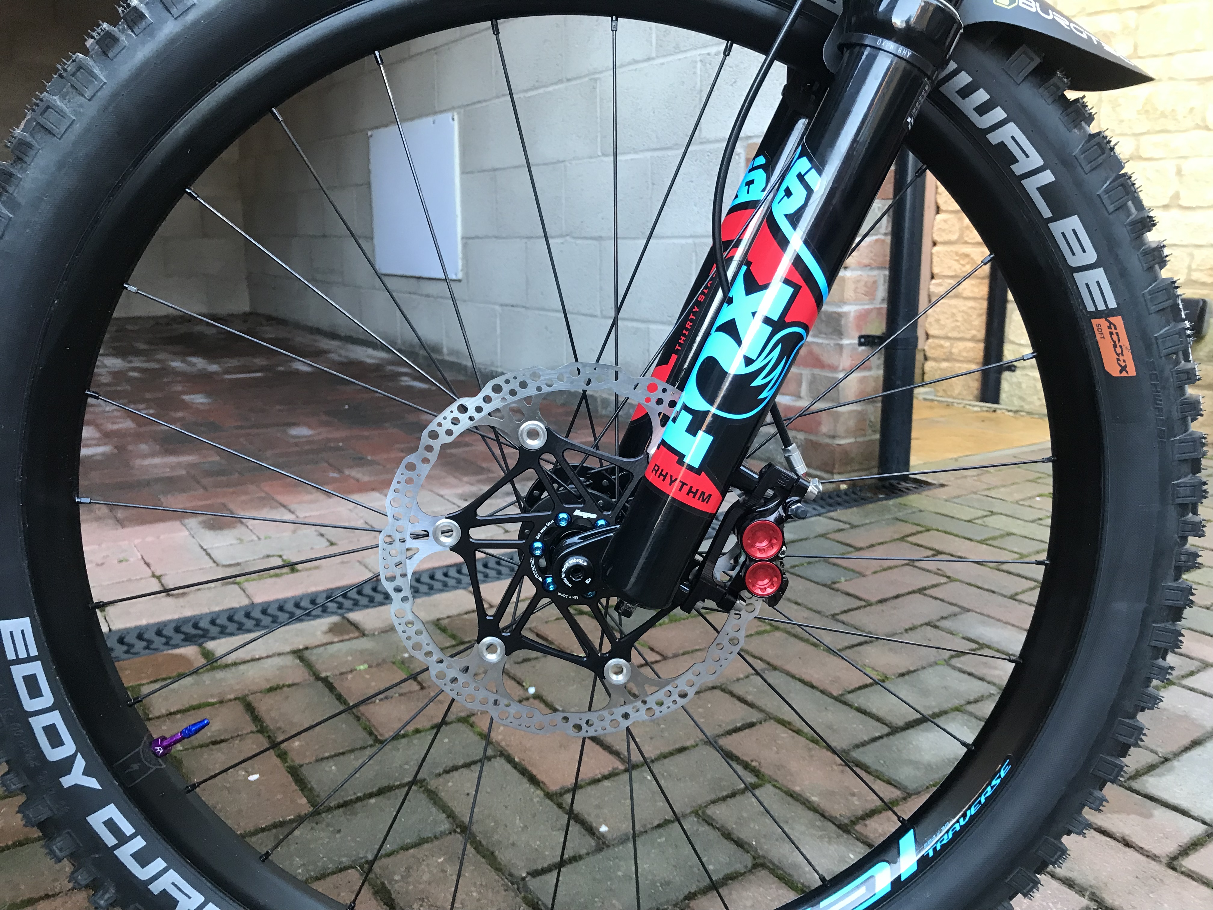

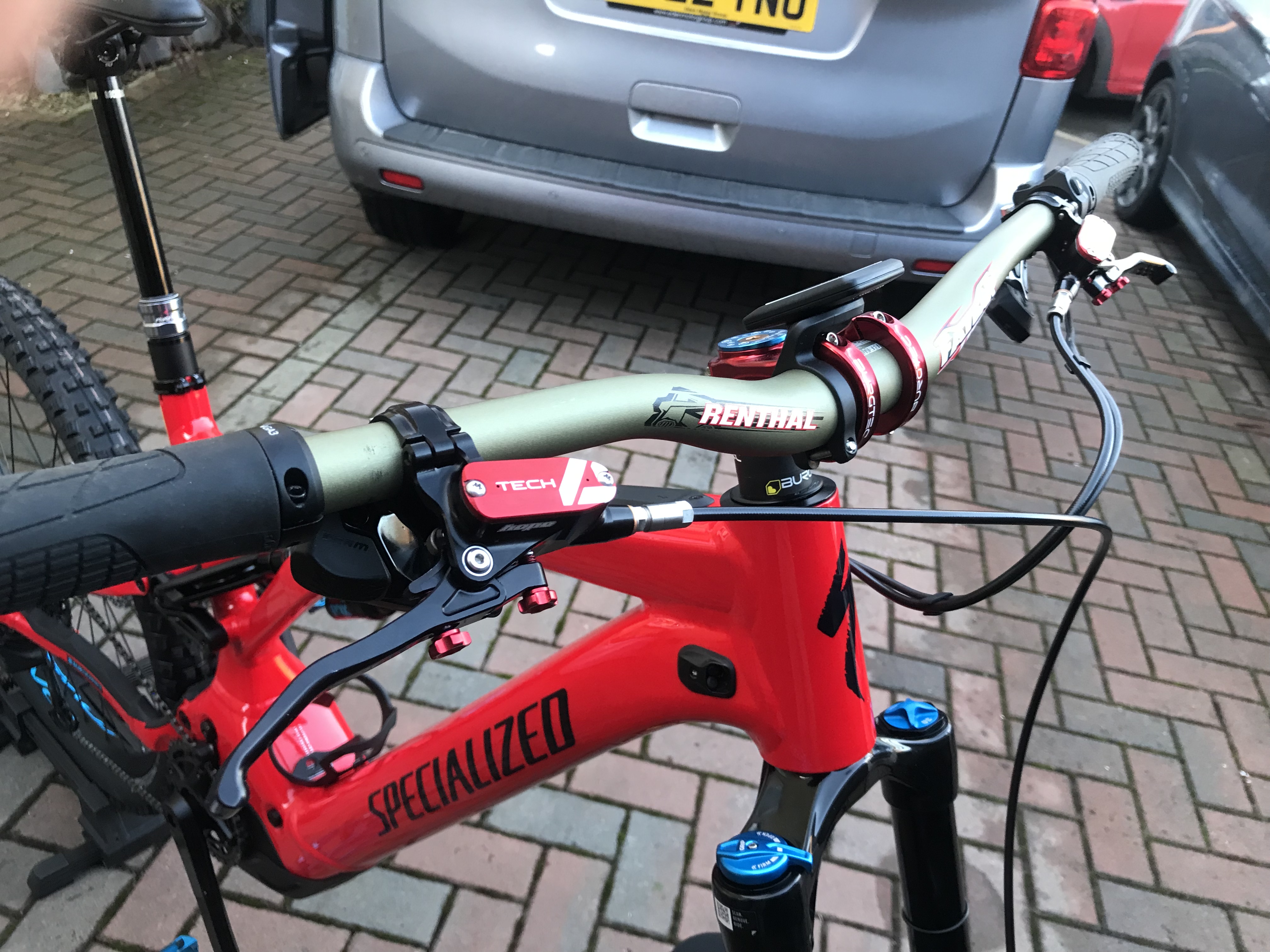

Just put the new Hope Tech 4 V4s (with 220s front and back) on my 2022 S- Works Levo. Swapped out the MT7s which I had also run for a few years on my previous 2019 Levo. Thought the Maguras were great from a power and modulation standpoint. Just hated the Carbotech material. I think the Hope's perform very consistently with the MT7s based on my initial shake down yesterday. The levers are amazing. I think the action on the lever is really nice with the roller bearings and love the no tool adjustability. SRAM adaptability is 100% better than the Magura Matchmaker setup. Quality is simply out of this world. Very happy.
