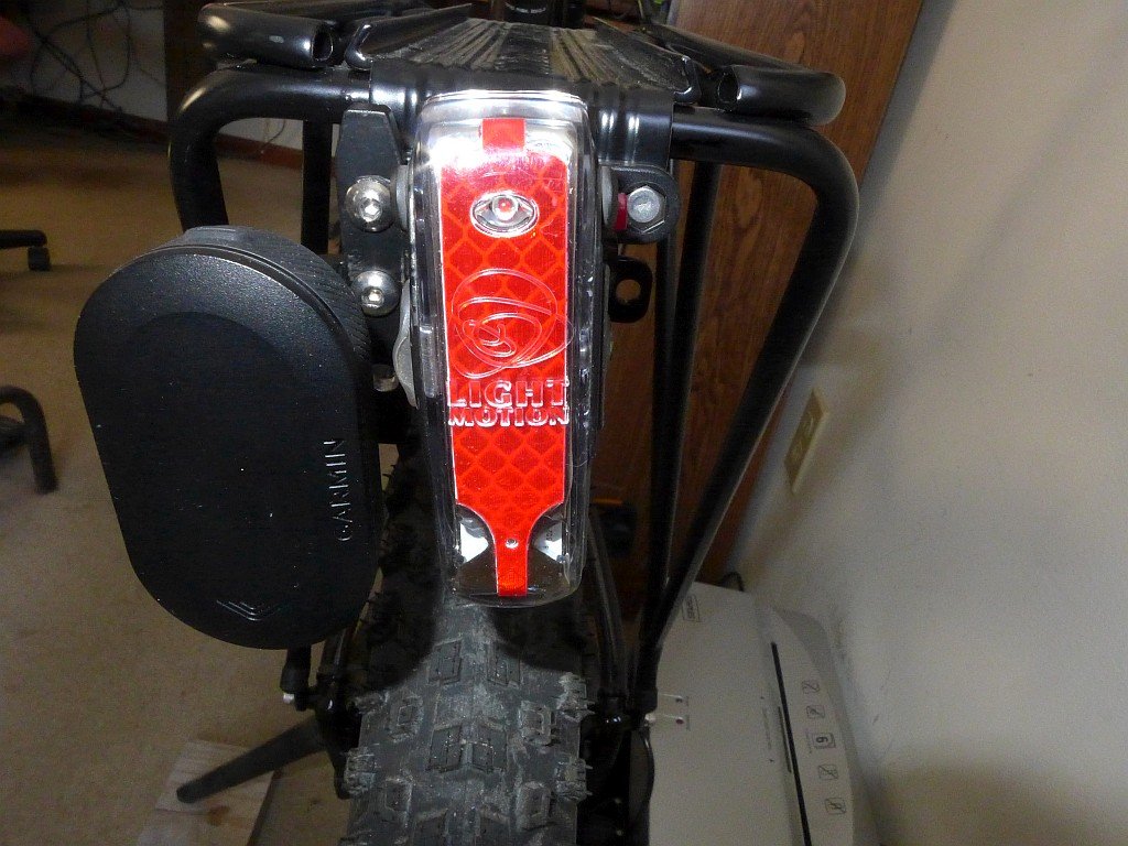

In addition to the above, I just ordered a Garmin Varia RVR315, the rear radar without the light. I have lights that are much brighter than the Varia. I will attach an additional cell phone charger to it to increase the 8 hour battery life. The challenge will be attaching the Varia and one of my good lights to the back of the Topeak 29er rack.

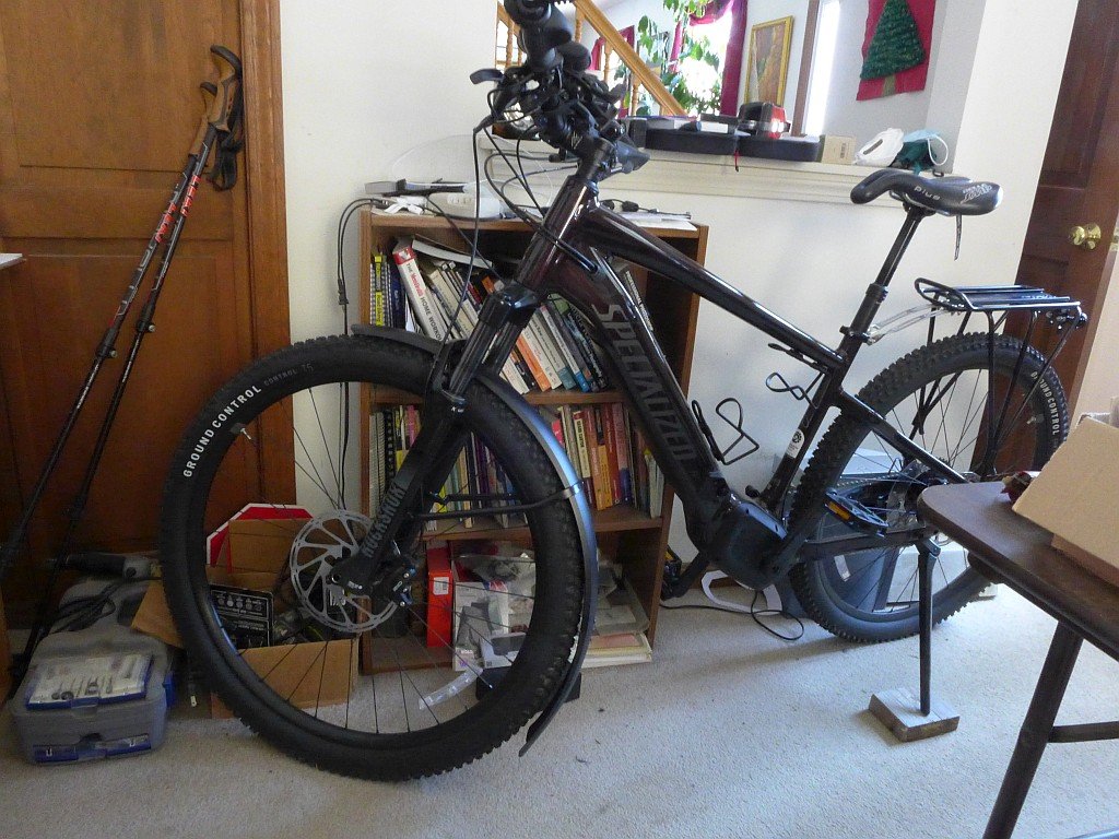

I like the bike. It suits my more upright riding style. It has sufficient battery capacity to easily do metric centuries. I don't think it would do a century unless I was really careful with the power. Perhaps in a low micro tune mode, say 20 or 30 I could do it on a reasonably flat course. I put the Specialized front fender on, and removed the lower rubber section. I had the bike shop change the wheel diameter to what my Garmin was using. I got some good toothy pedals, so my feet don't slide off.

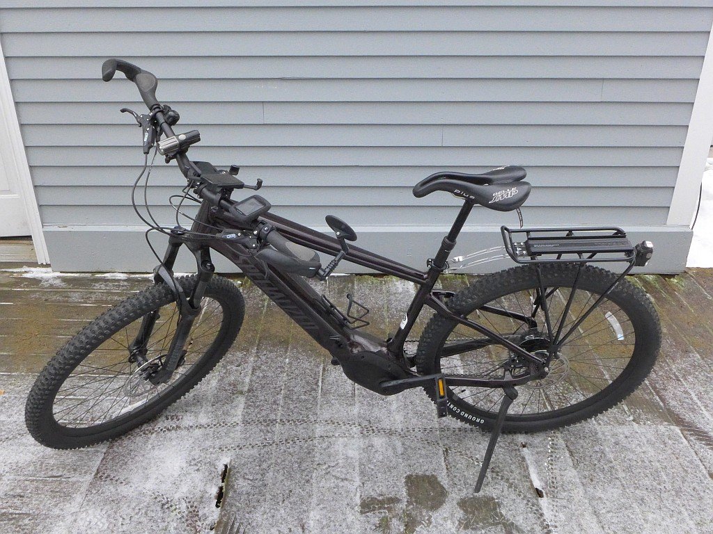

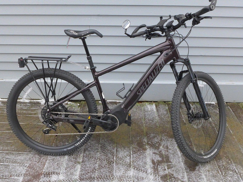

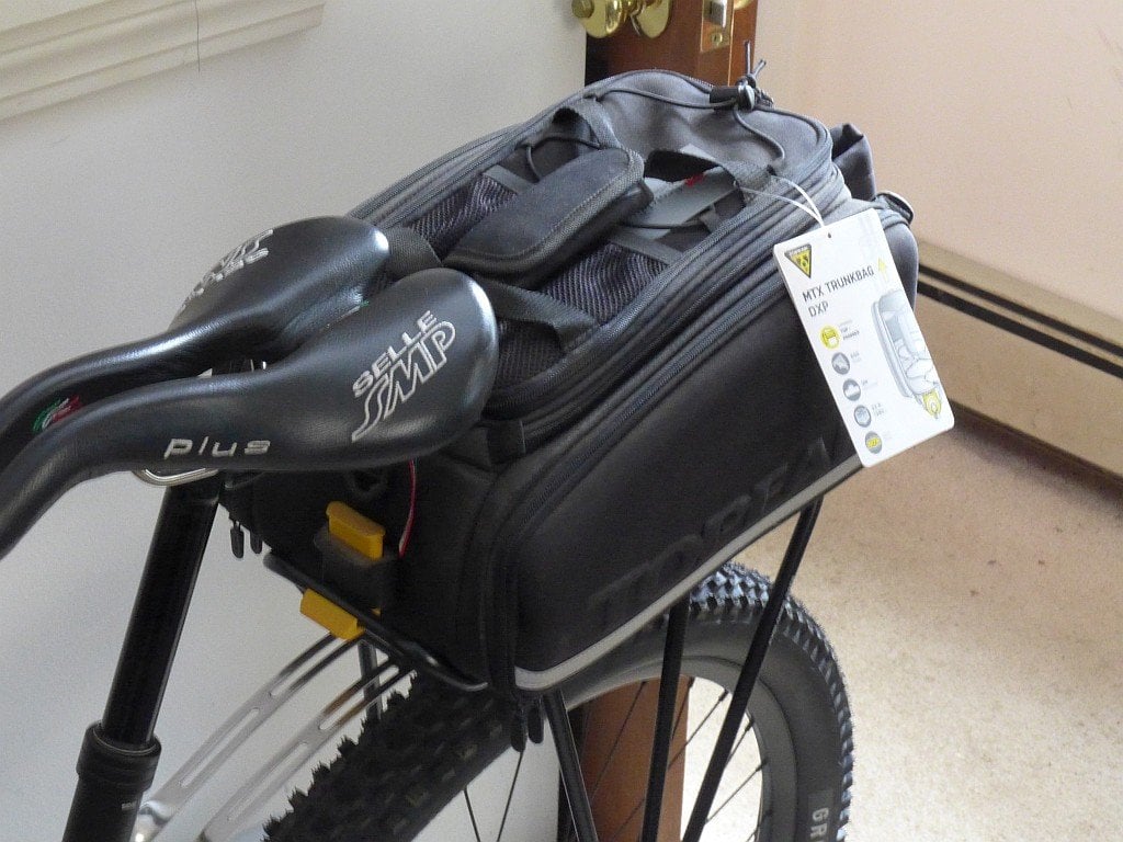

Some images of the bike are as follows. Left Side View of  Tero P1010426.jpgRight Side View of Tero P1010428.jpgSeat and Topeak MTX Trunkbag DXP on Tero P1010431.jpgVaria RVR315 and Light & Motion Vis180PRO mounted to bike rack P1010439.jpgSpecialized Tero Front Fender P1010435.jpg
