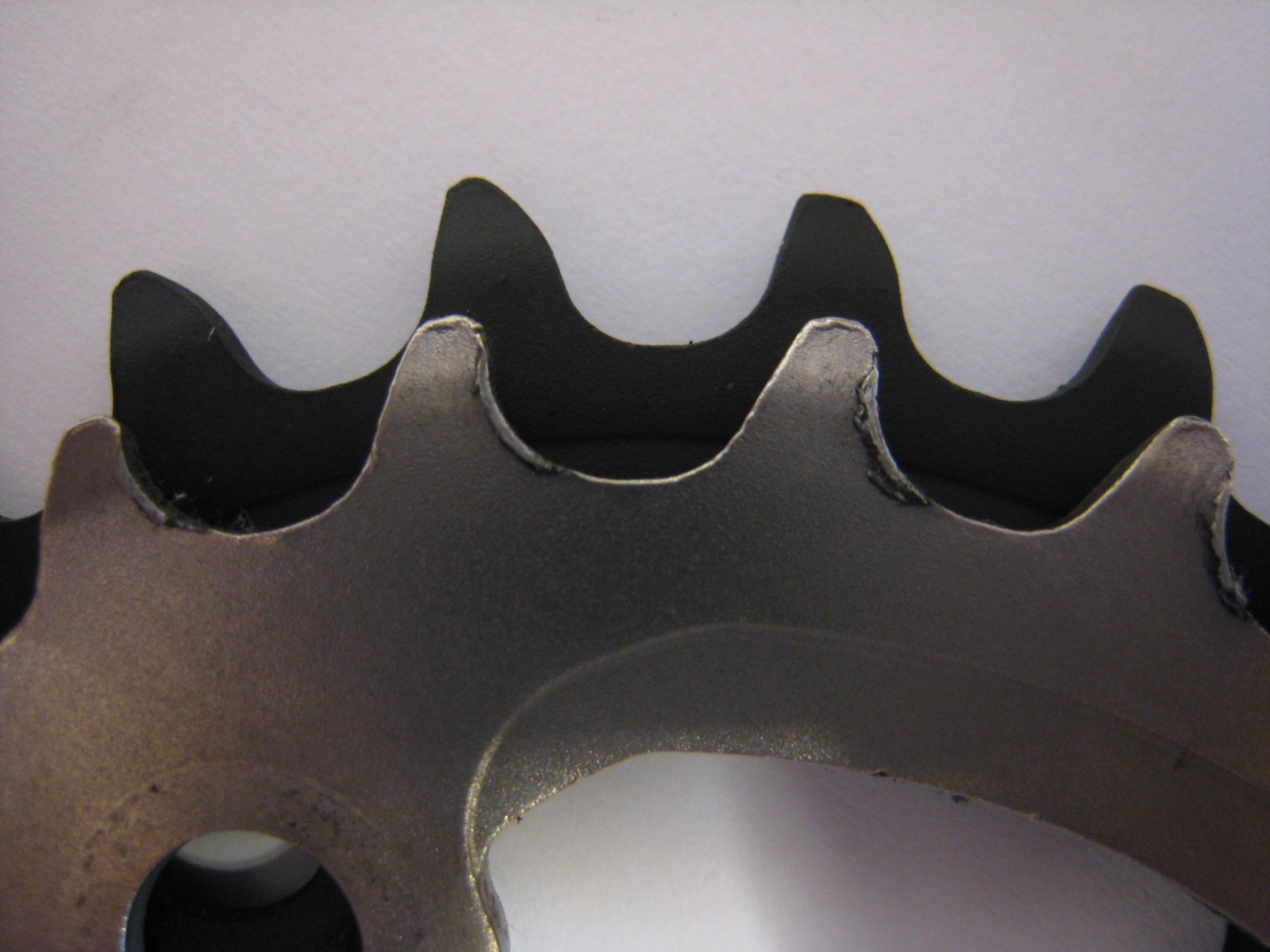

8,429
8,671
I wish I was that brave! I wouldn't know where to start.
Take a look at this for a start. It's picture of a worn front ring sat in front of a new one. Each gear on a worn cassette will look similar but will have a lot of ledges and ramps to assist shifting. Just showing a front ring makes it clearer where the problems are.
There are two things to note:
First is the shark fin profile carved into the tooth faces of the grey ring. Compared to the convex profile of the black ring, the grey ring has a concave tooth profile. The grey ring is well worn. That curved profile can hook onto the chain and cause chainsuck. ie where the chain does not leave the ring on it's way to the back of the bike, but is "sucked" upwards to jam in the ring.
Second is to ask where has that material gone that has been removed from the tooth profile? Some will have floated off as dust or flakes. But as you can see a lot of it has been pushed into forming the burrs at the sides of the teeth, (both sides). Those burrs themselves can hook onto the chain side plates and cause chainsuck on the front ring and impair shifting on the cassette.
A jeweller's loupe or any magnifying glass will help you see more clearly, but with good lighting you shouldn't need one. It is the side burrs that may be usefully be filed off. It is quicker, easier and all round better to remove the cassette from the bike before attempting the filing job. But if you want to do it in situ, make sure that you catch the filings as you don't want them going onto your chain or sticking to the oily cassette. There is nothing you can do about the worn tooth profile.
in my opinion, if the ring/cassette has this level of wear, then it is knackered and needs replacing and probably the chain too! A new chain would probably not run with gears this worn. I would only consider filing off the burrs if I needed to ride before the new kit had been delivered. Don't get me wrong, filing off the burrs will help, but it is very much a stop gap. However, if your gears and chain are all knackered, then it will allow you to get a few more rides before you come unstuck.
