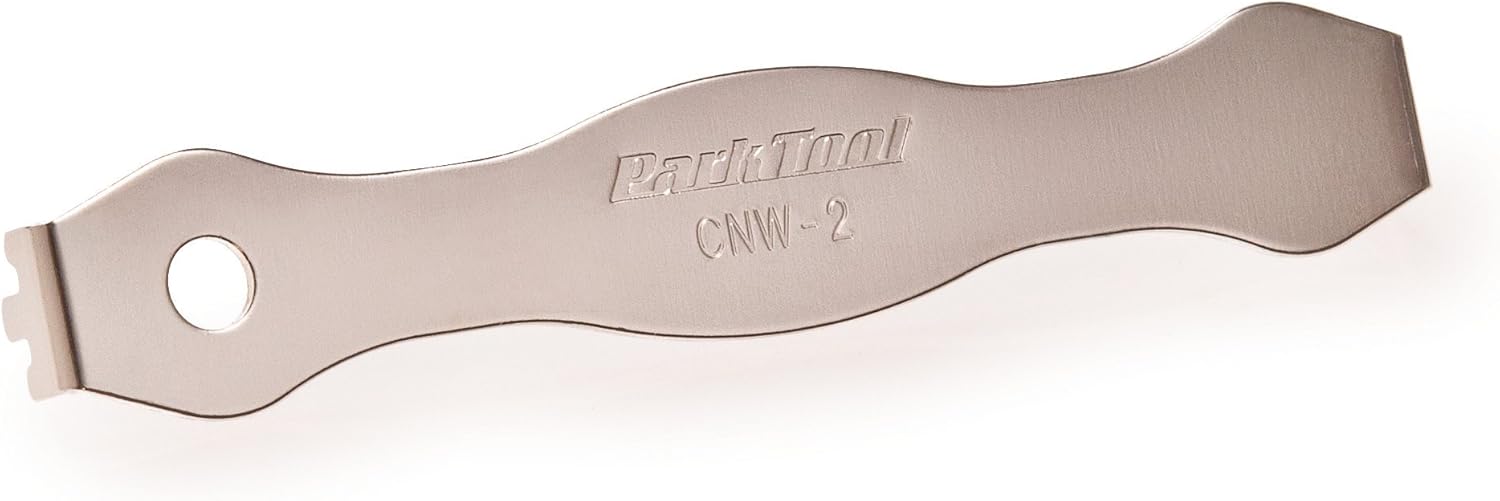

The steps chainring and spider are just 4 bolt 104bcd standard same as most mtb cranks used for the last 2 decades before direct mount bollocks became super popular.
To remove the chainring you just need to remove the chainring bolts. a 4mm hex and something to stop the tabs at the rear rotating. (My bolts were 4mm hex but I changed them to 5mm)
There's a specific tool for holding the tabs and you should be able to pick one up for about a fiver
but you can usually get away with jamming an open spanner in each tab to hold it while you undo the bolt.

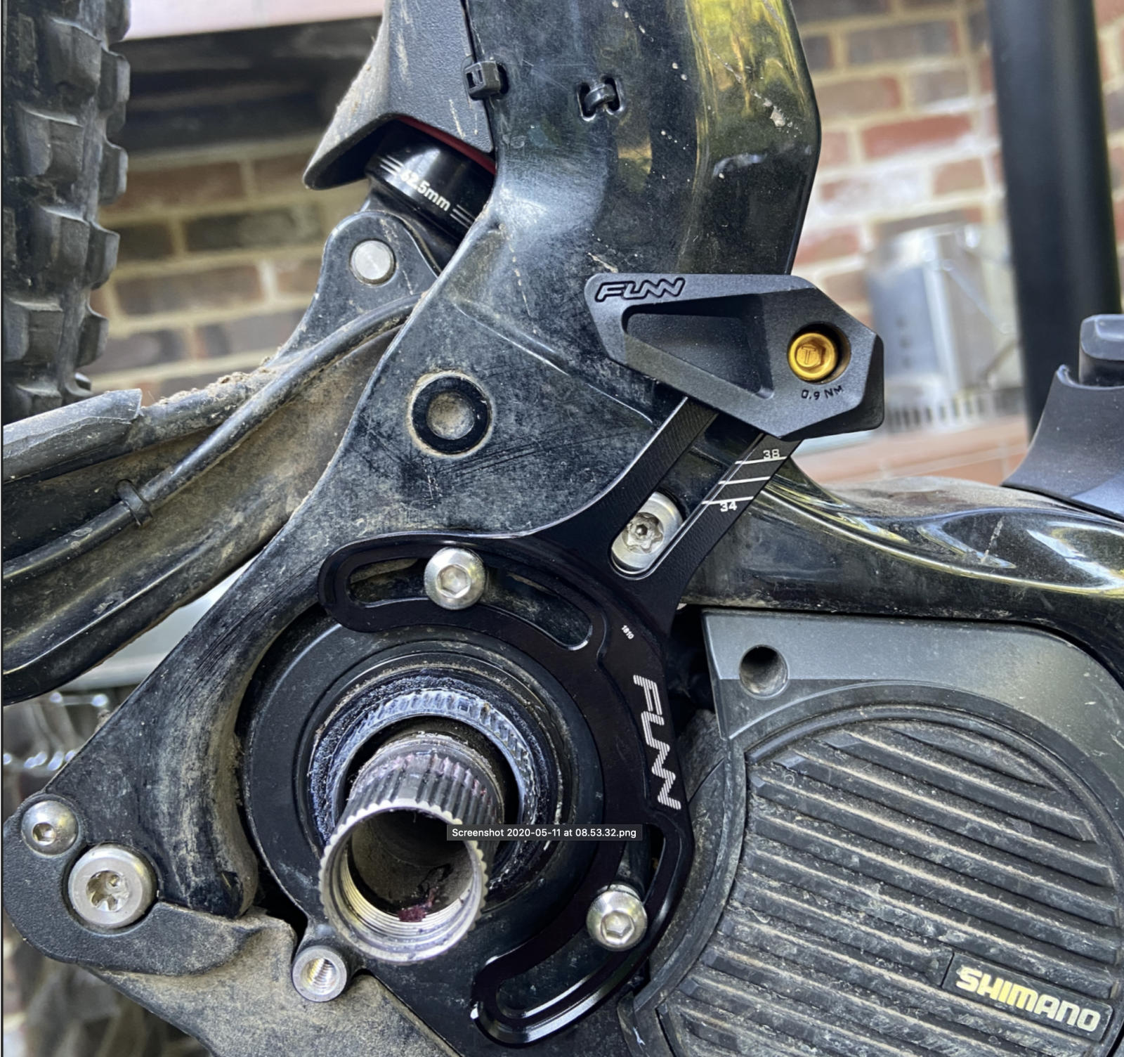

I have tried the stock one, E13, and Funn.
E13 is garbage imo, cheap bit of plastic. I would go with the Funn or Reverse components. I did take the spider off when I replaced mine, so don't know if the OEM one fits over it.
Its worth getting the spider locking tool anyway as handy for maintenance. Neither the Funn or Reverse chain guide need the spider removing to take off and on again though.
