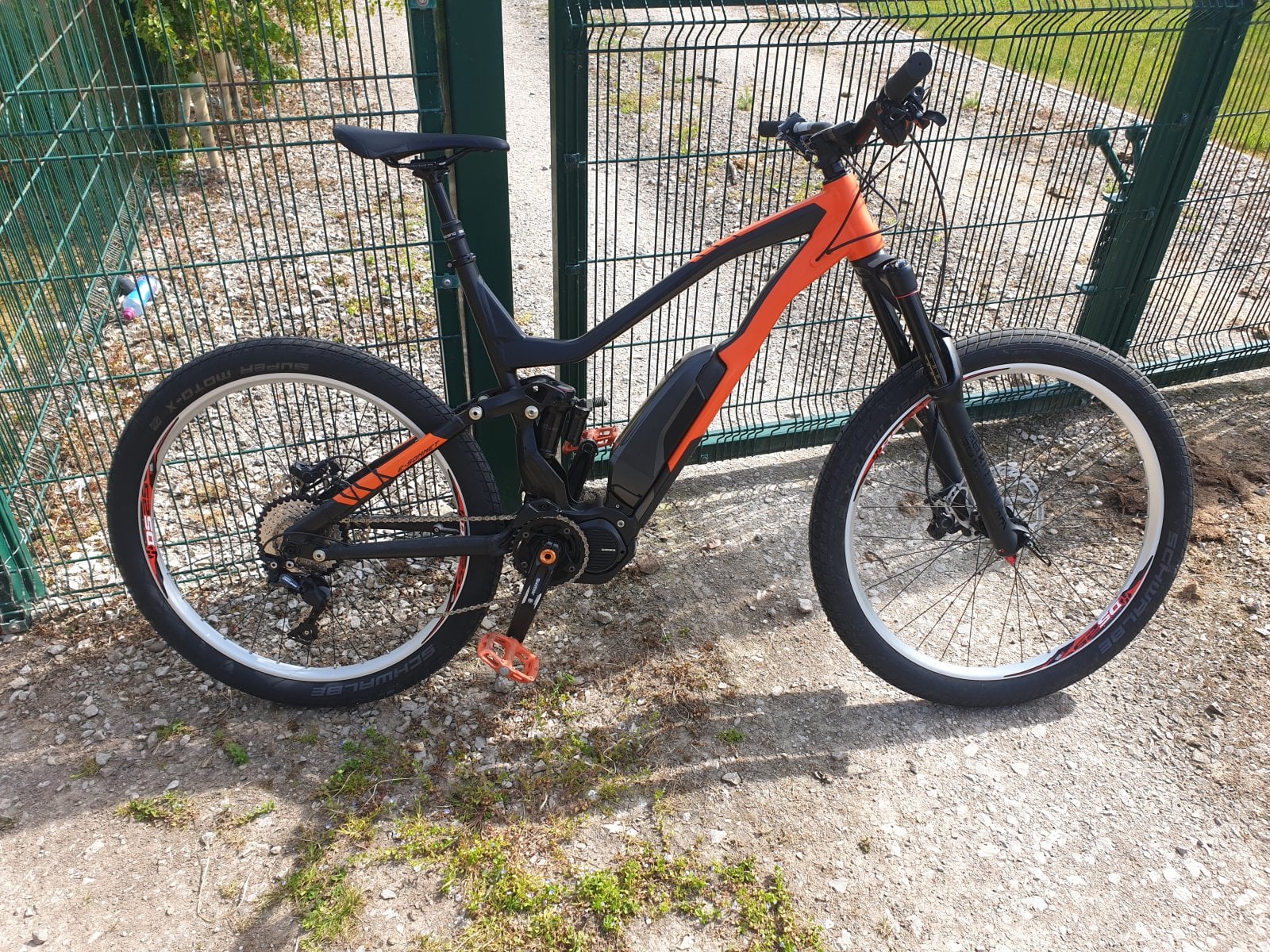

I got some spank oozy 345's on mine with scwalbe moto x tyres, and the thing flies on the road now too! There's nothing better than smoking a ribble carbon rider in a sky yellow jersey on my morning commute :cool:

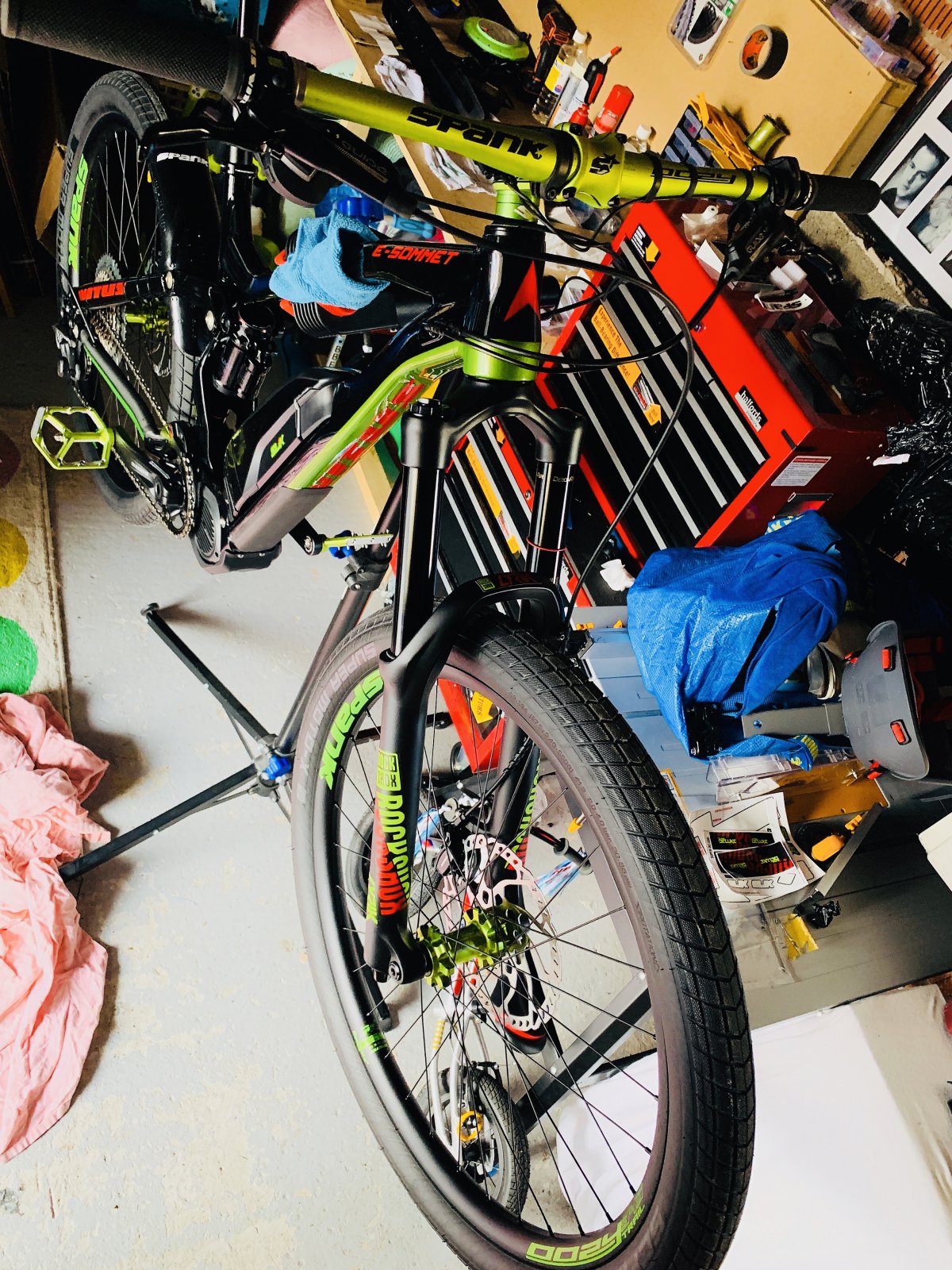

New wheels and parts came and fitted, I wasn't keen on the silver but thought for a extra 2mm width I can live with it, all gears work perfectly and brakes are very slightly rubbing, enough to make a noise when I roll them when the bikes upside down but nothing I can hear while riding and has no effect on speed, I did forget to buy a new wheel magnet though.
