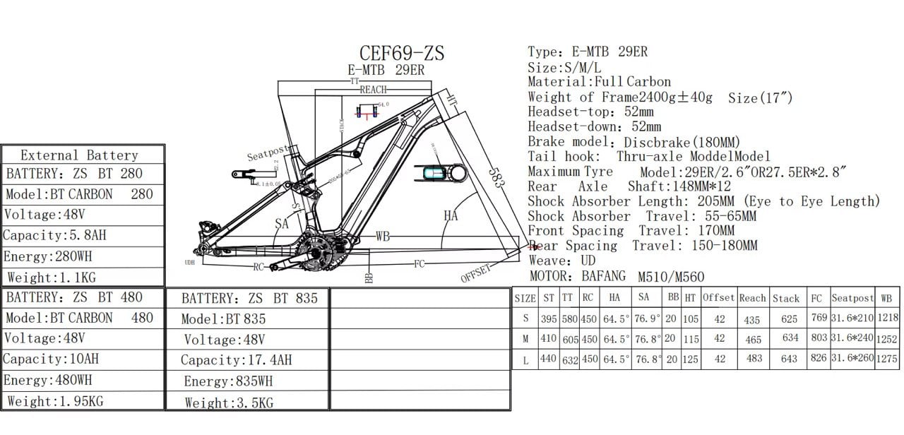

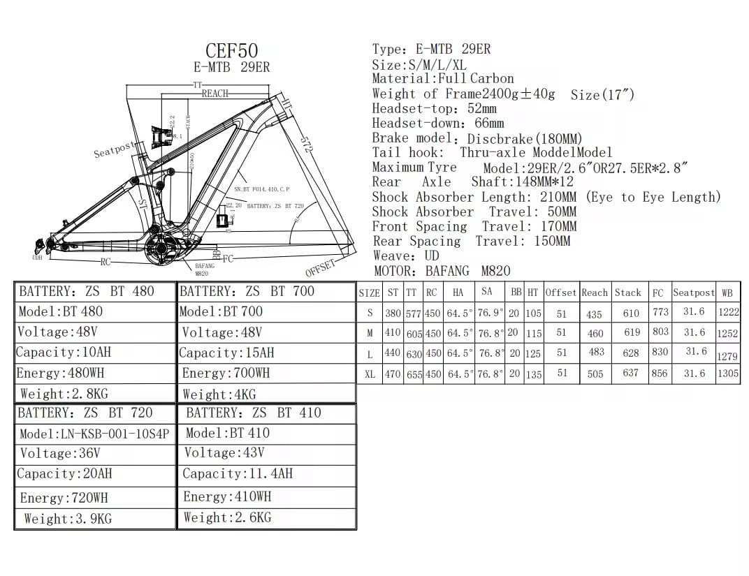

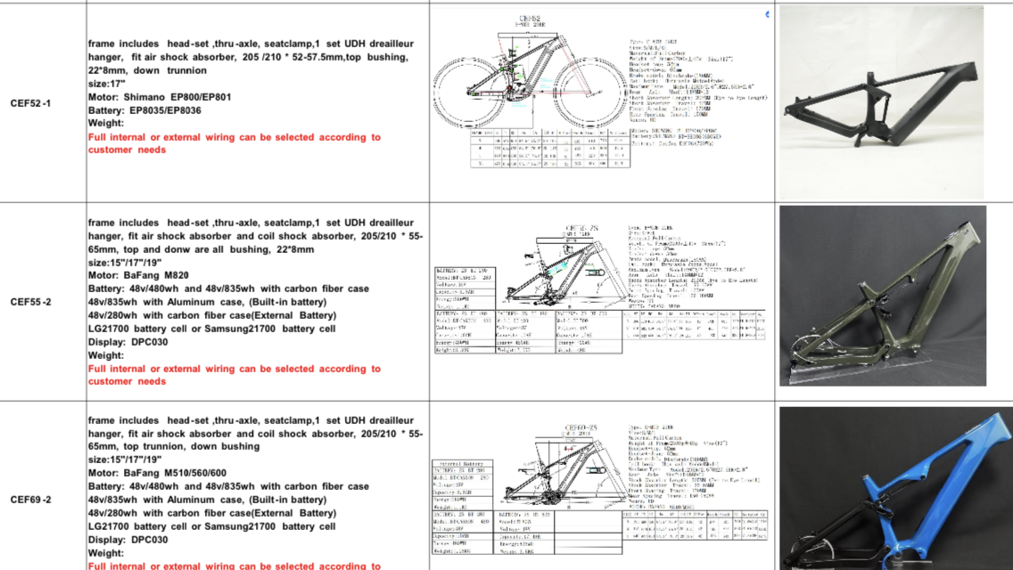

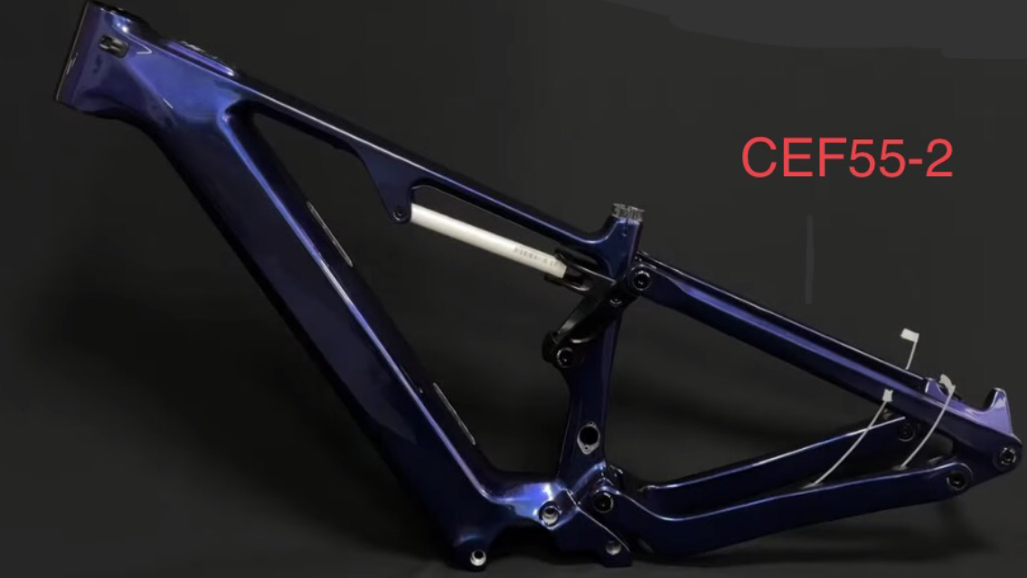

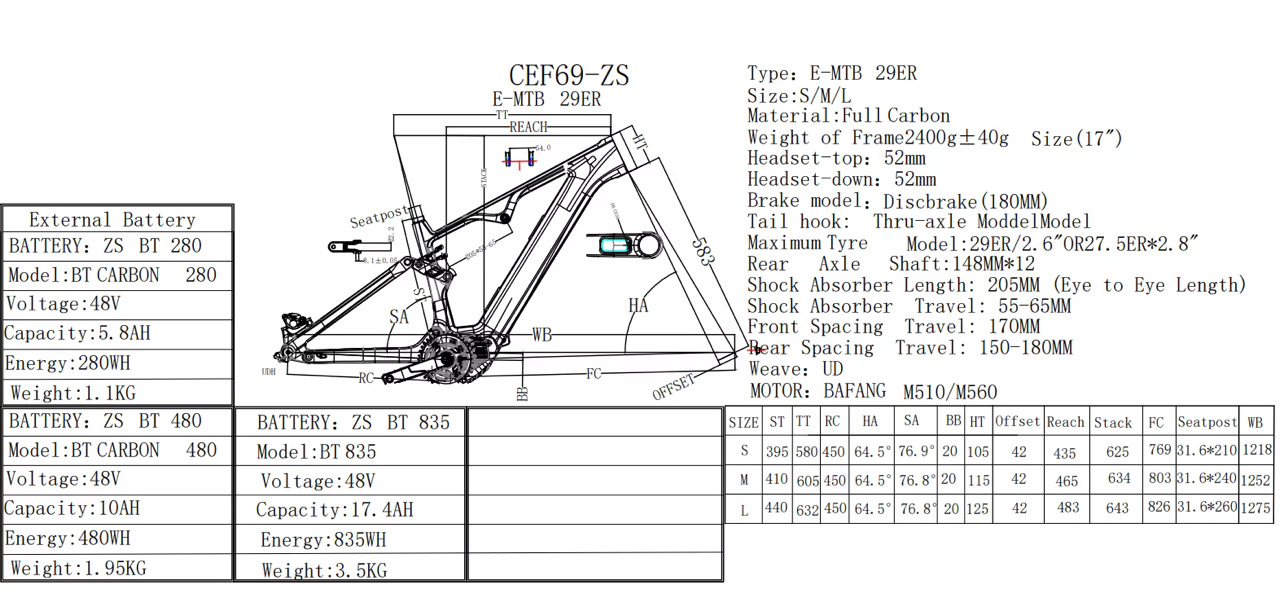

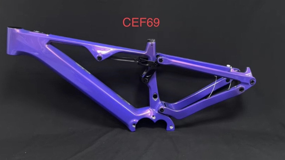

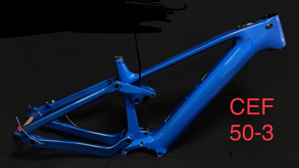

New CEF69 bafang m510 and bafang m560 and cef50 bafang m820 frames

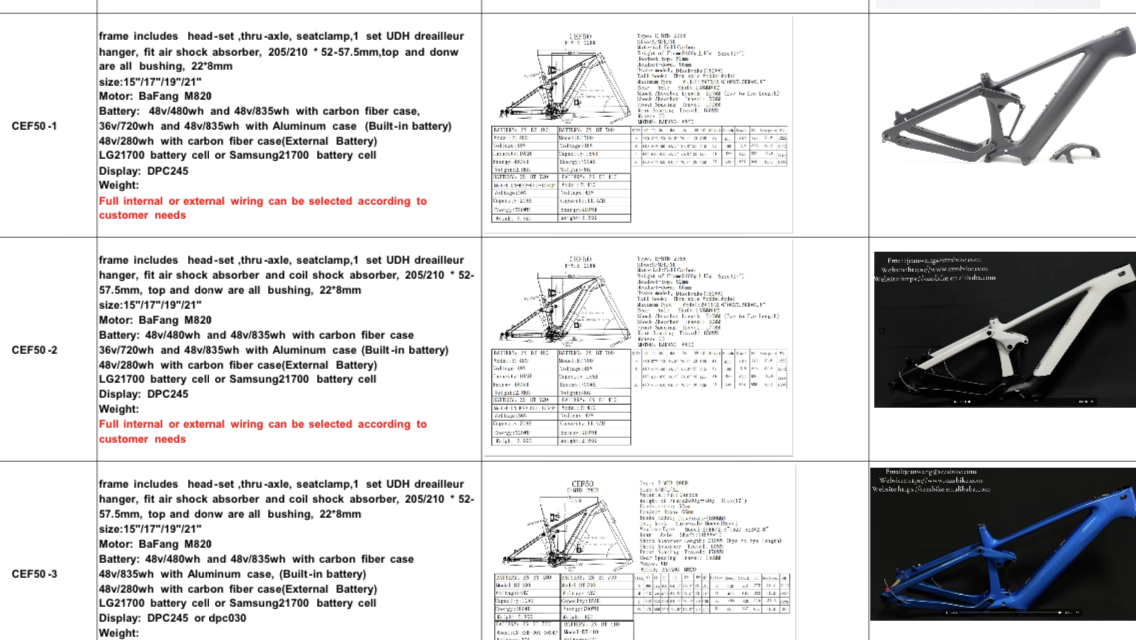

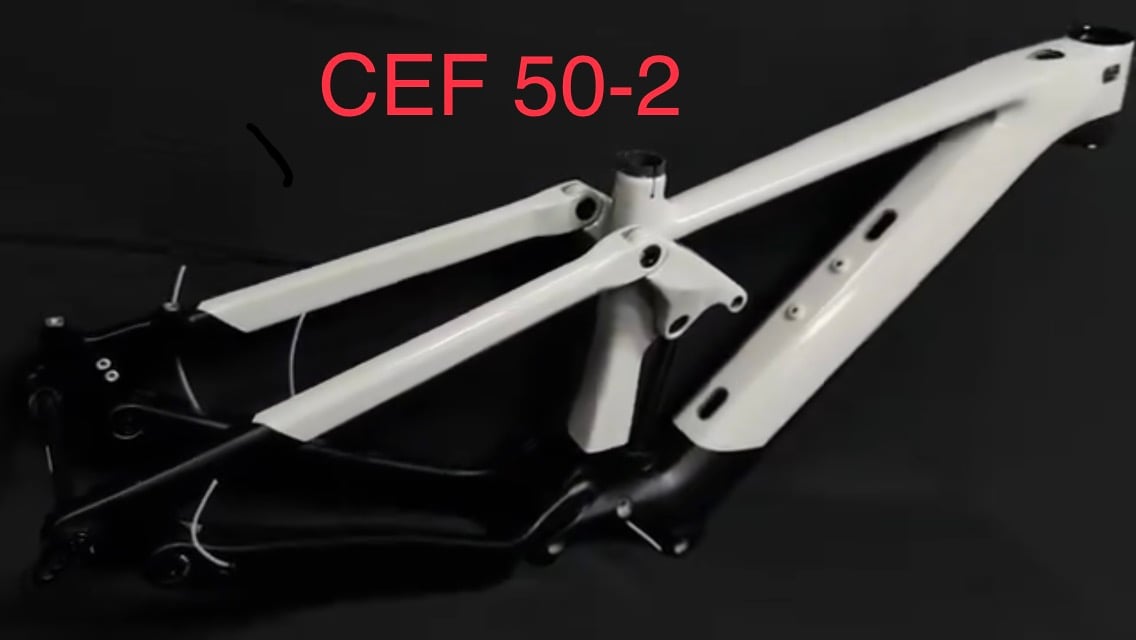

SZZ mention a Bafang M820 PRO model for their CEF50/55 Can’t find anything on it.
I am tempted to get 2 more lightweight EMTB’s to get my family along on the trails..
Could someone shed a light on the difference of those frames besides the shock position?
I’m also interested in the M820 Pro
Rumour at 4 Leaf below.
Let me know if you find where to buy one.
