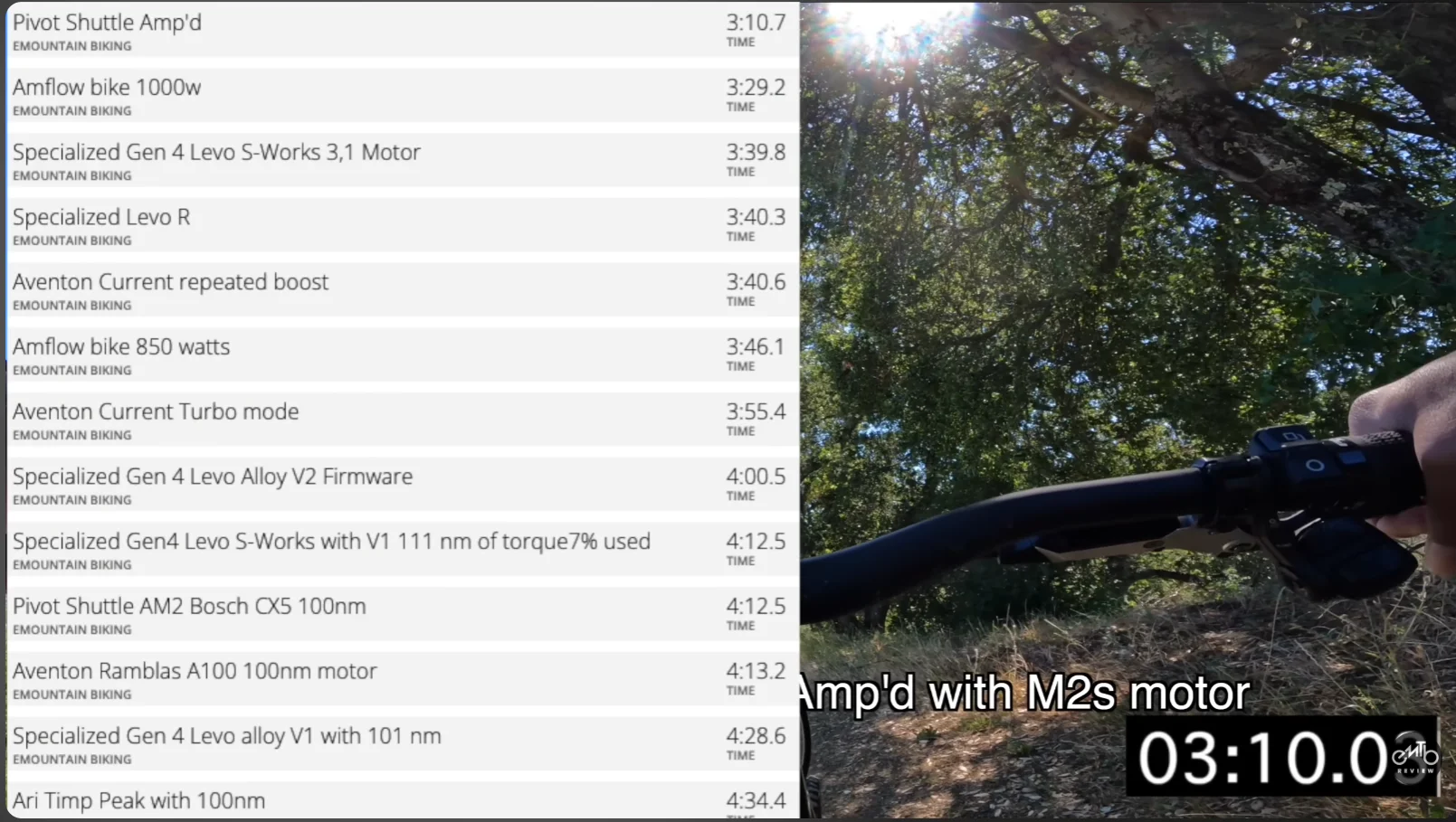

I think the theory is all well and good but it doesn' t seem to pan out like that. Coming from my Shuttle SL to a Vala I do notice a significant difference but it's not twice as quick (350 vs 750). I think the hill climbs he does on E-MTB review are interesting and, fixed rider weight, 200W input, max mode, etc. I think the original CX5 85Nm was around 4:50View attachment 183476
You can double the power of a car and it does not make it twice as fast.
Same applies to our e-bikes.
Theoretically it should be a lot more linear, air resistance is a big non-linear factor at car speeds but negligible for an emtb climbing at relatively slow speeds.
Someone smarter than me can model it properly but to compare you need to consider system power and losses e.g 350 vs 700 isn't double the power if the rider inputs 200w.
The point wasn’t really which is fastest, I wanted to understand the difference the wattage or torque makes in a real world scenario.
I didn’t know the difference either, thanks for the thread 🤙
