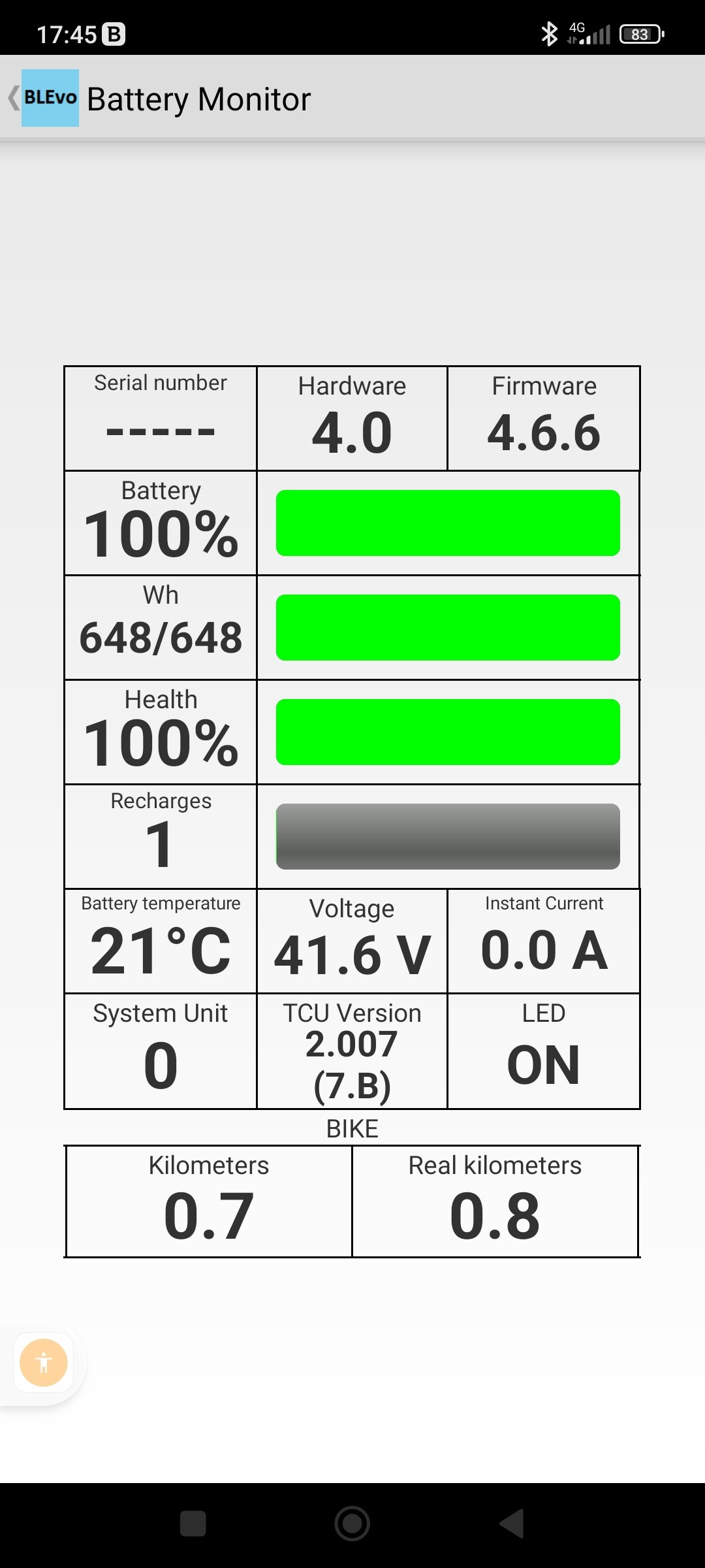

I got my new bike yesterday installed the Blevo app told me the battery is 648 watt.
I also had the same problem with my old bike when I update it the Specialized new software by the dealer did my battery was, is 50 watt less.
I know we had a tread on this before, but not a good explanation.
Does anybody have an idea.

It would be good to know what is being accomplished by the update. Limiting or reducing capacity? That would be a big deal as many would truly be losing something. What is the display, displaying?

On some battery systems if bike lights are enabled ( not necessarilly fitted) then the battery reserves 10% capacity for that facility. On those systems it is possible to remove the bike lights software option but it is a dealer access function. Since your battery capacity reading loss is 10% this may be the reason on your system??

It could also be a software protection thing to extend the life of the life of the battery. I know a few mobile phones that do the same thing. 100% isn't really 100%.

It seems strange that it's only reported on the 700w battery's and not on the 500s
Has anyone actually seen a range decrease after the firmware upgrade?
It's just as likely that it's a reporting change as much as an actual limit put on the usable wH of the battery. You'd have to back to back testing to see if it's an actual change to what Specialized are letting you have vs what they're just reporting as a capacity. It may have been you've only been allowed to use 650wH before and all we have here is a reporting change.
My eV has a 78kW battery but only 75kW usable. Possible Levo's do the same.
