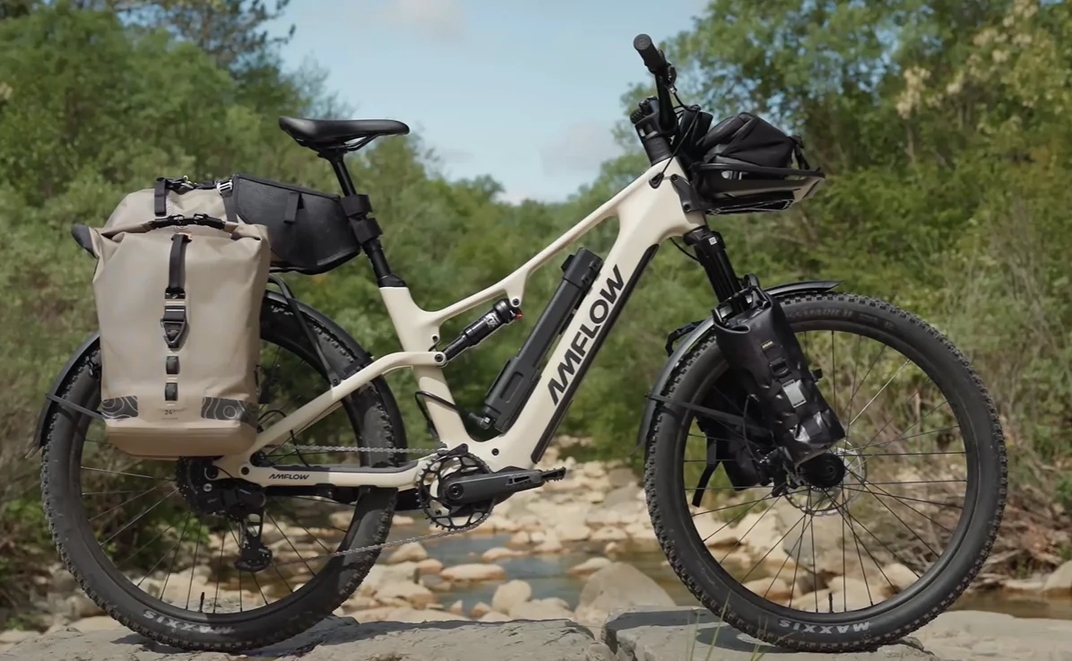

Amflow TL Details
• Intentions: Touring, Commuting or XC MTB
• 105 mm travel, 120 mm fork
• Frame material: Carbon
• Wheel size: 27.5" (stock), 29", MX, or Reverse MX
• Two sizes: S/M, M/L
• Comfort-tuned geometry
• 375 mm reach, 470 mm chainstay (S/M)
• Motor: Avinox M2 (2.65 kg)
• 125 Nm Torque, 1,100 W Peak Power
• 800 Wh or 600 Wh Removable Battery
• 480 Wh Range Extender
• Claimed weight: 22.6 kg / 49.8 lbs (M)
• Maximum load: 200 kg / 441 lbs
• Price: 3,499 EUR / 3,199 GBP
amflowbikes.com

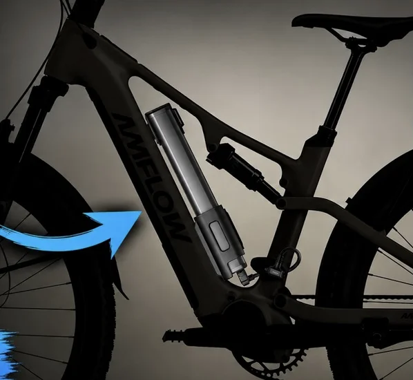

Why is Avinox always so keen to double all the numbers of the competition!?
Does a 480Wh Rex really make any sense, despite for super long rides, bikepacking or All Day Full Out Boost riding!?
Nice that they listend to the market demanding a Rex, but that thing is way too huge for most of us or?!

Indeed, a 250-300 that would fit most of the frame at around 1.5kg would be much better than this huge thing.... for the longest ride you could have one in the backpack but for most long rides that I do 800 + 250 would be ideal.
It seems 100% the same concept and design of the 600wh one (they one that you cannot buy anywhere) just 362mm instead of 434mm in length, weight should be around 2.4kg.... Not the best design and solution.
So did you all pay attention closely to the "However" part about the range extender.
However it will not work with a piggy back shock, it needs to be changed to one without a piggy back.
Interested to see if this is indeed true.

So nothing really new here same concept just a bit shorter and lighter version. Seems exactly the same crappy mounting system and cable as the RS600.
Thus I would not assume a smaller one will come as with this one (RS480) should fit all the Amflow M2/s versions so they may think that they have us covered. I really hope not but knows....
I think if they halved the length of this 480wh one and just used the lower bracket it would look a lot better and probably be fine.
It would basically have to be around 200-300 for the eMTBs. Halving the 480 in length would prob take it to 250 like the Bosch. No mountain biker is going to be lugging around a 480 weighing 6-7 lbs or whatever on mountain biking trails, at least not here. I sure would not even consider it, but for touring types, it may work well.

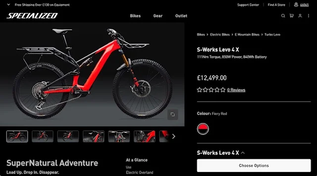

Man they are really going after specialized lmao
Amflow TL $3980
Specialized Levo X $11999
Maybe the Levo will eventually offer more than just the s works option though. The specialized is definitely decked out with way better components, but the general guy buying this kind of “overland” or commuter bike probably isn’t going to care as much. I mean you could also upgrade the amflow brakes, fork, shock and still be almost half the spesh.
Amflow TL $3980
You can fit the Levo X racks to any Levo 4, about $420, you don’t have to buy a $11999 Levo X to go bike packing.
