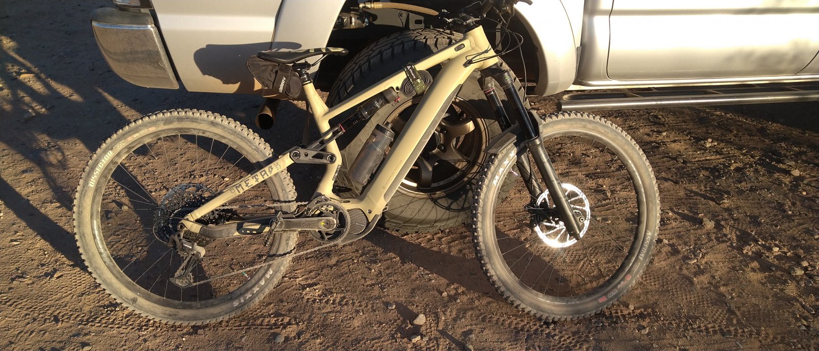

My 21 meta power sx (ride trim) was delivered this Thursday the 19th. (Guy from commencal called and said they only received a few and that many people where probably gonna be waiting till February because shimanos lack of parts right now) I put it together, set it up tubeless, greased and torque checked everything that day and left it to charge overnight. Yesterday I went for a 35 mile ride. It sure didn't seem like 35 miles though. The bike is amazing. It is my first time riding or even physically seeing an e bike so the honeymoon affect I'm sure is very real.
It's one of my favorite trails to ride and it usually takes me the better part of the morning and into or past lunch time. With the meta power I did the trail in just 2 hours and had an average speed of 17mph... I still can't believe it. It's weird, I was pretty exhausted but the bike made me push myself so hard I didn't even notice till the ride was over. This is probably a slow speed for many people but for me this is blazing fast.
I'll give a quick unorganized first impressions... Please excuse my typos as I am on mobile...
A question I'm sure a lot of people have is concerning battery range. Well after 35 miles I had used 2 out of 5 bars. But be aware that this particular trail does not have a ton of elevation change and is pretty fast and flowing. The elevation gain is around 1900 feet. However I am a fatass. I weigh over 200 pounds and I rode the bike in a way that was not very nice to battery range. I have really poor cadence and I tend to stay in really tall gears and sprint/ brute force my way up hills. I am aware that it is probably bad for the drivetrain.
Negatives about the bike... Well personally I think it is kind of ugly in person but I am definitely not used to that fat down tube yet. The shift lever to shift up is really hard to reach with your thumb. Even after adjusting it and moving it, it still feels really unintuitive (I am used to my other bike that has shimano xtr and the ergonomics are a dream). Also I am not sure how well the rear shock will perform on big jumps and really hard hits. I had aired up the shock to about 250psi with 30% sag and jumps or drops over 2 feet would cause it to blow through the travel. Turning the lockout on helped this a little bit but made the back end much stiffer over the normal portions of the trail. I will have to experiment with this further. The bars are also just a tad more narrow than I am used to. Also the weight makes it a bit of a chore to load if you don't have a platform rack.
Positives:... Speaking of the weight. Yeah it is heavy at around 52 pounds best I could weigh with two scales. But that weight in the rough stuff is actually amazing. This bike tracks more like a dirt bike than a pedal bike through rough rock gardens and other unusual obstacles. You can really just pick the worst possible path, point to it, hold on and pedal through. You feel a bit heavy in sharp turns but I think the overall stability gained is still a positive. If you have any time on dirt bikes and this is your first ebike I think you will immediately feel at home. I was blasting through rough stuff so much faster than I do on a normal bike I actually developed arm pump from holding on so tight. The fork I like much better than the shock, it is super nice, it is insanely plush and is nice and progressive as it nears the end of it's stroke. I think this bike has the base model zeb but for the price I feel like this fork is insane value. I have the highest end fox float 36 (at the time) on my other bike and the zeb holds its own and then some when compared directly in performance. It just lacks much adjustability.
The battery range seems like it may be great too but I need more testing on other trails to confirm. The bike is also super quiet. I was really worried about the dreaded motor clunk shimano and bosch equiped bikes tend to have, but the meta power had none that I could register. The motor is so quiet it rarely gets much louder than the sound of the dirt and rocks underneath the tires. The only time you really hear it is on slow steep smooth climbs and you have it on trail or boost mode. The brakes I was pleasantly surprised with. I saw tons of people trashing these breaks online, but after some bedding in they grab crazy good and have a nice progressive ramp up until they really bite so they're easy to modulate. I'd say give them a try before you go and replace them. I was also worried about the location of the power button on the side of the frame getting hit by my knee in knee pads but this definitely wasn't an issue. Even if your knee did hit it, the button has to be held for several seconds to turn the bike on and off so it seems impossible in normal use.
This is all I can think of for now, hope it may help anyone deciding on these commencal bikes. Feel free to ask any questions and I'll try to answer best I can.

Just an update. Went for a ride today, was on a tarmac section in between trails, so I was standing up sprinting in top gear in eco mode when the left crank arm fell off suddenly. It caused me to go down and run over my left leg... My ankle hurts pretty bad but I think it is just sprained.
It is strange since I went around and torqued everything on the bike and after reading about the loose crank issue from another member I put extra locktite on the pinch bolts... I did notice my cap was loose when I retorqued everything but my pinch bolts where good.
I contacted commencal and e13 is also aware of the issue and for now they're recommending torquing the pinch bolts for the crank to 16 instead of 14... I also lost my cap so I am waiting on a Replacement.
Not sure what to do at this point... Pretty bummed after dropping all that money.
Hopefully my ankle is ok enough I can ride my acoustic bike in the meantime... I assume you shouldn't ride without the crank cap on the meta?
EDIT: Swung by the local bike shop on the way home and Shimano hollowtech end caps fit the e13 cranks just fyi. Cost was $4.50, gonna home home and retorque the cranks to the higher spec.

I haven't really rode since my left crank came off. If you are unfamiliar with the issue it has become quite common according to commencal and e13. Do yourself a favor and loosen your cranks and torque the cap to 3nm then slowly being both pinch bolts up on the cranks slowly and at the same time to 16nm ... It's only a matter of time before your non drive side crank falls off if the retorque hasnt been done. Just trying to warn people since I messed up my ankle pretty good when it happened... Got a shimano cap to replace the one I lost but gonna wait for the e13 cap to arrive.
Nov 21, 2020
77
41
Tucson, AZ
First ride today since replacing the crank cap and the retorque procedure. I definitely need to get some volume reducing spacers in the fork and shock. Any moderate jump or drop it is pretty brutal the noise it makes when it bottoms out :(
I also need to lose more weight lol.
Boost mode is so powerful it is kind of stupid... but it is fun to use on the last bit of the ride and really go ham.

Sooo... My left crank came off halfway up a mountain the other day despite tightening them up beforehand. Have lost the cap off the crank so quite annoyed.
Nov 21, 2020
77
41
Tucson, AZ
Commencal and e13 both seemed to stress it was critical to do the bolts up slowly and equally starting with the bolt closest to the frame. When reaching final torque you must also go back and forth checking torque until neither bolt continues to tighten any further. If one is done up any tighter than the other, the effectivity of the crank to be clamped onto the spindle will be affected.
I still haven't rode my bike enough post retorque to be convinced that the retorque procedure is an effective solution but time will tell. I also applied torque stripe to the cranks and cap to monitor for movement.
When I lost my cap, I found out that standard shimano hollowtech caps fit btw. My bike shop had those locally until the e13 cap arrived.
